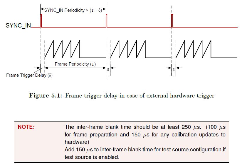

I am using AWR1243BOOST+DCA1000 to evaluate the advanced frame configuration.
If I define more than one subframe in the advanced frame configuration with hardware trigger, the data transfer is very slow.
Looks like AWR1243 ignores most of the triggers.
With software trigger, there is no problem.
I am sure I didn't enable the subframe trigger option.
Is there anything that could possibly go wrong?
