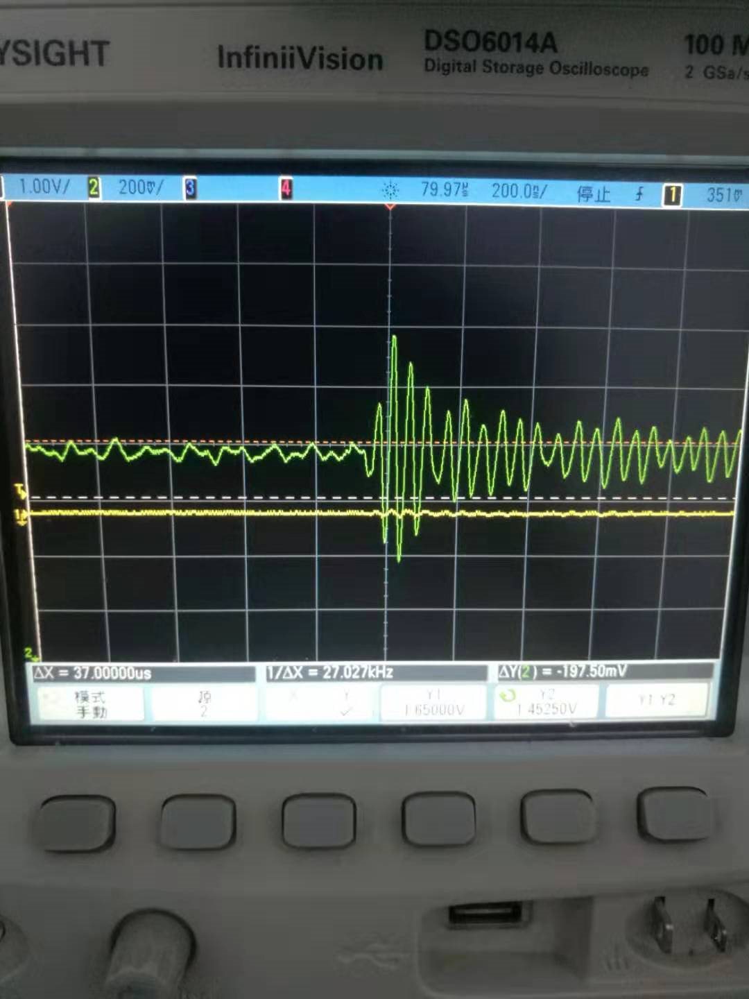

 Hi , there are some problems about the TDC10000 which bother  me for several days.
Application Scenarios: Measure 40mm Distance
The setup for TDC1000 as below:
Sensor : 1Mhz Transmit-receive ultrasonic sensor
Driver signal: 3.3Vpp  1Mhz
VCOM : Internal
Mode:  Single Echo Receive Mode
Time-of-Flight  Control: Short TOF Measurement
NUM_TX  : 5 (5us)
MASK Period: 32us
ECHO_QUAL_THLD :  -35mV
Problems: No STOP signal assert
oscillation Waveform about several hundred mV,  and  the frequency is 3Mhz,
at this time ,the STOP could be asserted.

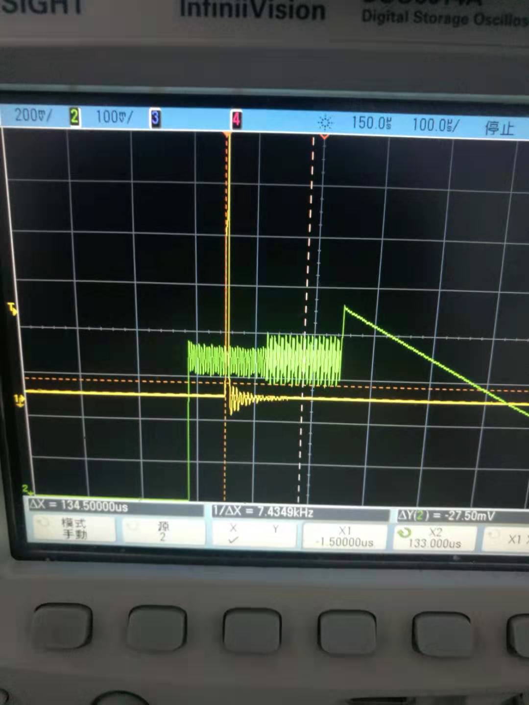

Secondly , I modified the value of the RC ,so the oscillation had been eliminated then measure the COMPIN, the waveform is shown as below:
As I think , this waveform meet the STOP generation conditions , but the STOP signal didn't appear yet !
could any body help me ?
thank you !

  • Luke,
    Please send me the actually application & schematic.
    Assuming the green signal as COMPIN (Rx) pin & the yellow the Vcom pin you should expect the STOP signal.
    Please try to increase the THLD from -35mV to a even higher value and also try to ensure that the expected number of STOP pulse is same as what we expect from this waveform.
