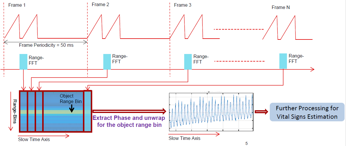

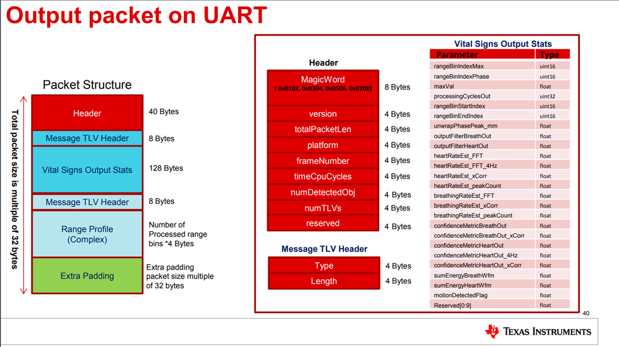

Please tell me the type and unit of 4Byte timeCpuCycle shown in the header of the figure below.
Is 1frame 50ms?
