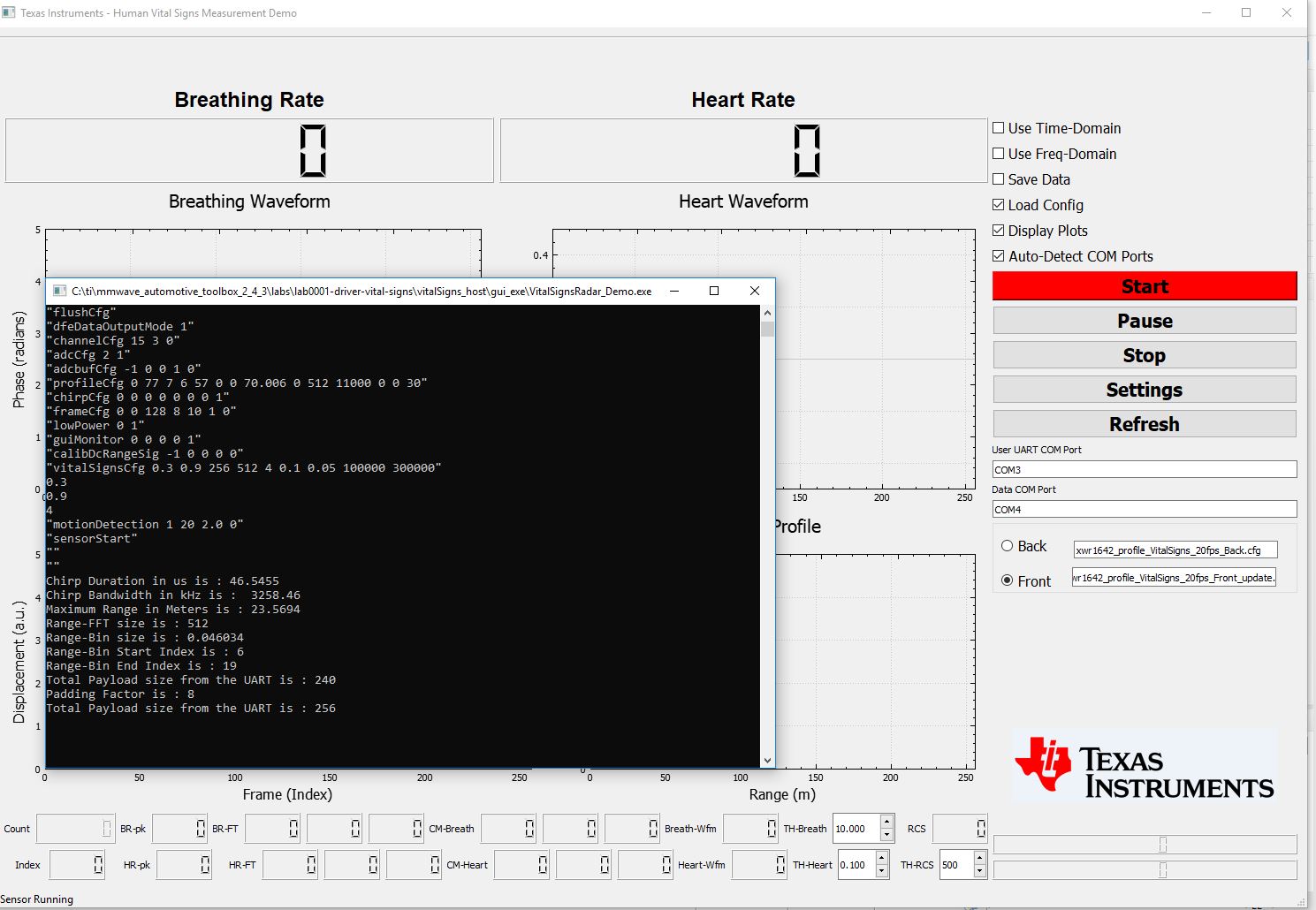

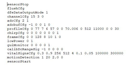

I have slightly modified the vital signs configuration from its default and I'm getting errors when I try to run it. I have successfully used this configuration in mmWave Studio (when doing a raw data capture), but for some reason it does not work with the Vital Signs Demo. I have attached screen shots of the terminal window from the GUI, the CCS console error message, the mmWave Studio configuration, and the configuration file that I am sending to the Vital Signs Demo. For the configuration file I only changed values in the "profileCfg" and "frameCfg" lines. I believe the numbers from mmWave Studio all match up to the correct field in the configuration file so I'm not sure what the error is.

    The sampling Frequency is too high.
    Can you please try 6.4MHz instead of 11MHz?
    Thank you
    Cesar

  • Josh,
    It appears that you have decreased the frame periodicity from 50 ms to 10 ms. Please keep in mind that the Vital Signs Processing chain does need enough inter frame processing time to complete the heart and breath rate calculations.
    You also have increased the number of chirps from 2 to 128. Was there a reason for increasing the number of chirps? In the Developer's Guide, it states that only the first chirp in the frame is needed for processing. Is there a reason you have so many extra chirps when this not necessary.
    Kyle
  • Hi Kyle,
    I changed these parameters to get a better duty cycle percentage. The duty cycle is 81.9% with 128 chirps and 10 ms frame periodicity vs. 0.3% with 2 chirps and 50 ms frame periodicity. The higher duty cycle was giving me better results with raw data processing (especially when I averaged FFT outputs of the 128 chirps for each frame), so I thought I'd try out these parameters on the vital signs demo. That being said, even when I change these parameters back to their original values (as well as the sampling rate) I get the same error messages as before, which makes me think there's an issue with changing the number of ADC samples from 200 to 512. I'm not sure I understand why this is an issue--is the original value of 200 ADC samples hardcoded somewhere in one of the C files? It just seems like there is very little customizability from the radar front end.
