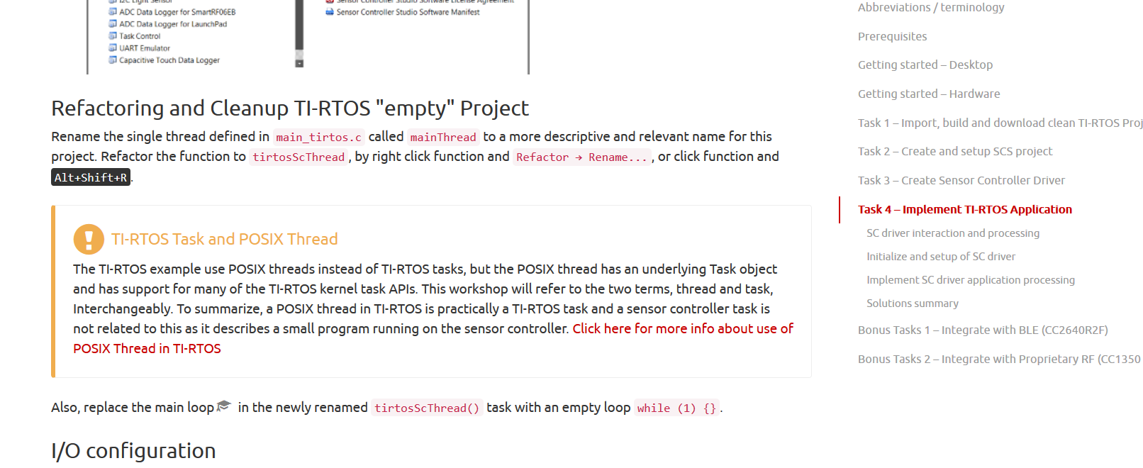

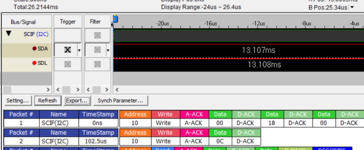

An I2C sensor is running well and looping in Sensor Controller Studio as shown below: initialization code, and task looping logic. SCS code is exported and compiles in CCS. The CCS program load triggers the same initialization logic as does the SCS initialization logic. However, I cannot start the task loop in CCS. I2C remains quiet, and no active logic is occuring with I2C. The 'sensor controller studio project from scratch' ADC task is working fine. (FYIO there is a typo in the lab manual - screen shot below)

 (there is a typo in the tutorial.... main_tirtos.c file should be 'empty.c' instead. )
  • The I2C sensor controller initializes and the sensor returns the initialization 'OK' code 0x26. The execution task will not start nor loop.

  • Unfortunately the only method to start a new CCS RTOS project for the CC1310 is to begin a hack on the empty.c sdk project, or open a new RTOS but with a different SOC. Starting with the empty.c places a posix thread in the code which is now obsolete. The empty.c project and the 'starting from scratch with sensor controller' lab was disorienting to me personally for some reason. Nomenclature for dsp/bios, sysbios, tirtos, rtos was confusing too! The tutorials and scif_how_to are great and wonderful (compared to years past) but are also fraught with inconsistent nomenclature: 'start' a task meant to me 'initialize, run and loop'. start could also mean execute. Going back to the scif_how-to like TER suggested and looking for the key nomenclature: initialization code, execution code, termination code was helpful. Then, porting all code from the empty.c file and finally deleting the empty.c file altogether and having all code reside in main_tirtos.c created a successful CCS project using the i2c sensor code fully debugged with Sensor Controller Studio.
