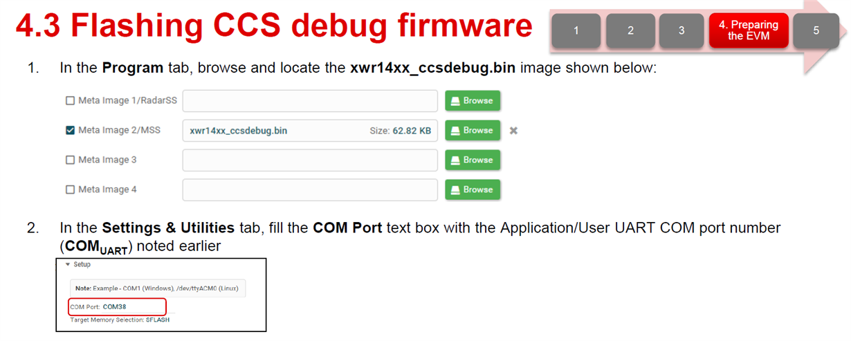

TIDEP-0091: can't find flashing CCS debug firmware file, xwr14xx_ccsdebug.bin
Part Number: TIDEP-0091
 Hi
I am trying to run  the level_sense_demo following the instruction of  TIDEP-0091 – Level Sensing Reference Design   Getting Started Guide – Software & Hardware
I have download the Level Sensing Software Package.When I flashing CCS debug firmware,I can't find the file    xwr14xx_ccsdebug.bin  ,where can i find it? thank you .
    This is part of mmWave SDK release
    Please check which SDK release version is needed.
    Then, the file will be provided in following folder
    C:\ti\mmwave_sdk_02_01_00_04\packages\ti\utils\ccsdebug
    Thank you
    cesar
