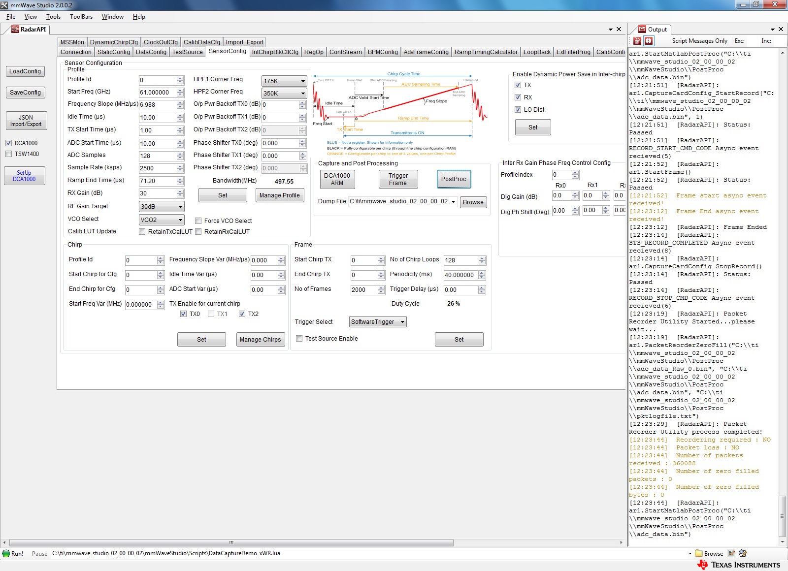

Hi:
I have a question regarding the REAL Tx power, or the Effective Radiated Power, that the IWR6843 transmits when it sweeps in the 61.0-61.5GHz band range. Please see my settings below. I know that the Tx conductor level power is +10dBm. In the following figure the "Rx Gain(dB)" has a default value of 30dB. The "RF Gain Target" also has a default value of 30dB. So I suppose that the total Tx transmit power is 40dBm (+10dBm + 30dB). Am I correct?
I'm targeting to get this 40dBm Tx power, allowed by the FCC. If my settings are not correct, could you let me know how I can get 40dBm Tx power?
Thanks.
Ziyou
  • Hi Ziyou,
    No, this is not correct. The RX gain and TX power are two different parameters.
    The TX power + TX gain  = Output power from the antenna.
    For certification  you have a power meter, receiving antenna, and the device at a distance X from the antenna.  you calculate the mean power taking into account the loss due to the distance, the RX gain of the receiving antenna, any other losses involved and gain involved. I recommend contacting a FCC test house for more details on the test and test setup.
    Charles O
    RF gain target is mentioned in the GUI is only for the Receiver chain, which has amplifier on the path.
    For the transmitter maximum power available is 10dBm only. Only you could do back-off the power but cannot increase.
    If you want to increase the power then you may have to design custom antenna with higher gain to reach 40dBm number.
    Thanks and regards,
    CHETHAN KUMAR Y.B.
