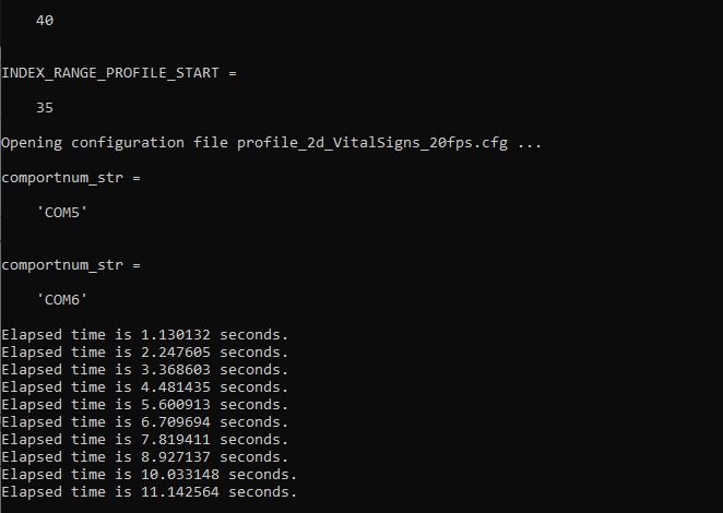

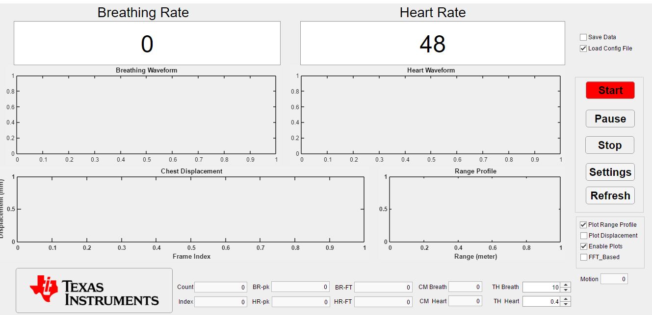

Hello again,
I was extremely excited to see that the Vital Signs Sensing lab for ES3.0 was updated! After finally being able to flash the binary files to the board for this lab, I went to run the lab and the gui pops up, however nothing happens when I click start. After looking at the quick start guide for the updated lab, the GUI the guide uses looks different, where as the one supplied with the new lab is the older one. Is there something I am missing here or was this just an oversight with the release of the lab? I have attached a screenshot of the terminal windows that shows the lab running, however no values show up in the GUI. Any help would be greatly appreciated as my group has been waiting quite a while for this lab and we are excited to see it finally work.
