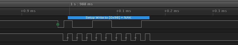

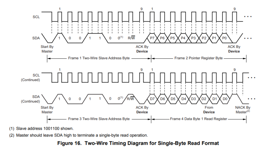

Based on datasheet, slave address of TMP451 is 4Ch.
Based on the 8bit I2C, 99h for read and 98h for write.
Customer tried this address but get NACK, what's the possible issue.
Shaq.
