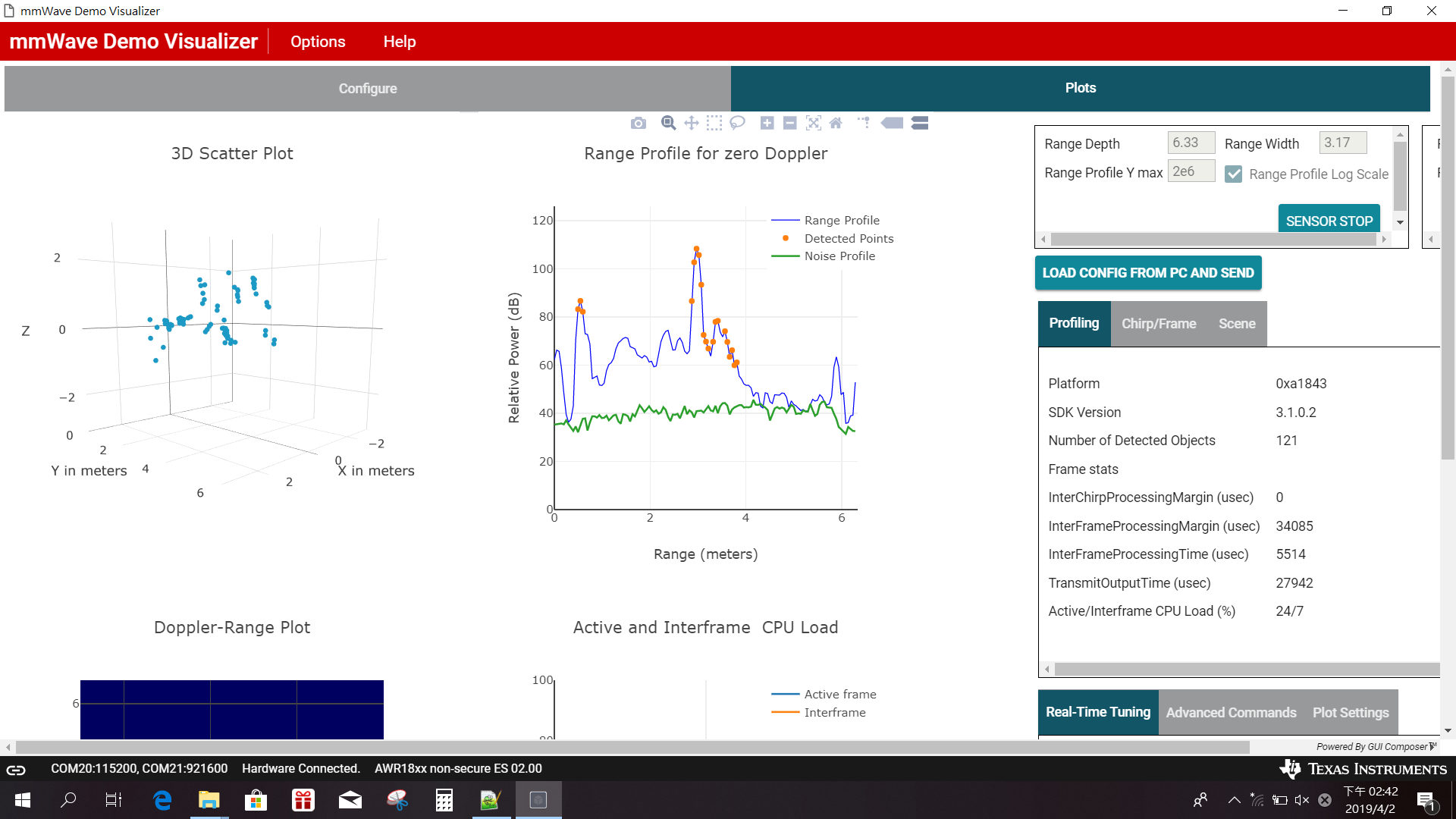

  • Hi Cesar,
    We still have a question.
    We use AWR1843-EVM when elevation is enabled. [4Rx, 3Tx (15deg + Elevation)]
    But why the number of detected object can be more than 64. (Maximum number of objects in aoaprochwa.h)
    JuiYang
    This is a good question.
    Let me look into it
    Just give me a few days
    thank you
    Cesar
    I checked with the development team.
    They mentioned that in SDK 3.1 demo they implemented some "chunking" During a frame, 64 objects are detected, however the display buffer is a circular buffer that keeps a history of last 256 objects detected. This is the reason why the Visualizer shows Number of detected objects larger than 64.
