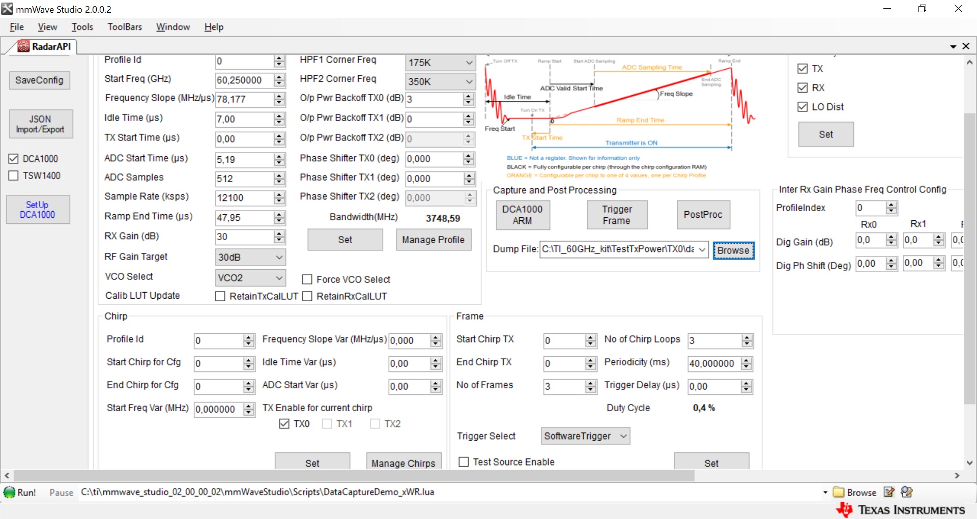

Dear experts,

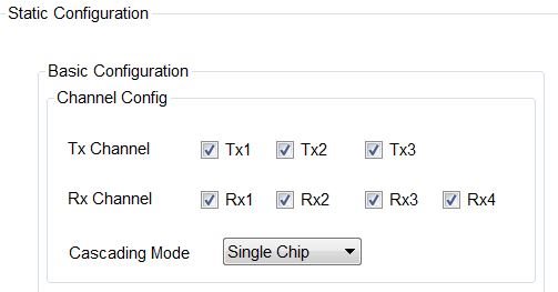

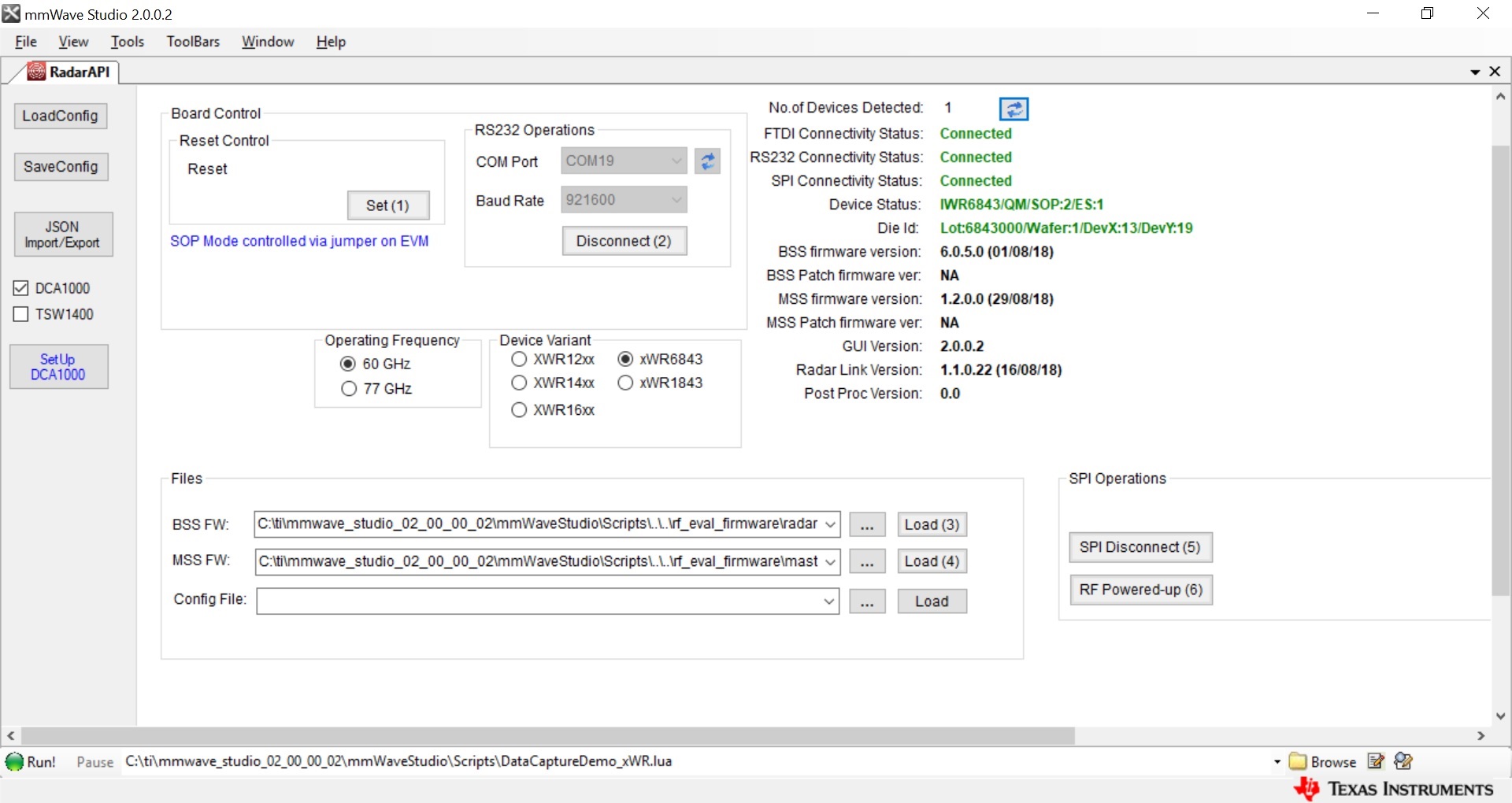

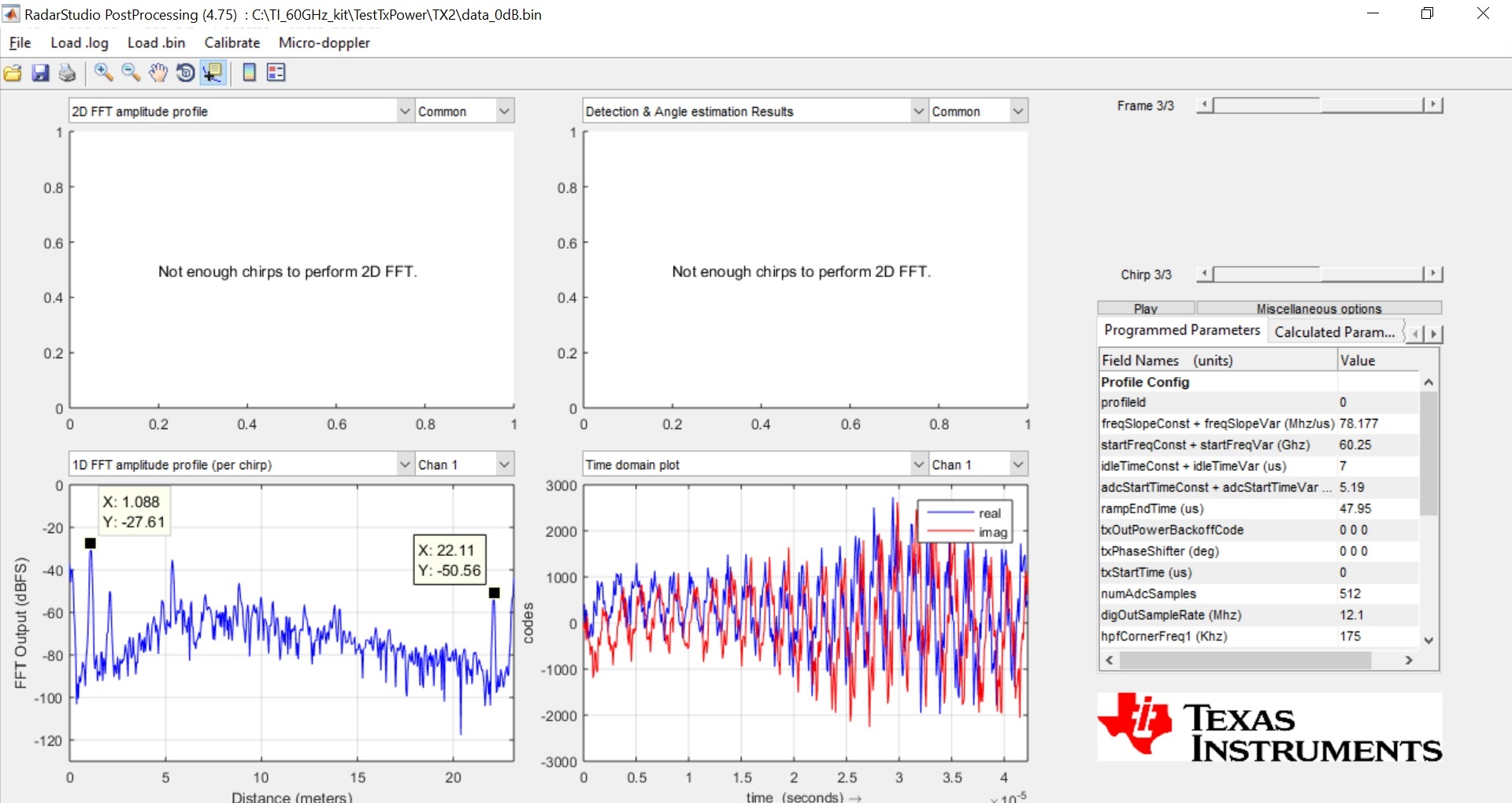

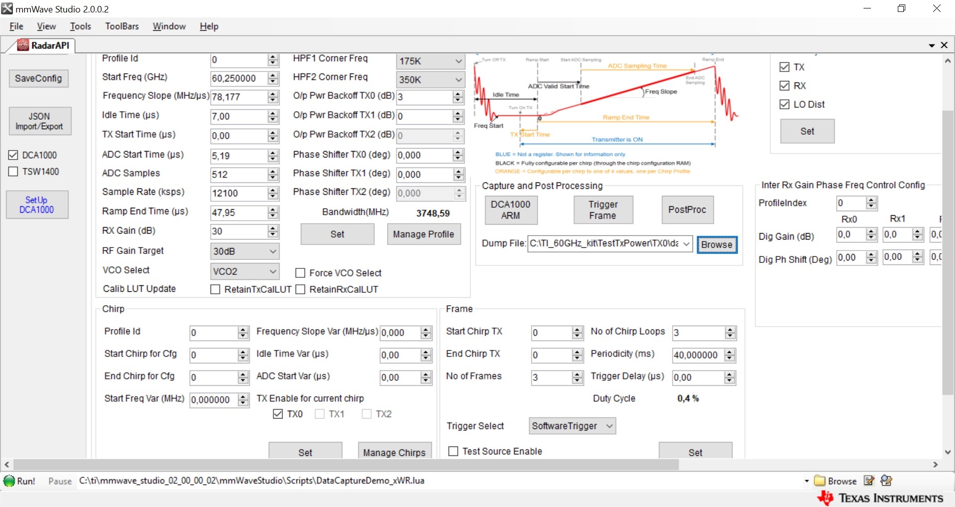

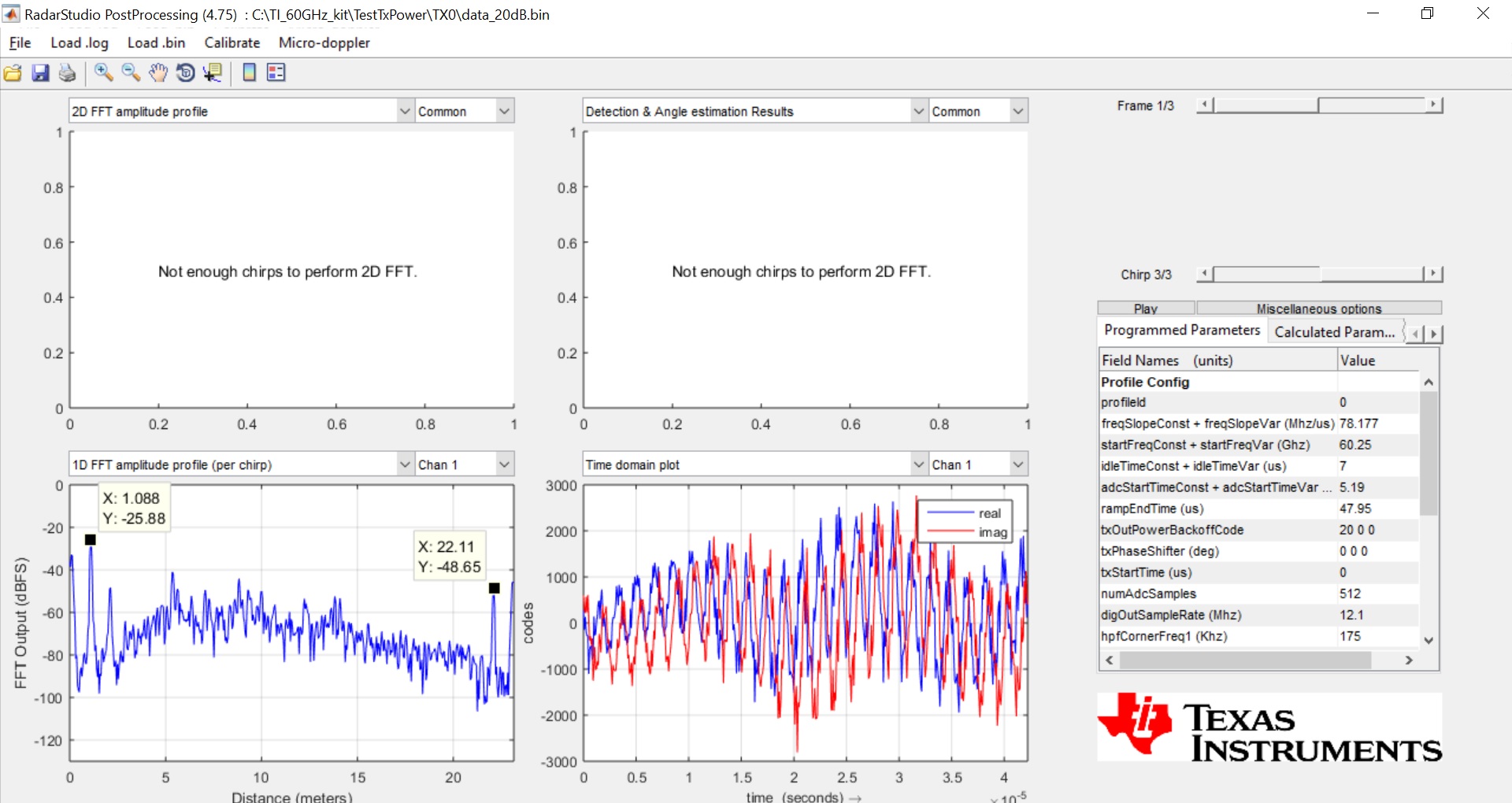

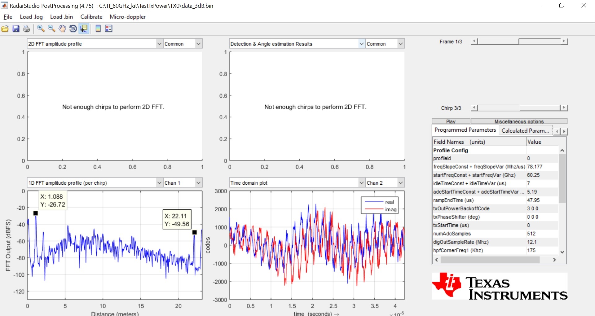

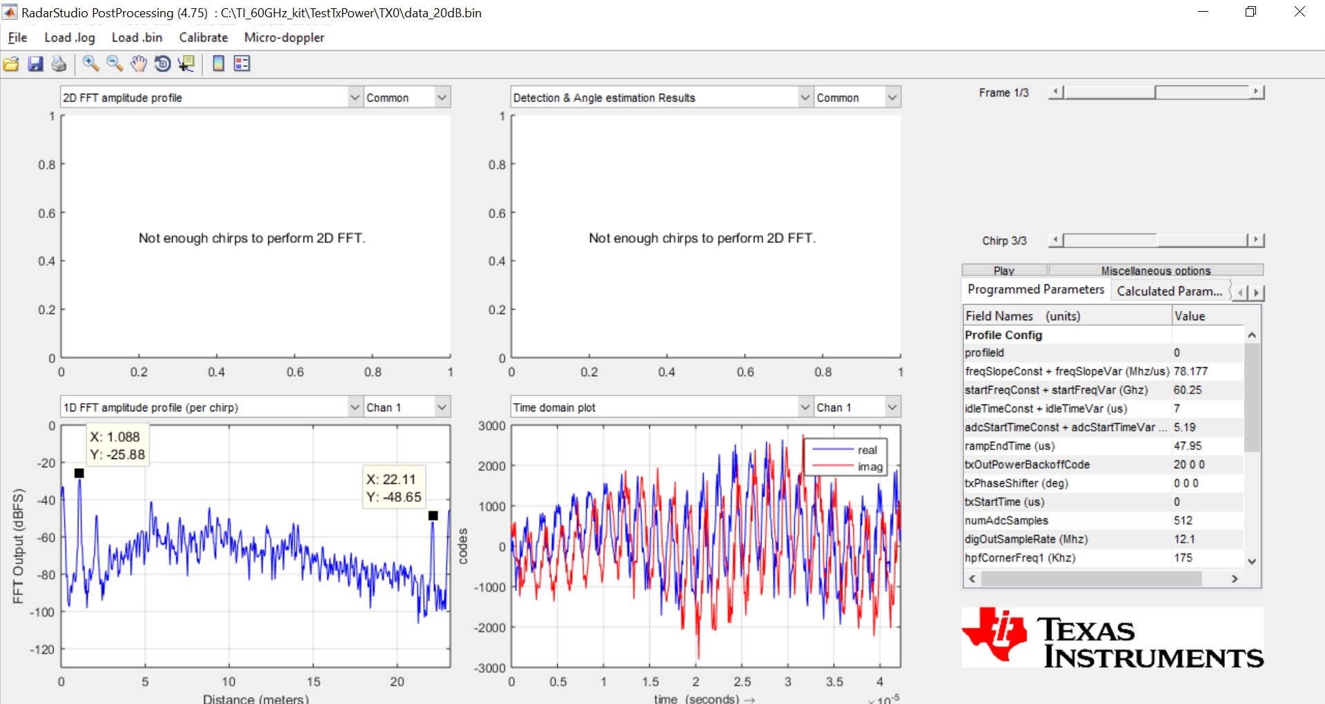

I found a problem with changing TX power in mmWave Studio. Having configured my setup for 1TX / 4RX I tried various attenuation (Pwr Backoff) with steps of 10 dB and 3 dB, and the received signal power from a corner reflector remained always nearly the same. This holds for TX0 and TX1.

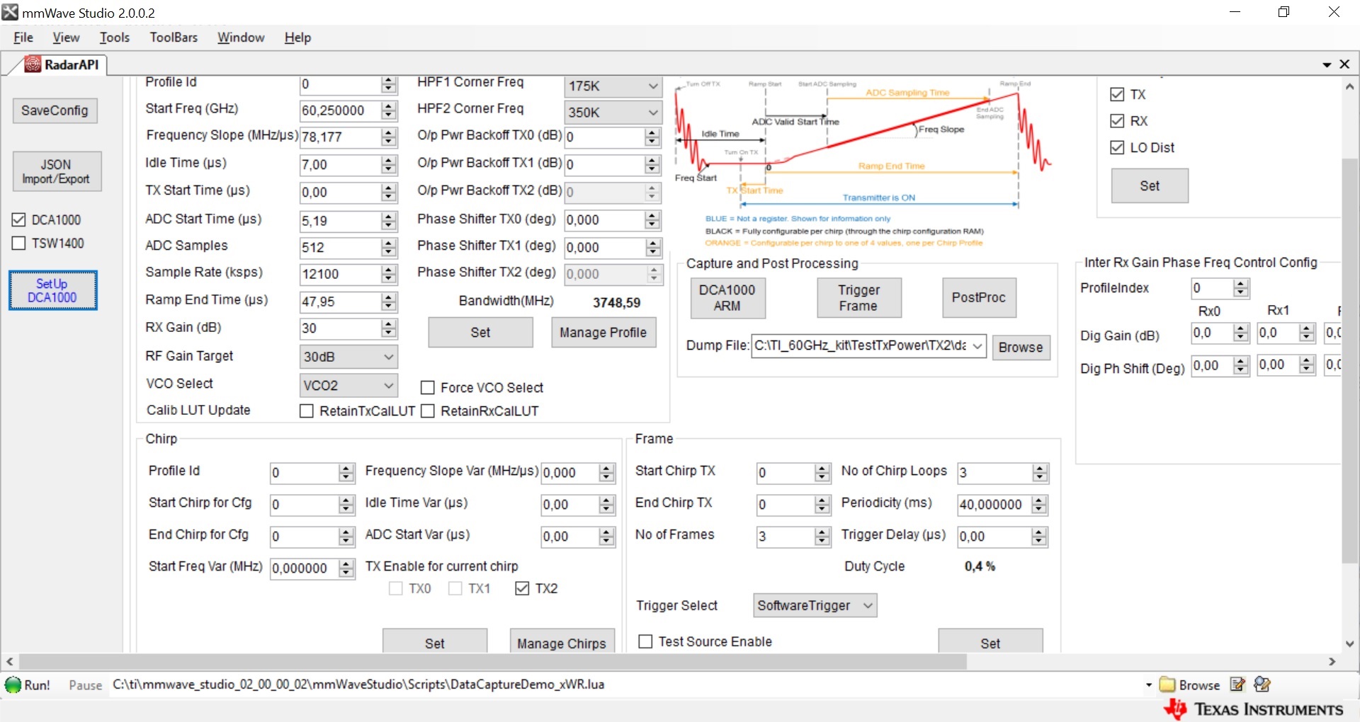

For TX2, Pwr Backoff is always locked at 0 dB. Is this a bug?
What is the actual transmitted power then?
Please see screenshots with my configuration and measured signals below.
Thanks.
Timofey

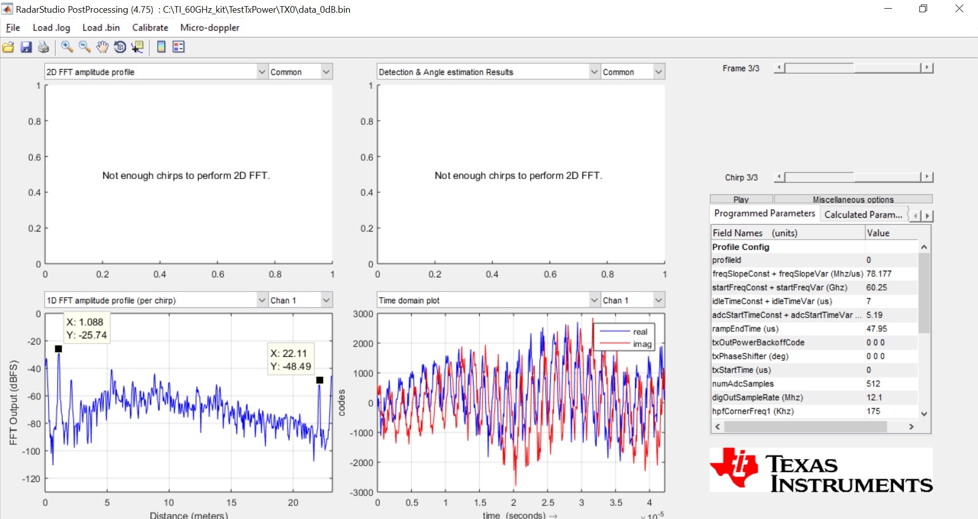

TX0 power backoff 0 dB:
TX0 power backoff 3 dB:

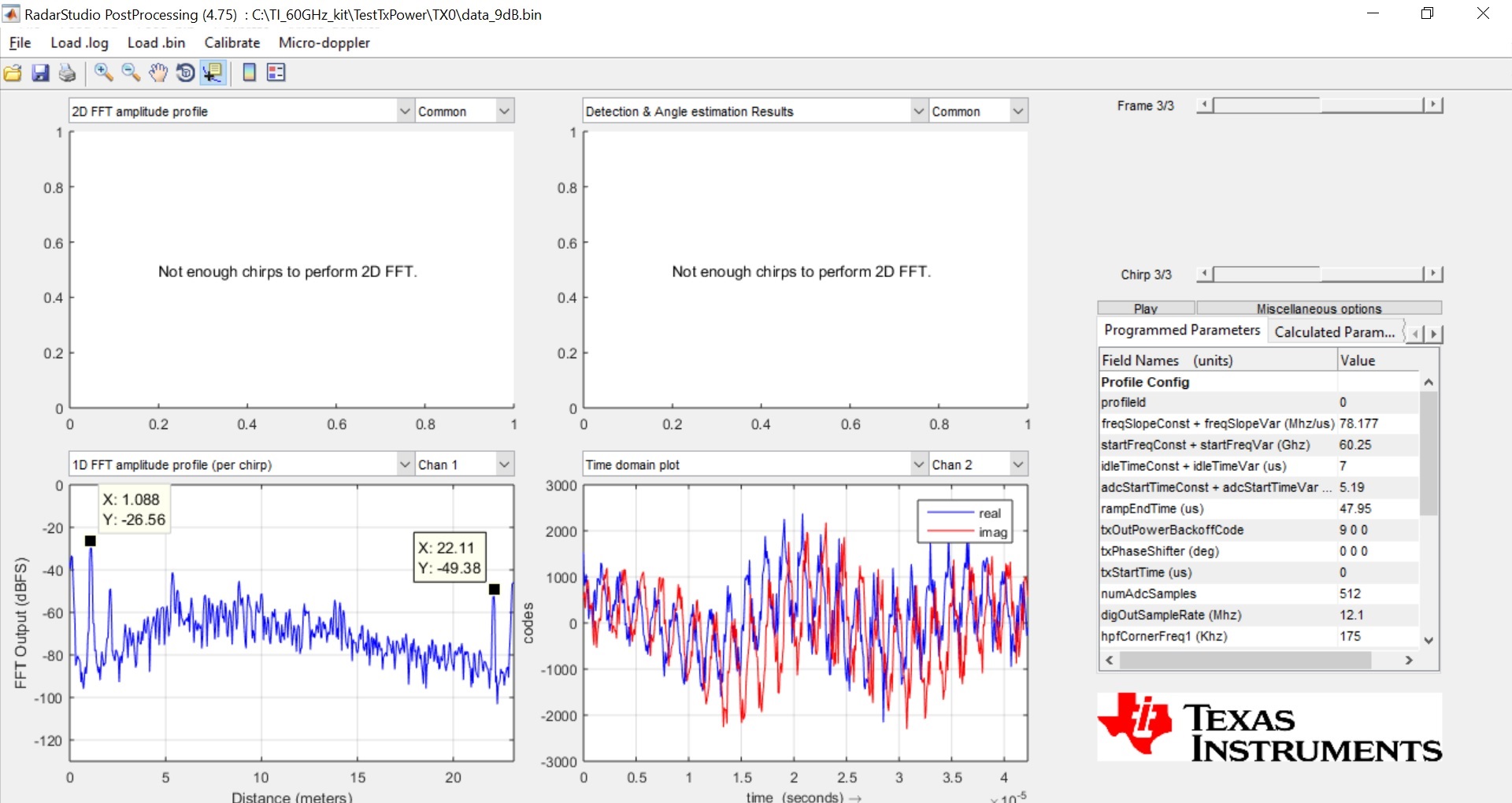

TX0 power backoff 9 dB:
Tx0 power backoff 20 dB:

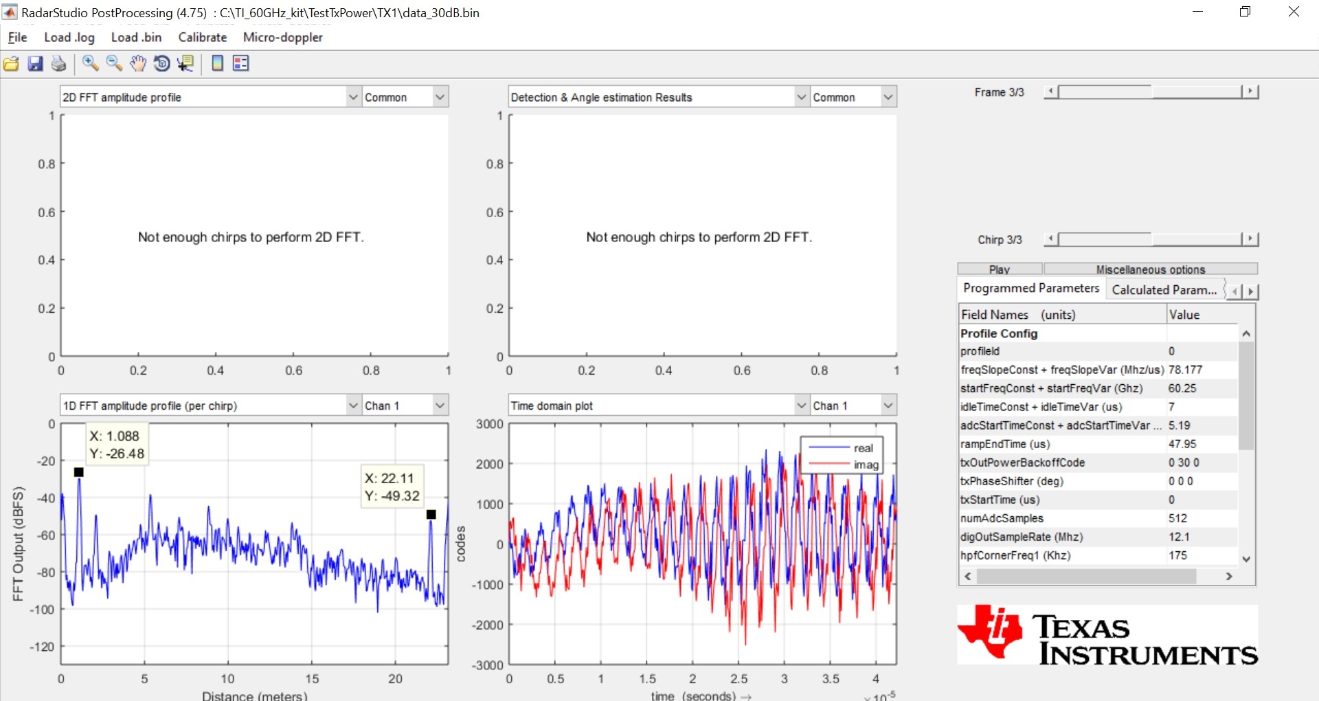

TX1 power backoff 30 dB:
