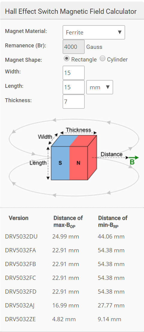

Can you please direct me to the Magnetic field calculator on TI website?
Thank you.
  • Hello Abel,
    Thank you for using the TI forum.  The magnetic field calculator for the DRV5032 is on the main product page (http://www.ti.com/product/DRV5032). It is on the right hand side, and you may have to scroll down a little bit. It looks like this:
    If this answered your question, please click the green "This resolved my issue" button. Thanks!
  • Thank you for the response, I was looking for the magnetic field density output and solving for a specific distance?

  • Hello Abel,
    I see what you are saying now. That feature is temporarily not on the DRV5032 page, but it is currently available on the DRV5055 product page (http://www.ti.com/product/DRV5055)

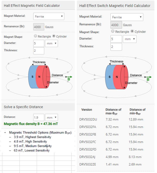

  • Hello Mitch,
    Follow up design question...
    We have two parallel disk (one fixed and another rotating)
    We are trying to measure the angular position of the rotating disk relative to the fixed disk.
    We want to use the DRV5032AJ sensor and here is the parameters.
    I assume we have enough magnetic flux density for the sensor to work optimally?
    Thanks for the help!

  • Hello Abel,
    Yes, the AJ version operates at a maximum threshold of 9.5mT, and it looks like in your system there will be ≈47mT, which is more than enough to trip the sensor.

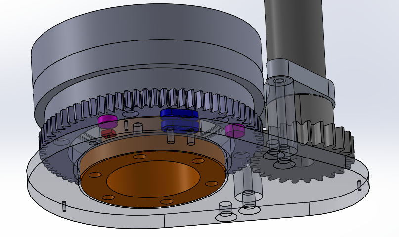

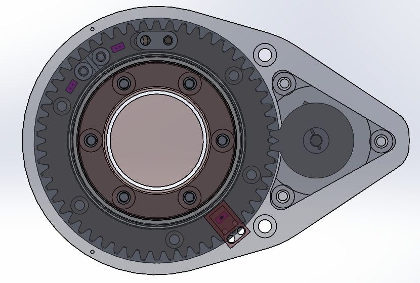

  • Hello Mitch,
    Here are some details...
    Our configuration is as follows...
    We are trying to detect the angular position of the gear in three specific positions below.
    1. Left of the blue position (-170deg)
    2. Right of the blue position (+170 deg)
    3. Diametrically opposite to the blue position on the disk. That is at 0 deg.
    The magnet (pink) mounted on the gear made from steel and the sensor (red) mounted on the base plate made from aluminium.
    We have a hard stop (blue) we can use as needed to calibrate the sensor from a known position.
    The accuracy we are looking for is 0.2deg. This spec is negotiable after exploring what we can do with this approach.
    We have room to put multiple sensors as needed.
    Feel free to call me at 408-460 1771 to clarify anything that may not be clear.
    Thank you for the help.

  • Hello Abel,
    Thank you for sending that information. Here are my answers to your questions:
    Abel Girma said:
    Do you anticipate any issue/interference from the metal to the magnetic flux.
    Although the steel will affect the magnetic field, it looks like it the sensor should still work fine in this situation.
    Abel Girma said:
    Also how do we install the sensor on the metal and wire it?
    If you are using a surface mount device (which it looks like you are), then you will need to find a way to get a PCB mounted to your aluminum plate with the sensors in the desired positions.  Technically if you used a different sensor that comes in the TO-92 package, then you could put the PCB next to the system and bend the sensor into place, but the sensor you want does not come in that package.

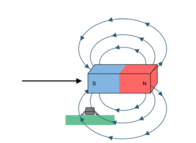

    1) With unipolar switches:
    Using the switch method, you can use a unipolar switch and turn the magnet sideways (or use a diametric magnet) as in this image:
    This will increase your positional switching accuracy as the magnet moves over the sensor (smaller magnet thickness = better positional accuracy).  The reason for this is that when the magnet is directly over the sensor, the magnetic field is very close to zero (and the wrong magnetic field as the magnet approached the sensor).  As the magnet starts to move past the midpoint, the magnetic field seen at the sensor increases until the edge of the magnet is directly over the sensor (as in the image above), which is where the field is strongest.  As long as the strength of the magnet is strong enough to trip the sensor, then the sensor will be tripped somewhere in between when the center of the magnet and the edge of the magnet pass over the sensor. This means that the sorter the magnet, the tighter the positional tolerance.
    It is important to note that this method works best when the magnet is only moving in one direction relative to the sensor.  If the magnet is going to be moving in both directions, the you could potentially use a sensor like the DRV5032FD or DRV5032DU (X2SON package), which are unipolar switches that have a separate output for north and south magnetic fields.  This way you could use one output when the magnet is moving in one direction and the other output when the magnet is moving in the other direction.
    Technically, right when the exact center of the magnet is over the sensor, both outputs will be off (the width of this region depends on the magnet).  This could let you know when you have reached the exact center, only you would need to add an additional sensor so that you can tell the difference between the magnet being exactly in the middle, and the magnet being completely absent.

  • Hello Mitch,
    You have been very helpful.
    I am now considering to see if  DRV5032FD or DRV5032DU (X2SON package) will work for us.
    We have 3 magnets (one at each location of interest). The sensor is now at 0 deg.
    From what you are saying, we can place a second one at  +170deg?
    Please note that we are rotating on both direction and would like to differentiate weather we are at +170deg or -170deg
    Here is the layout...
    Does it sound right?
    I would think we want to put one of the sensor at a location where the hard stop is so that we can use it for calibration?
