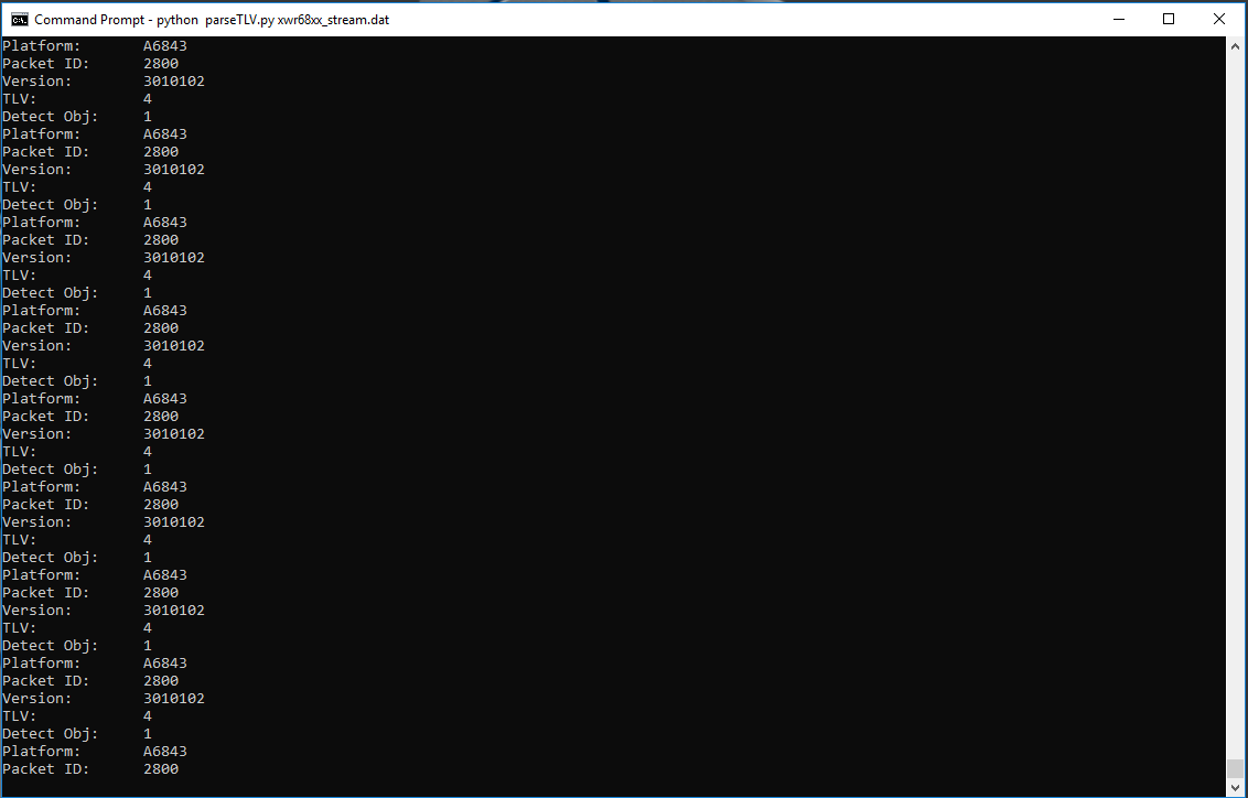

IWR6843: Issues when running the ParseTLV code
Part Number: IWR6843
I was using the unofficial parse python code that was provided in a different thread, but it isn't working for me, the code keeps running in a loop ( as shown in the screenshot below- same numbers keep repeating) and never produce a converted file whatsoever. I've attached the code I used, I'd appreciate any kind of help. Thanks

  • Former Member
    0 Former Member
    This is an unofficial parser. Depending on what file you are trying to parse it may not be compatible. If you are using the OOB demo from the latest SDK it is likely that this is out of date and you will need update it to match the output stream of the demo version you are using.
    Amanda
  • Hi Amanda,
    I'm using the mmWave Demo Visualizer and the SDK 3.01
    When you say " If you are using the OOB demo from the latest SDK it is likely that this is out of date and you will need update it" are you referring to the praser or the SDK version I'm using?
  • Former Member
    0 Former Member in reply to Yaser Almadani
    Update the parser to match the output stream of the demo.
