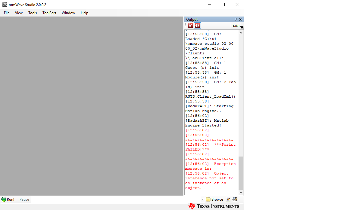

mmWave Studio 2.0.0.2 startup error
Other Parts Discussed in Thread: AWR1642
I am trying to execute mmWaveStudio.exe (ver- 2.0.0.2) but i get the following error
As per the suggestions in the parent post this could be because of compatible installer (in.mathworks.com/.../MCR_R2015aSP1_win32_installer.exe).
I reinstalled the installer but the error still persists. Any suggestions?

    In the parent post the error was not the same. It was related to Matlab startup.
    The error that you see is not related to Matlab startup, since we can see the Message "Matlab Engine Started".
    It is related to the script you are running.
    What is the script you intend to run?
    Thank you
    Cesar
  • I downloaded the "mmwave_studio_02_00_00_02_win32" and "mmwave_sdk_03_01_01_02-Windows-x86-Install" as per instructions. I did do a reset of the AWR1642, and it worked for me.
