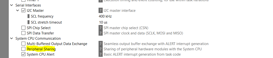

  • Hi Patrick,
    Have you done the Sensor Controller SimpleLink Academy Labs? It is explained in the Sensor Controller Fundamentals lab.
    To put it short, your Sensor Controller task must itself schedule the next task iteration with either RTC scheduling or Event Trigger scheduling. Judging by the code snippet you provided you are using RTC scheduling. That means the Execution Code in your SC Task must call fwScheduleTask() after each iteration, and in your TI-RTOS application you call scifStartTasksNbl() once after the RTC has been configured.
  • Severin,
    yes, I've done the labs but must have missed where it is explained in the Sensor Controller Fundamentals lab.
    Is fwSchedulTask() placed as the first line of code or the last line of the initialization and execution SCS code? At the moment, fwScheduleTask() is placed as the first line of code.
    thanks!
    Patrick
  • fwScheduleTask(N) schedules a single execution of the Execution Code N RTC ticks in the future. Hence, if you call fwScheduleTask(N) in Initialization Code, then Execution Code will execute N RTC ticks in the future. If you keep calling fwScheduleTask(N) in the Execution Code, then the running Execution Code will keep schedule itself and hence run continuously.
    Edit:
    Also, it does not matter if fwScheduleTask() is called first or last in Initialization Code or Execution Code. fwScheduleTask() takes effect after the running code finishes.
  • Severin
    Thank you. The sensor controller is now looping and the i2c logic is perfect.
    The problem as you suspected was the SCS code; the solution was to transfer the task code from the execution code block to an event handler and place a fwScheduleTask(1) as the single line for the execution code.However I'm not convinced the fwScheduleTask(1) isn't really looping the sensor controller task. It's almost like there are two different semaphores for one task, and it's actually TIMER1 blocking the sensor task?
    It appears to me the RTC is no longer needed since TIMER1 is now triggering the nested event handler code. If so, would you mind clarifying why the event handler code option is nested within the execution code? Is this a method used to mimic semephores and tasks in RTOS but within the low power sensor controller?
    The SCS initialization code initializes the i2c sensor, and does not contain the fwScheduleTask() as it has been commented out for now. The initialization readies the i2c sensor for register reading. I'll debug without the RTC-Based Execution Scheduling next because it seems to be redundant. Is this correct?

  • Could you please share your Sensor Controller Studio project here?
    If you are using Event Handler Code, then you are not using RTC scheduling. Hence, you don't need fwScheduleTask().

  • DEBUG COMMENTS:
    Severin,
    What does the AUX Timer 1 error mean from the screenshot below? I was just cautiously poking around and noticed the AUX TIMER warning pop up when I had the timer 1 event trigger already set and tried to add the TIMER 1. I've not had a chance to read into it, but thought it might be a clue into why the Sensor Controller won't iterate.
    The Real Time Clock RTC has been removed from the Sensor Controller Studio SCS setup, since I am trying to use the entirely autonomous function of the Sensor Controller (SC) of the microcontroller (uC). The Code Composer Studio (CCS) compiles and flashes the uC, and the initialization code from SCS export is logically correct during flash. Of course 2 logic bursts occur on the board (now using a launchpad CC1310 to make certain this dodgy bug is not hardware). The logic bursts are 1. board reset and 2. initialization code from SCS. So, it appears that the autonomous function of the evhSetupTimer1Trigger(0,120,2) will not start and iterate for some reason. To be clear, I want to use the event trigger of the Sensor Controller uC only, not the RTC of the main uC.
    The SCS task is running fine, as mentioned previously the initialization code and the event handler code is logically perfect, as is the termination code. The SCS task iterates using
    // Read the result after ~100 milliseconds + a 20% margin
    evhSetupTimer1Trigger(0, 120, 2);
    // Schedule the next execution
    //fwScheduleTask(1);
    Severin Suveren said:

    Summary of findings:
    (from the datasheet) 6.4 Sensor Controller
    The Sensor Controller contains circuitry that can be selectively enabled in standby mode. The peripherals in this domain may be controlled by the Sensor Controller Engine, which is a proprietary power-optimized CPU. This CPU can read and monitor sensors or perform other tasks autonomously; thereby significantly reducing power consumption and offloading the main CM3 CPU.
    Findings:
    1. The Sensor Controller Engine timer does not seem to activate scif Execution Code
    2. The Sensor Controller Engine timer must be activated inside the Initialization Code , which will queue the Event Handler Code
    3. The Sensor Controller Engine timer is a one-shot trigger.
    4. To run the Sensor Controller Engine autonomously , a two step loop must be as follows: evhSetupTimer1Trigger(#evIndex, mant, #exp) is called by Initialization Code, and will queue Event Handler Code, evhSetupTimer1Trigger(#evIndex, mant, #exp) must then be called again by Event Handler Code otherwise the Sensor Controller Engine timer cannot be reactivated if the application leaves main() for BIOS_start();    /* Does not return */.
    5. //scifOsalInit(); //scifOsalRegisterCtrlReadyCallback(scCtrlReadyCallback); //scifOsalRegisterTaskAlertCallback(scTaskAlertCallback); is not required
    Patrick
