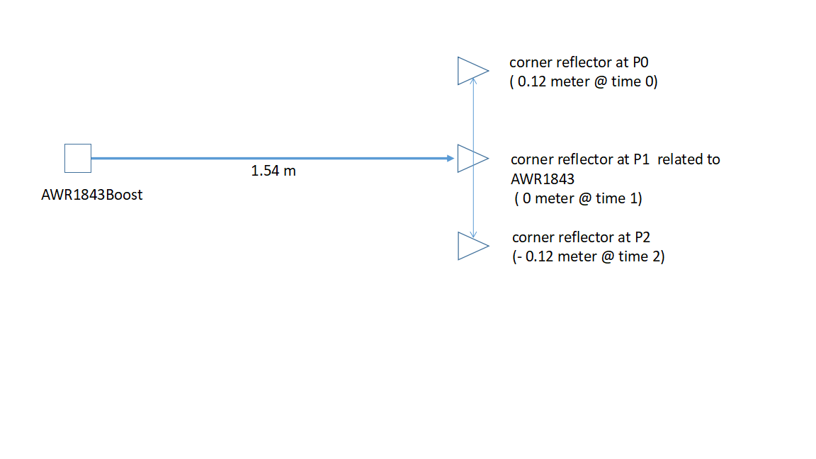

      In mmwave_sdk_03_01_01_02 Demo. I want to use 2T4R mode, One Tx is for Azimuth and the other is for Elevation, I set
channelCfg 15 3 0
chirpCfg 0 0 0 0 0 0 0 1
chirpCfg 1 1 0 0 0 0 0 2

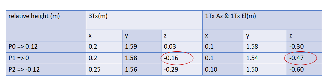

     But in this mode, the plots in mmwave Demo Visualizer are not correctness when I use triangular trihedral.

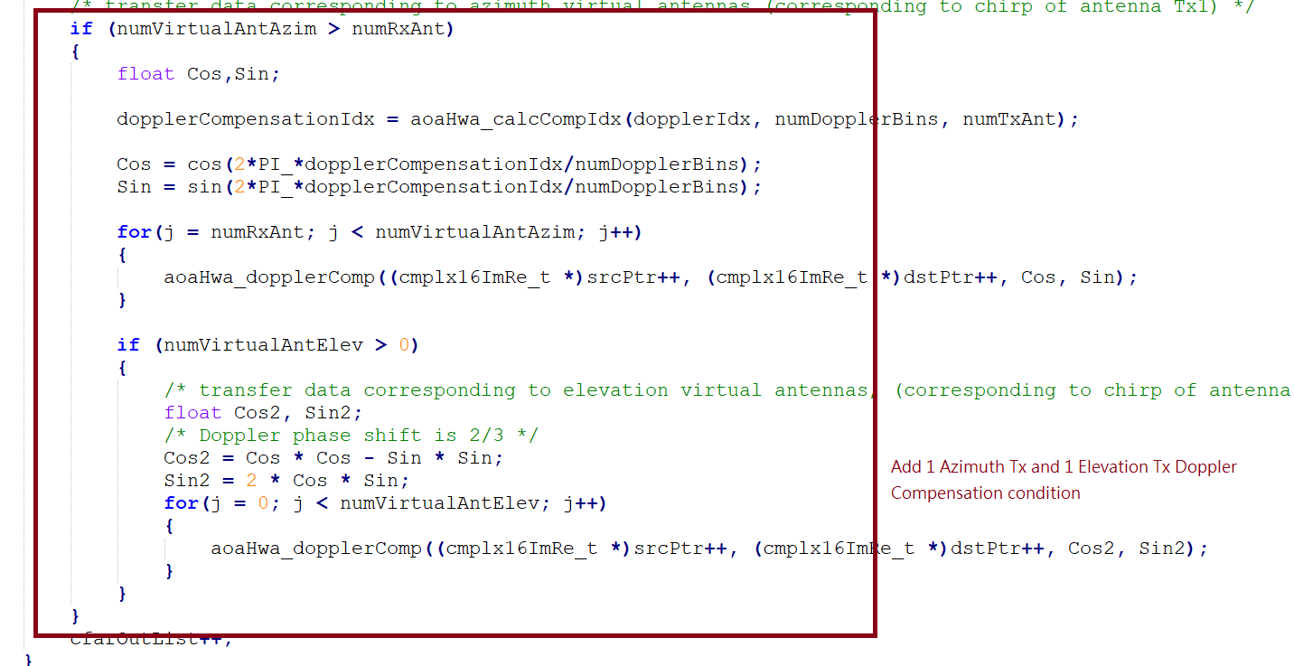

     I checked mmwave_sdk_03_01_01_02\packages\ti\datapath\dpu\rangeproc, which data format this setting is
RX channel data (1 or 2 Tx Antenna) or RX channel data (3 Tx Antenna) ?
     If I still want to use this mode, Do I have to modify the AoA of dpc in ti\datapath\dpc\objectdetection\objdethwa\objectdetection.c
or all of the datapath?
