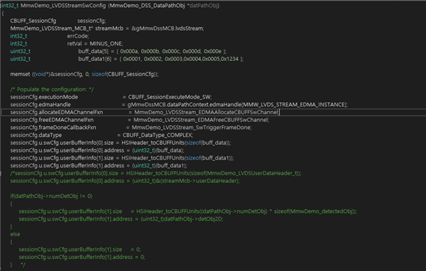

Hi, I am trying to send user pre-defined data from AWR1642 to DCA1000evm through lvds and from DCA1000 EVM to PC.
I refereed https://e2e.ti.com/support/sensors/f/1023/p/758435/2803488 to modify dss_lvds_stream.c like below to test whether the data is send correctly
I added two user data defined in that LVDSStreamSwConfig function (buff_data,buff_data1)
After building new demo bin file with this dss_lvds_stream.c, I ran the Radar AWR1642 with CLI command mentioned below lvdsStreamCfg -1 1 0 1 to send user data to lvds

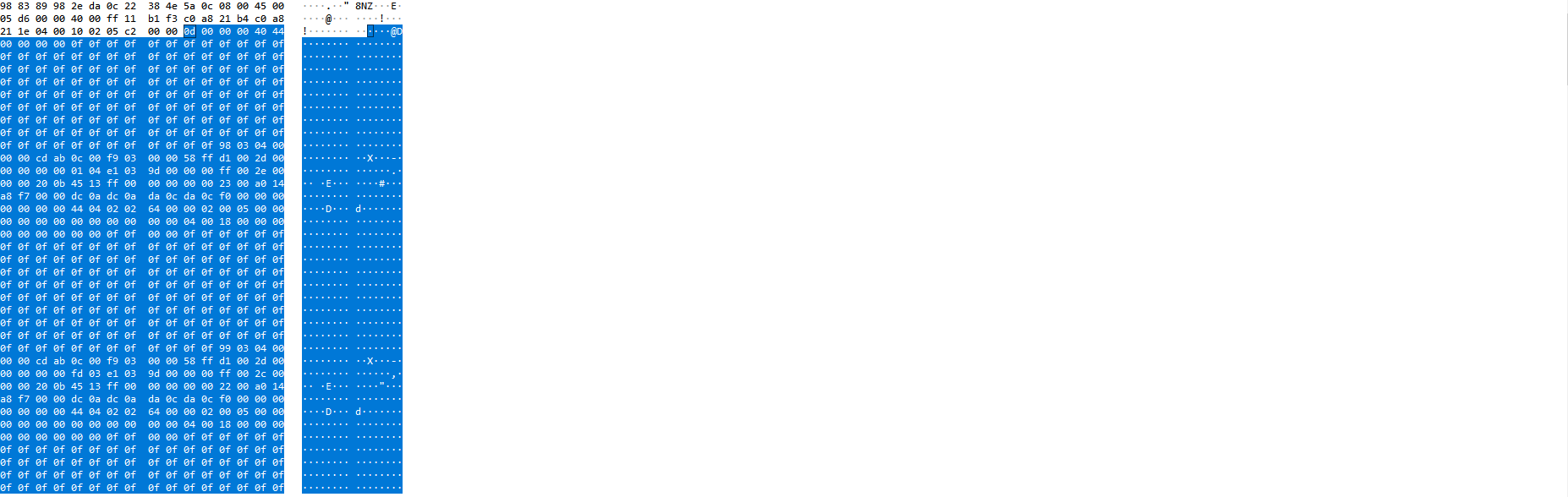

However, with monitoring using Wireshark, I could not find and data that i wrote on LVDSStreamSwConfig.
What part do i miss to capture user data through lvds and ethernet communication using AWR1642 and DCA1000?

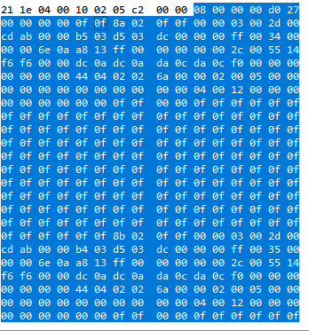

  •  This is the output when i use default code in mmw demo file..
    I could not confirm that this is the right file..
    Inn the modified code, create that data buffer as global not local to function as actual LVDS transmission happends using eDMA and triggers after this function returns.
    If you are enabling HSI header then it will add prefix of some bytes (including 0x0F0F) then adds up the user data.
    I'll provide the exact captured data format soon. Meanwhile make those buffer as global variable and retain the LVDSUserDataHeader to userBufferInfo[0] and add new global buffer to userBufferInfo[1]
    sessionCfg.u.swCfg.userBufferInfo[0].size = HSIHeader_toCBUFFUnits(sizeof(MmwDemo_LVDSUserDataHeader_t));
    sessionCfg.u.swCfg.userBufferInfo[0].address = (uint32_t)&(streamMcb->userDataHeader);
    sessionCfg.u.swCfg.userBufferInfo[1].size = HSIHeader_toCBUFFUnits(sizeof(buff_data1));//(datPathObj->numDetObj) * sizeof(MmwDemo_detectedObj));
    sessionCfg.u.swCfg.userBufferInfo[1].address = (uint32_t)buff_data1;//datPathObj->detObj2D;

  • Thanks a lot!! When change variable to global variable, I could see data through wireshark.

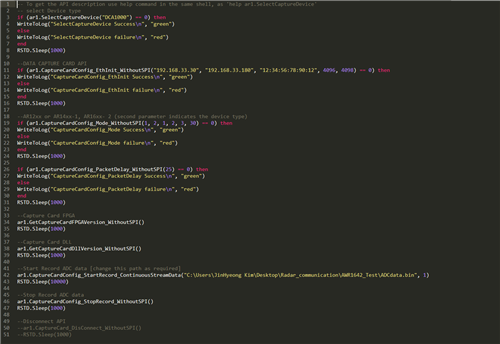

    2. When I configure DCA1000EVM through Lua command, I could select Capture mode via ar1.CaptureCardConfig_Mode_WithoutSPI()
    At the first of this function, it means eLogMode. So when i put 1 to that part, it means Raw mode, and 2 means Multimode
    When using DCA with 1, it transmits maybe 1466 bytes via ethernet, while with 2 it transmits 266 bytes. With former one, user sw config data is located at the end of the packet. And with the other, sw config data is located and repeated among the entire packet. Which is more useful, if I just want to transmit user sw data through lvds and ethernet with high speed?
