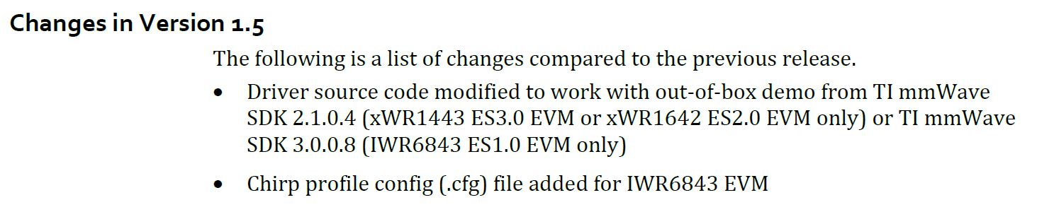

I am having issues using the ROS driver with the IWR6843 ISK running mmWave SDK version 3.1. I would guess that these issues are caused by changes to the way data is packaged between previous versions of the SDK and 3.1, but I am not sure. Has this sensor been tested with ROS?

[ INFO] [1554322830.904481030]: mmWaveQuickConfig: mmWaveQuickConfig will now terminate. Done configuring mmWave device using config file: /home/radar/ROS_workspace/src/ti_mmwave_rospkg/cfg/6843_2d.#chirp config sent successfully
terminate called after throwing an instance of 'std::out_of_range'
what(): vector::_M_range_check: __n (which is 192) >= this->size() (which is 192)
