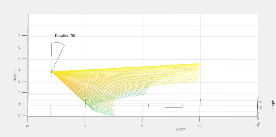

Sorry if I'm not clear, I'll add a picture of my GUI to help you understand my use case if needed.

  • Hi Akash,
    Sure ! If you need more precisions, feel free to ask.
    Here is the display I have created according to my use case to see the targets :
    Have a nice day !
    Quentin.

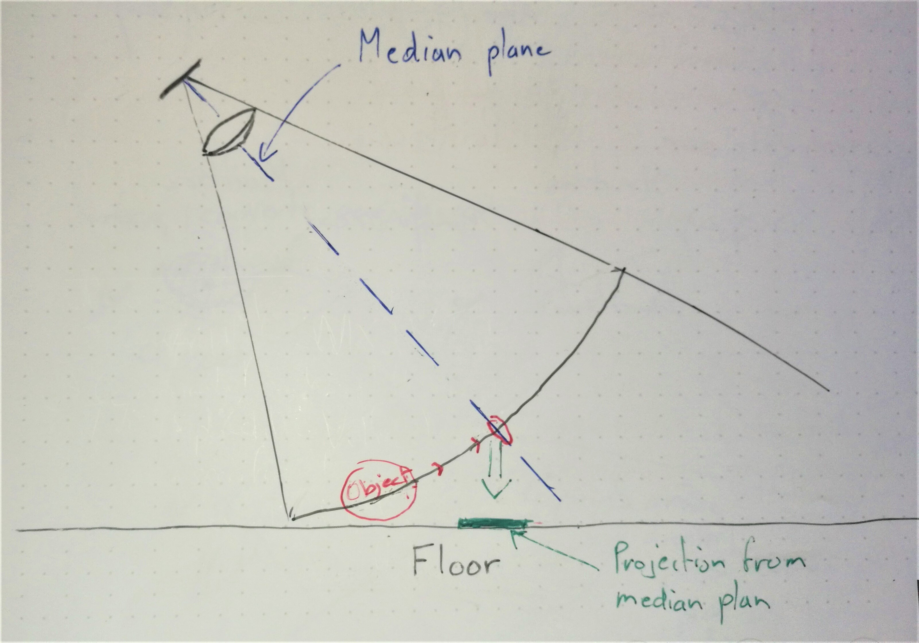

  • Hi Akash,
    Thanks a lot for your answers !
    Ok, so If I use IWR1443 I'll have to export datas to perform tracking on an other hardware.
    Actually, I have to manage 3D Point Cloud to get the exact position of the object (because of the elevation tilt; if I don't use it, the projection from the median plan to the floor will have an error). Here is a little draw to illustrate it : (sorry drawing is not one of my hobbies !)
    But if I can achieve a projection on a plan parallel to the floor, then I could use the 2D tracking with those good projection !

  • Hi Quentin,
    I think your drawing looks great! Let us know how results look with the Area Scanner Lab.
    The Elevation tilt is fixed because the on-board antenna has an elevation field of view of +/- 15 degrees (so 30 total). If you want to tilt the sensor more or less then you are going to compromise your detection range in one direction or another.
    Again this is a physical limitation so it cannot be corrected through software.

  • Hi Akash,
    Thanks ! Sure, I'll begin to add a new CLI to input coordinates of the radar (X,Y,Z,Azi. angle, Ele. angle) in my area, then I'll compute data in my area basis (and not in the sensor one) and finally I'll project those 3D points on the "floor" to apply 2D tracking !
     I understand, I'll lose in range but because I have to monitor object on the floor from few meters high I think I have no choice. Maybe with an other radar with a bigger cone I could mount it overhead to monitor objects without computing from elevation angle! But that's not possible currently.
