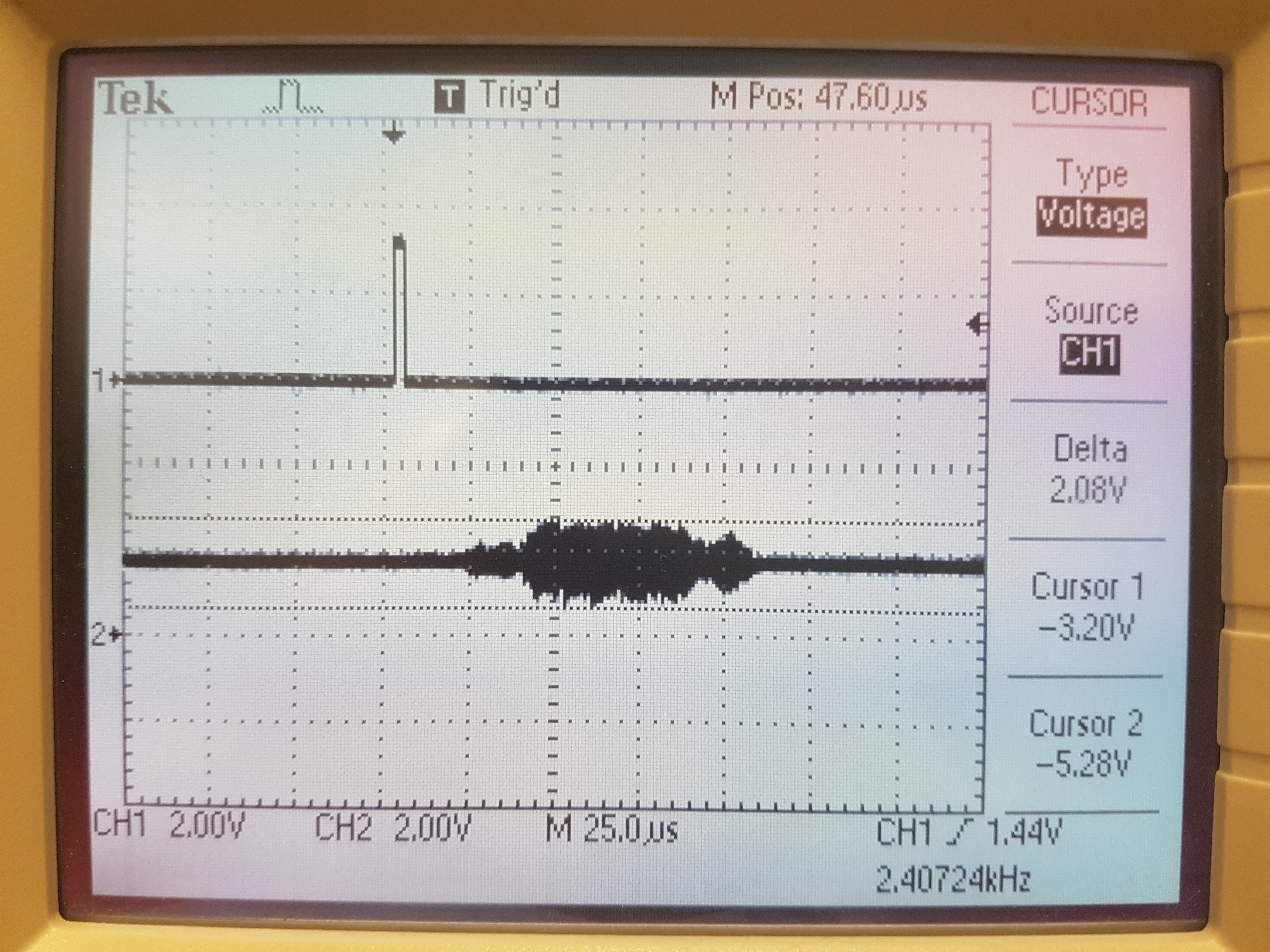

I am working with TDC1000 where my goal is to measure ToF using Piezo ceramic transducer 1MHz. I am following snaa270.pdf application report (Using Ultrasonic Sensing to Monitor Level in Tanks) to test that my circuit and sensor is working properly, but no matter how far is my object from the transducer ToF is not changing. That it would be more clear that's what i did:

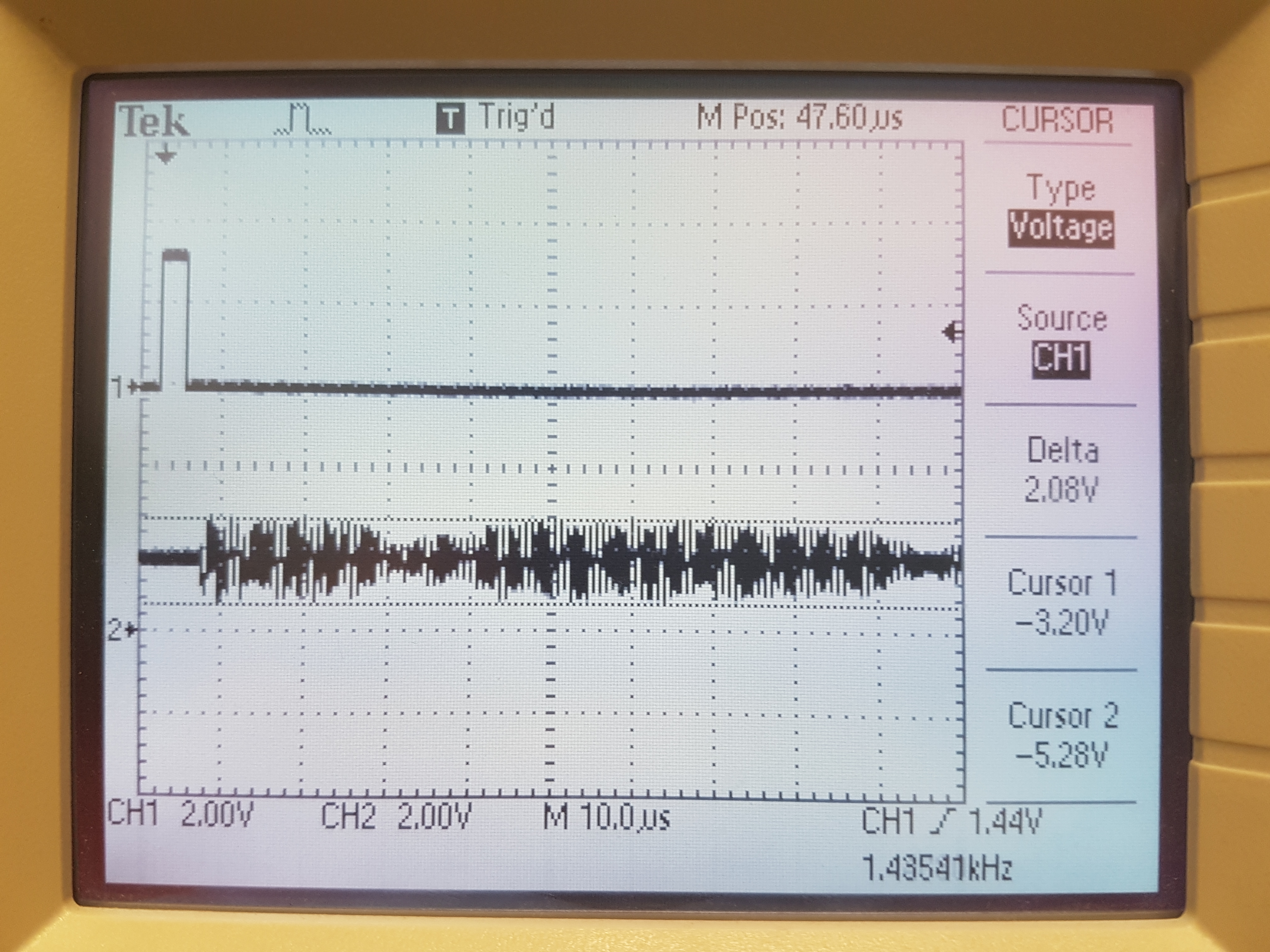

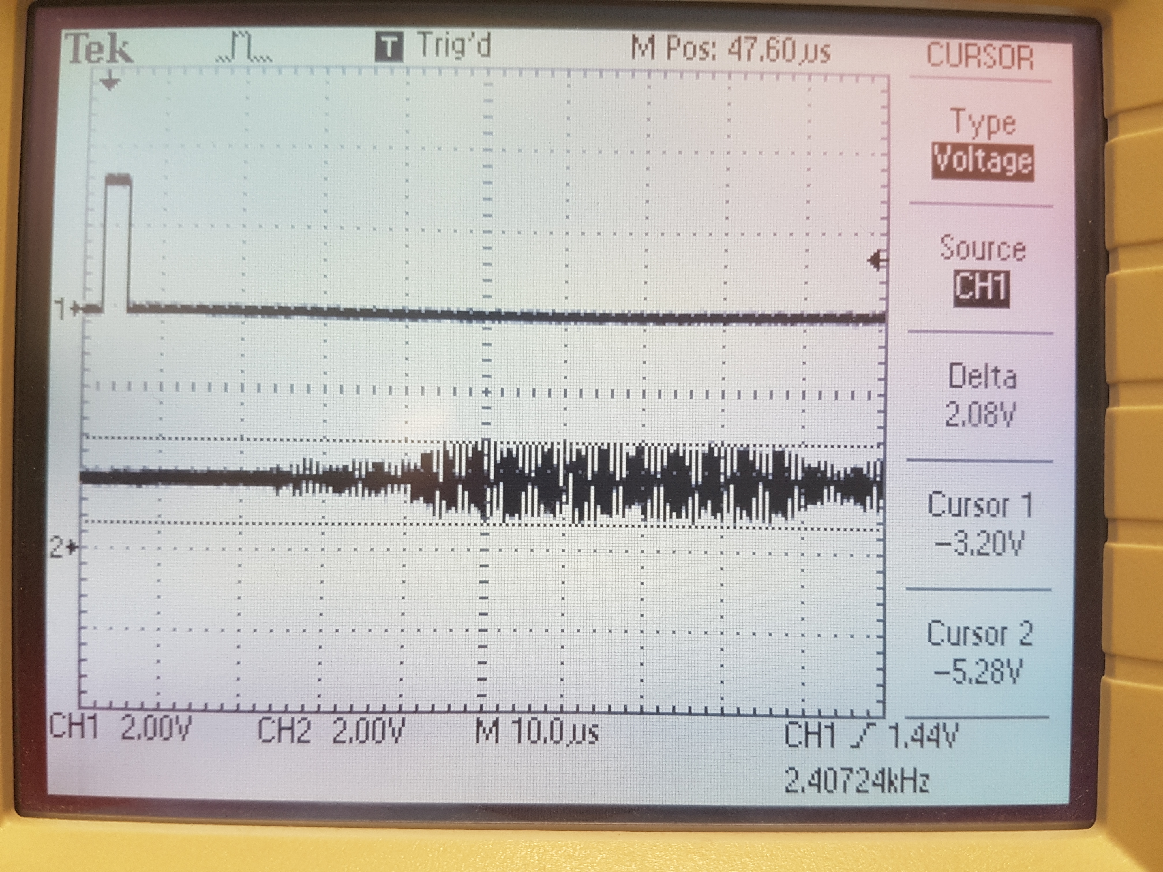

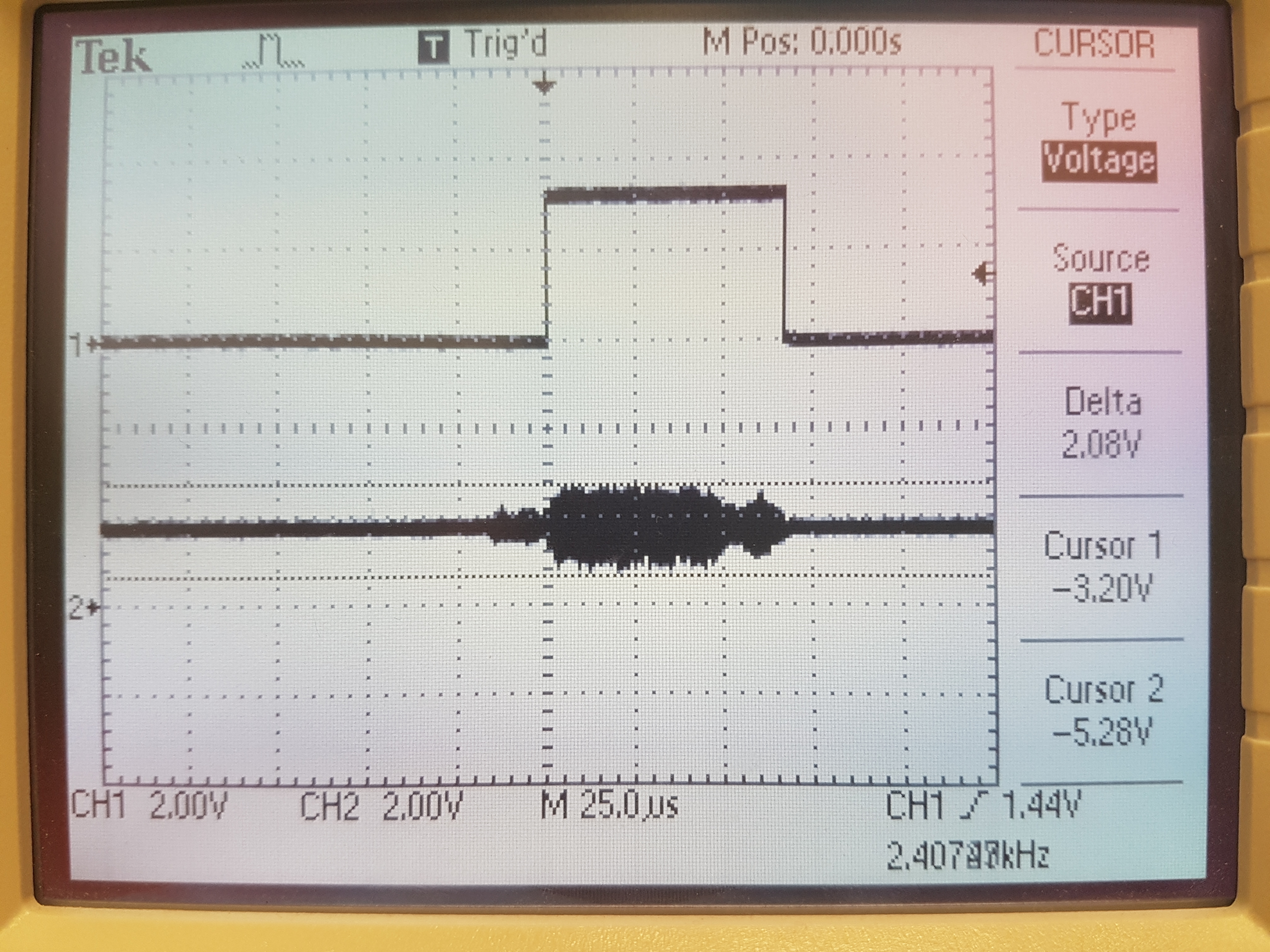

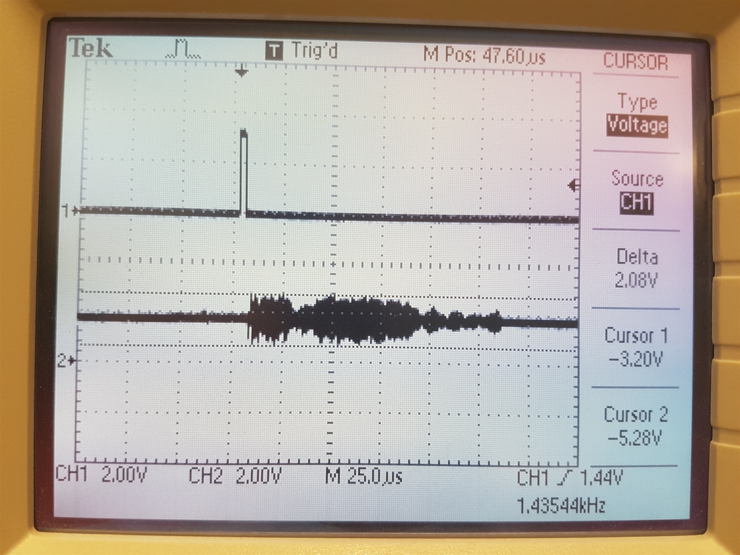

2) Measured Start, Stop & Compin with osciliscope.
CH1 START CH2 COMPIN
CH1 START CH2 STOP
CH1 STOP CH2 COMPIN
3) Tried to move object closer to the transducer and further graphs stays the same.

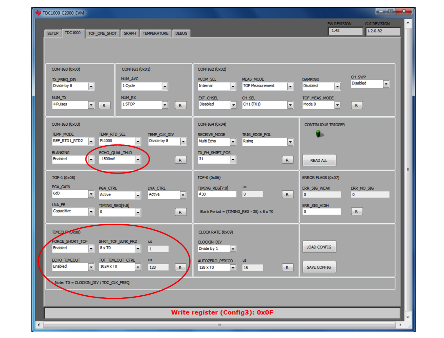

4) Continued with snaa270.pdf and changed register values of TDC1000.
CONFIG_0
            RAW:                           0x44
            TX_FREQ_DIV:            8
            NUM_TX:                                4
CONFIG_1
            RAW:                           0x41
            NUM_AVG:                 1
            NUM_RX:                                1
CONFIG_2
            RAW:                           0x0
            VCOM_SEL:                 INT
            MEAS_MODE:             TOF
            DAMPING:                   OFF
            CH_SWP:                                 OFF
            EXT_CHSEL:                 OFF
            CH_SEL:                                   1
            TOF_MEAS_MODE:                0
CONFIG_3
            RAW:                           0xF
            TEMP_MODE:             REF, RTD1, RTD2
            TEMP_RTD_SEL:                     PT1000
            TEMP_CLK_DIV:                      8
            BLANKING:                  ON
            ECHO_QUAL_THLD:                -1500 mV
CONFIG_4
            RAW:                           0x5F
            RECEIVE_MODE:                     MULTI ECHO
            TRIG_EDGE_POLARITY:           RISING
            TX_PH_SHIFT_POS:     31
TOF_1
            RAW:                           0x40
            PGA_GAIN:                  6 dB
            PGA_CTRL:                  ON
            LNA_CTRL:                  ON
            LNA_FB:                                  CAPACITIVE
            TIMING_REG[9:8]:      0
TOF_0
            RAW:                           0x1E
            TIMING_REG[9:0]:      30
ERROR_FLAGS
            RAW:                           0x0
            ERR_SIG_WEAK:                     0
            ERR_NO_SIG:              0
            ERR_SIG_HIGH:                       0
TIMEOUT
            RAW:                           0x43
            FORCE_SHORT_TOF:   ON
            SHORT_TOF_BLANK_PERIOD: 8 x T0 -> 100.00 us
            ECHO_TIMEOUT:                    ON
            TOF_TIMEOUT_CTRL: 1024 x T0 -> 12800.00 us
CLOCK_RATE
            RAW:                           0x1
            CLOCKIN_DIV:             1
            AUTOZERO_PERIOD:  128 x T0 -> 1600.00 us
TOF Control:                           Short TOF

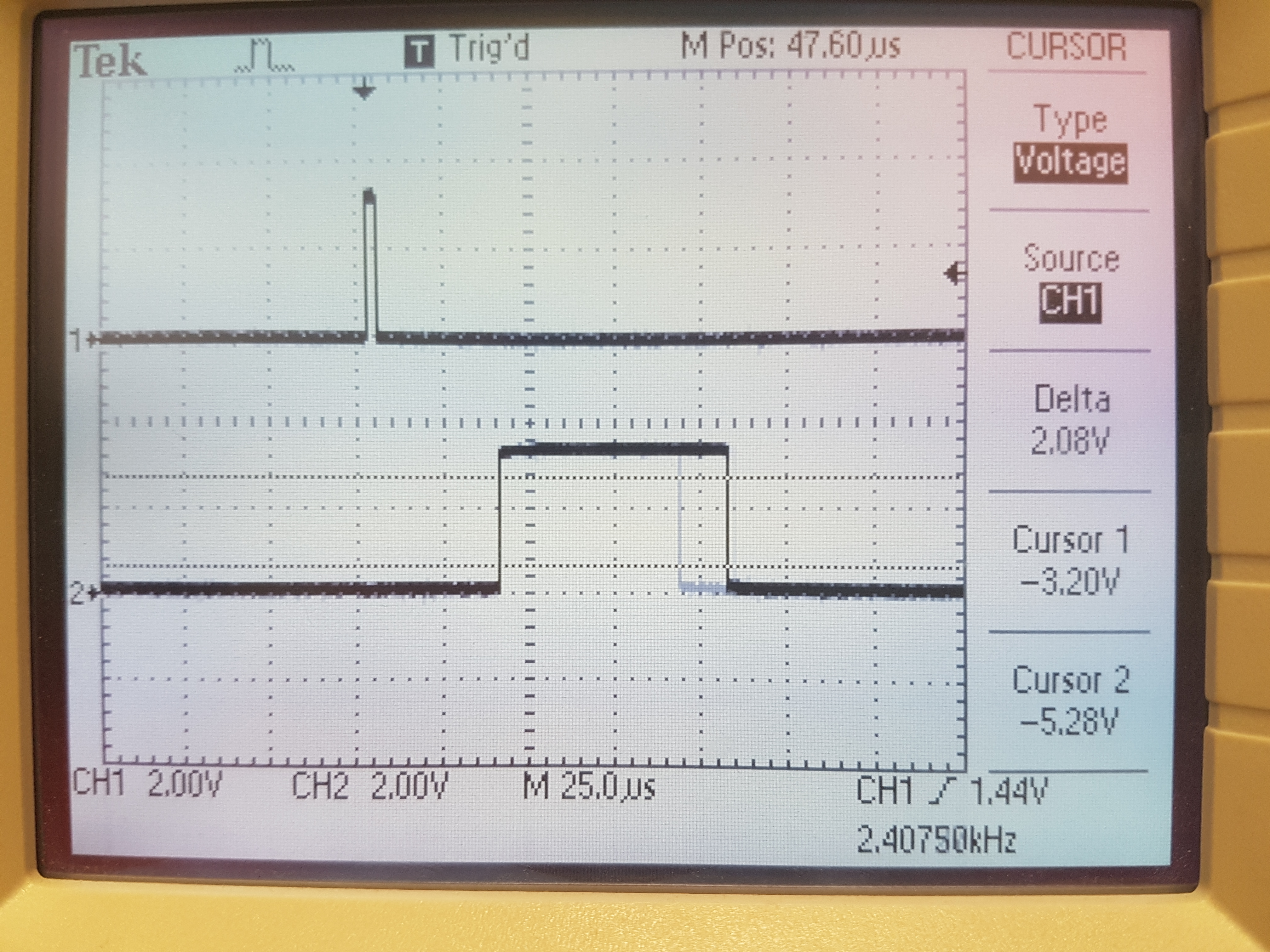

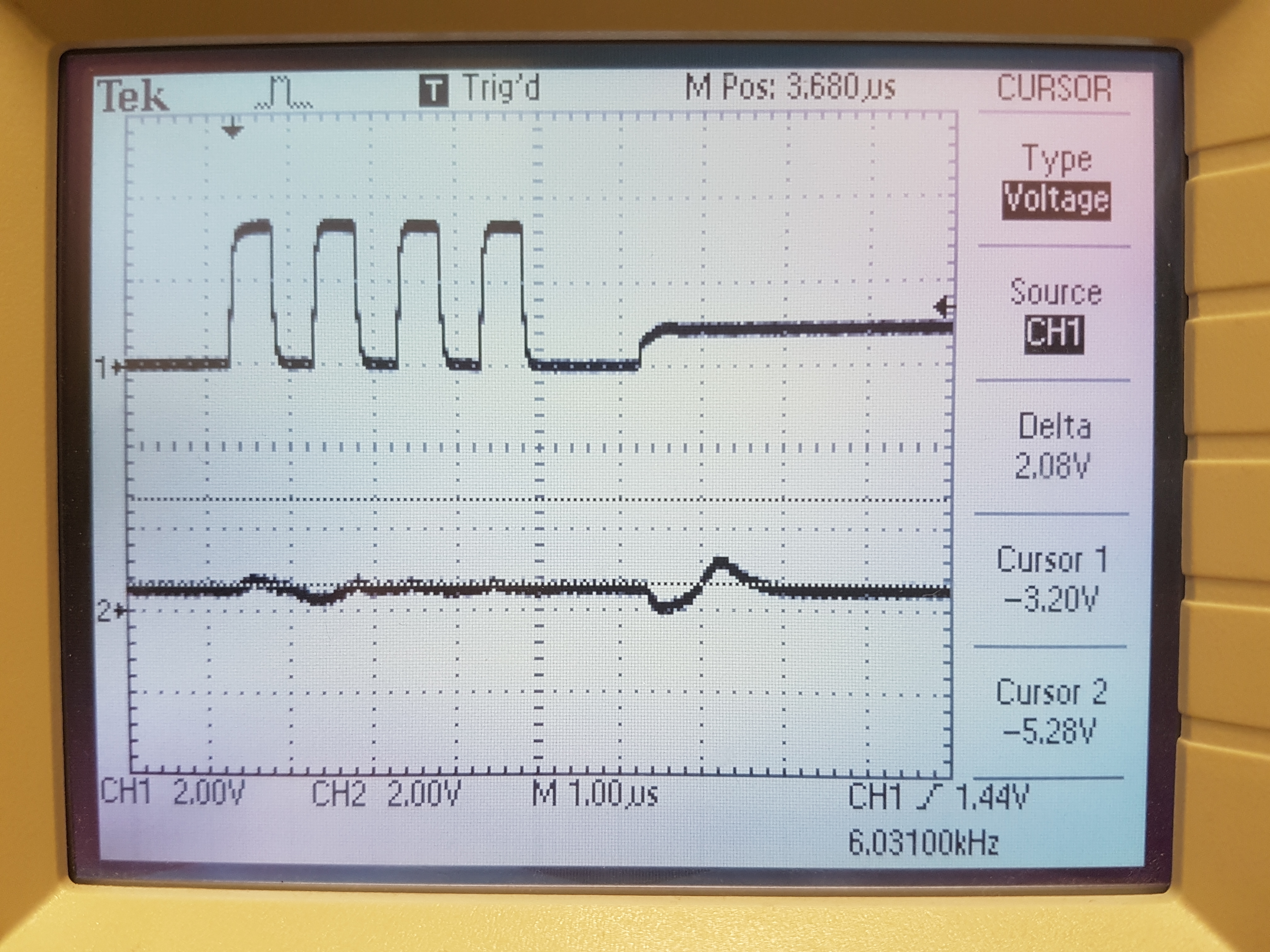

5) Measured Start and COMPIN
CH1 START CH1 COMPIN
This measurements i did just to test that my transducer and circuit is working properly before glueing transducer to the tank. So between object and transducer there is an air instead of water. I assume that ToF still should vary depending on the distance between transducer and object. Thank you.

    Thank you for your reply, i was not clear enough, so i will try to explain situation better. I only tested transducer in the air, because i didn't want to glue it to the tank before knowing that it is working properly. Everything is running on 3.3V except  LMH6601MG -  Operational Amplifier which has 5V. I am also adding a picture of my TX signal below. First of all i would like to test it in the air and see that my ToF is changing depending on the distance between object i want to measure and transducer.
    1) Maybe my assumption is wrong that transducer should also work in the air without having obstacles(like tank wall) in between transducer and object i want to measure? (Is it only work when its glued? )
    2) What is the signal then which i see on my COMPIN ? (Is it noise?)
    Since i know that transducer and circuit is working my final goal is to measure liquid level inside the tank which is made from plastic. The maximum range of liquid level i am planning to measure is 15cm and the minimum 1cm.
    I hope it is more clear. If you have more questions let me know. Thank you.
    CH1 TX CH2 COMPIN

    However I assume, you would like to check if the setup works before your actually glue to the system. In such cases, please place the transducer in front of a metal/plastic wall and then measure the ToF with the device. Please note while the medium is air in the GUI change the LNA feedback to resistive and check if you receive any signal from the reflection back. You may also need to increase the PGAGain.
    From the last screen shot you have provided me i can see a signal of about 1V in the COMPIN pin, but I cannot say for sure if it is real signal or noise.
  • Bharat,
    I tried to change LNA_FB field to resistive and measure ToF, unfortunately it didn't work and i had the same results. I also tried to cover all the other sides of the sensor with hot glue and place sensor in front of my plastic wall that also didn't help. So i assume that in order to test the system and 1mhz disc the only solution is to glue it.
    I tried afterwards to glue disc to the tank and then it start working. (using snaa266.pdf)
    So there is no way that measurement of the liquid level could be taken without glueing your disc to the tank? (Maybe someone achieved this and share somewhere, but i am not aware of that)
