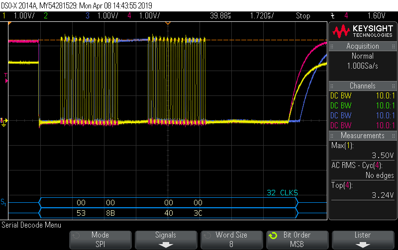

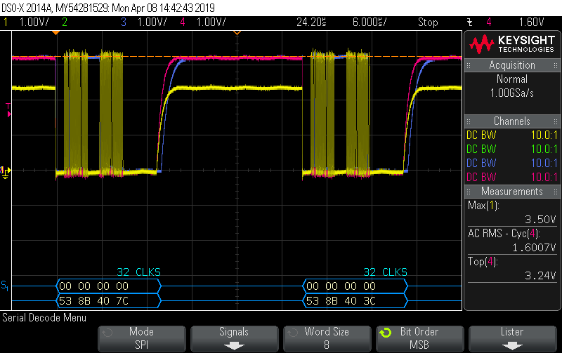

  • No problem, screen shots below. I could only get a probe on 3 of the SPI lines(MOSI excluded).
    Yellow - SPI clock(First time I noticed the amplitude difference at the beginning and end of each transmission)
    Blue - SPI MISO
    Pink - SPI CS/NSS
    This was 2 simultaneous read requests to read register DEV_OVUV1. Message from master is 0x5300000B. This scope has a serial decoder, so the blue boxes at the bottom are the decoded SPI frames. The bottom line is what was received from the PGA411. 8B 40 is the correct data programmed in that register.
    This image is a zoomed in version of the second read request. Still a bit hard to see, I could send a closer image if desired. There are 32 clock pulses.

  • The amplitude difference of the SPI clock is strange. However, since the signal appears valid while NCS is low, I doubt that it is the problem.
    I noticed that you are sending the same message two times in a row except for bit 6.
    53 8B 40 7C
    53 8B 40 3C
    Bits 6 and 7 are supposed to be reserved as 0 as seen in figure 41 of the datasheet. Perhaps that is causing the issue?

    I was unable to probe the SDI pin, so the transmit message from the MCU is not pictured. The message 0x5300000B was sent 2 times, and those screen shots are the responses from those 2 messages.
    As you mentioned, the bits that are different between those 2 messages are the SPI status bits. It appears that the message 0x01(SPI CRC error) was received in the first message, and 0x00 was received in the second. I'm guessing either the error only appears in the first message attempt, or the status bit becomes invalid after a SPI error is detected.
    Is message 0x5300000B correct for reading the DEV_OVUV1 register? The read example in the "Step-by-Step Initialization" document sends a dummy data value of 0x00F0 instead of 0x0000, is there any requirement to the value that is sent as dummy data?
    I also see that there is a configuration CRC based on the values stored in EEPROM. Does this value need be used instead of the normal CRC-6 value used when performing a write? My value of 0x0B is the CRC-6 of 0x530000.
  • Your message values look correct. I'm wondering if the problem is with the SCLK line. Note that SDO is not released until NCS has crossed the logic high value. SCLK, which is controlled by the MCU, is being released at the same time as NCS.
    Normally SCLK is low between SPI frames. Is there a way to configure your MCU to do that?
