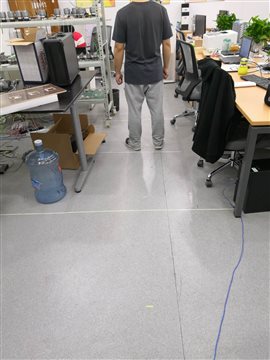

  • Hi Akash,
    The scene is as shown in the following pictures:
    labsetup01
    In the above scenario, we tested the positions of (0, 1), (0, 2), (0, 3), (0, 4), (0, 5). I just show the test result of (0, 4) in the following (the result of other points as almost the same):

  • Hi Michael,
    The algorithms are actually quite similar, if there is a particular discrepancy you'd like to discuss feel free to post it.
    A discrepancy of range data is more likely a result of your test setup, such as the distance of the sensor to the floor, movement of sensors between trials, and even movement of people themselves.
