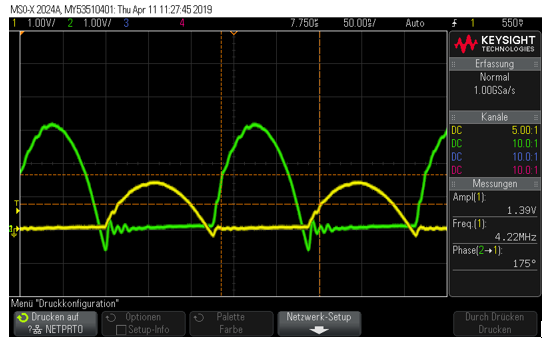

    Here is the scope capture for the specified configuration of the system (IDRIVE: Code = 25 / Current = 644uA , Measurend Amplitude = 1,39V, Channel 1 (yellow): IN3A, Channel 2 (green): IN3B). The sensor probe is connected to IN3A of the Eval Board:
    And here is the scope capture for most sensitive configuration of the system (IDRIVE: Code = 9 / Current = 60uA , Measured Amplitude = 280mV, Channel 1 (yellow): IN3A, Channel 2 (green): IN3B). The sensor probe is connected to IN3A of the Eval Board:

  • Hi E.P.,
    Thank you for sharing the scope captures. They are very helpful, and I think I see your problem. Your oscillation amplitudes on IN3A and IN3B are unbalanced, so I assume you have connected your aluminum foil sensor to IN3A only. This will significantly increase the capacitance for only half of the oscillation period; during the other half the aluminum foil sensor will be grounded on both sides. This increase in capacitance will significantly decrease the Rp of the sensor during half of the oscillation period, which will in turn require more drive current to keep the oscillation amplitude between 1.2-1.8V. The problem is that this increased drive current will be too much for the other half of the oscillation period, driving the oscillation amplitude far above the 1.8V maximum. The oscillation amplitude needs to be between 1.2-1.8V for both INxA and INxB, and ideally they should have the same amplitude.
    In your case, when IN3A is at 1.39V, IN3B is at ~3.2V. This is extremely close to the absolute maximum voltage on any pin (VDD + 0.3V), and the ESD diodes are likely starting to turn on, which will significantly impact your measurement accuracy. Prolonged operation at this voltage may impact the device's reliability, as the absolute maximum ratings are stress tests only. When you reduce the drive current, you are likely seeing an improvement in SNR because the ESD diodes are not affecting your measurements.
    To solve this issue, I suggest using a differential measurement. You can do this simply by cutting your aluminum foil sensor in half and connecting one side to INxA and the other side to INxB. Then you should have roughly even amplitudes and should be able to set your drive current so that the amplitude is correct for the full oscillation period. If you want further information about setting the drive current, the drivers of the LDC131x/LDC161x devices are similar to the FDC2114, and this app note should help: www.ti.com/.../snoa950.pdf
