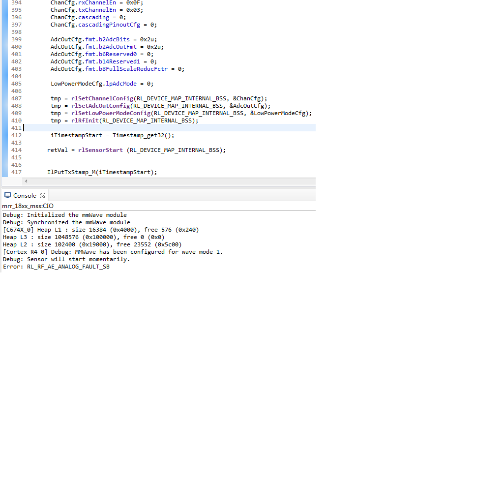

  •  Hi Adrian,
       Customer tried this method today, they followed the exactly the same API sequence, but got errors as below.
  • Hi Adam
    I checked with design team. The analog logic is turned off during the interframe period. There is no need to do that with SW, it is performed by default
    There are two configuration options to reduce power
    1) LOWPOWERMODE
    This is static device configurations (applicable for this power cycle) - Sigma
    Delta ADC root sampling clock rate (reducing rate to half to save power in small IF bandwidth
    applications).
    2) DYNAMICPOWERSAVE
    This sub block defines static device configuration - whether to enable dynamic power saving
    during inter-chirp IDLE times by turning off various circuits e.g. TX, RX, LO Distribution blocks. If
    Idle time + Tx start time < 10us or Idle time < 3.5us then inter-chirp dynamic power save option
    will be disabled, in that case, 15us of inter-burst idle time will be utilized to configure sequencer
    LO, TX and RX signal timings by firmware.
