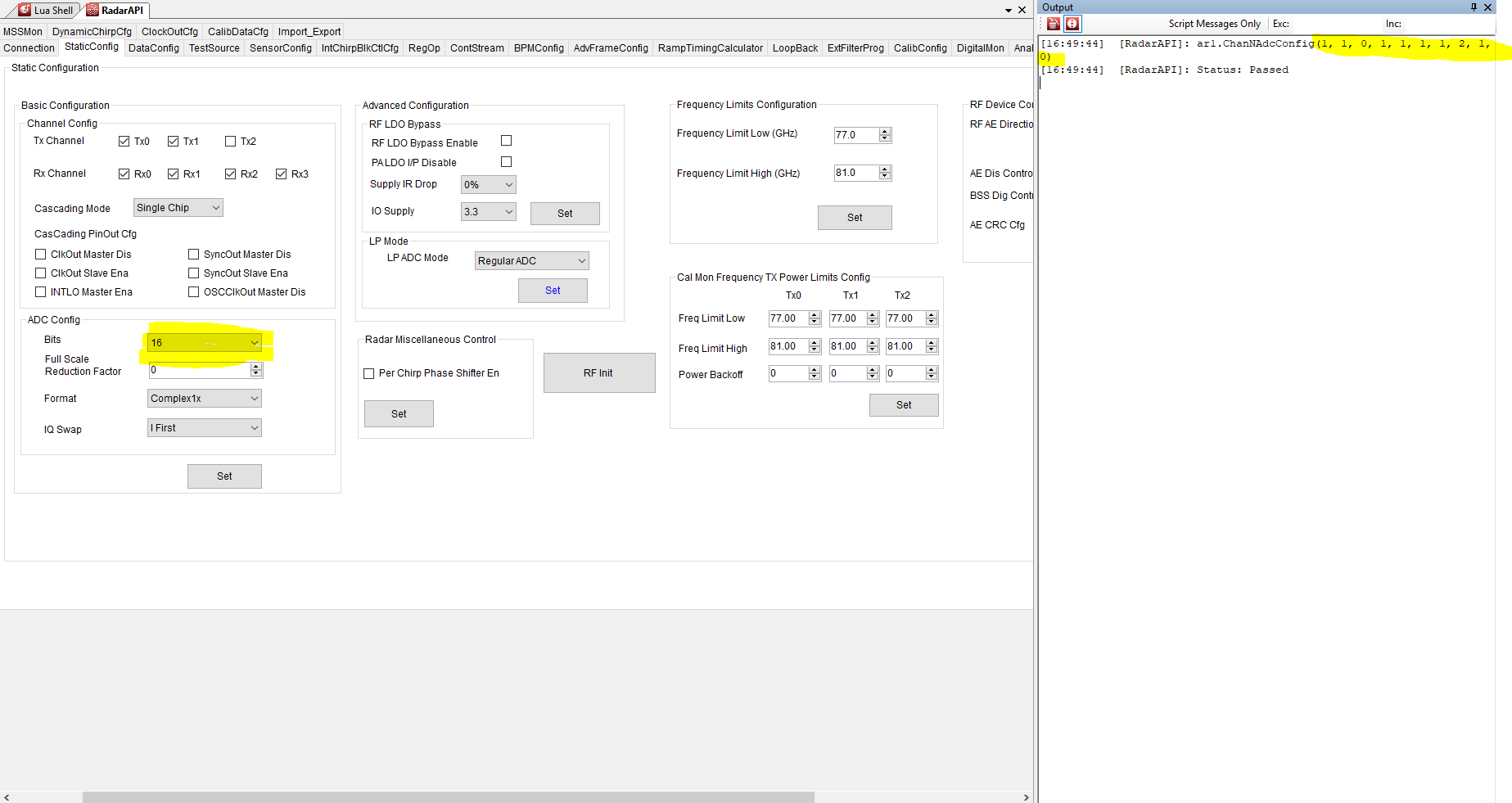

Hey all,

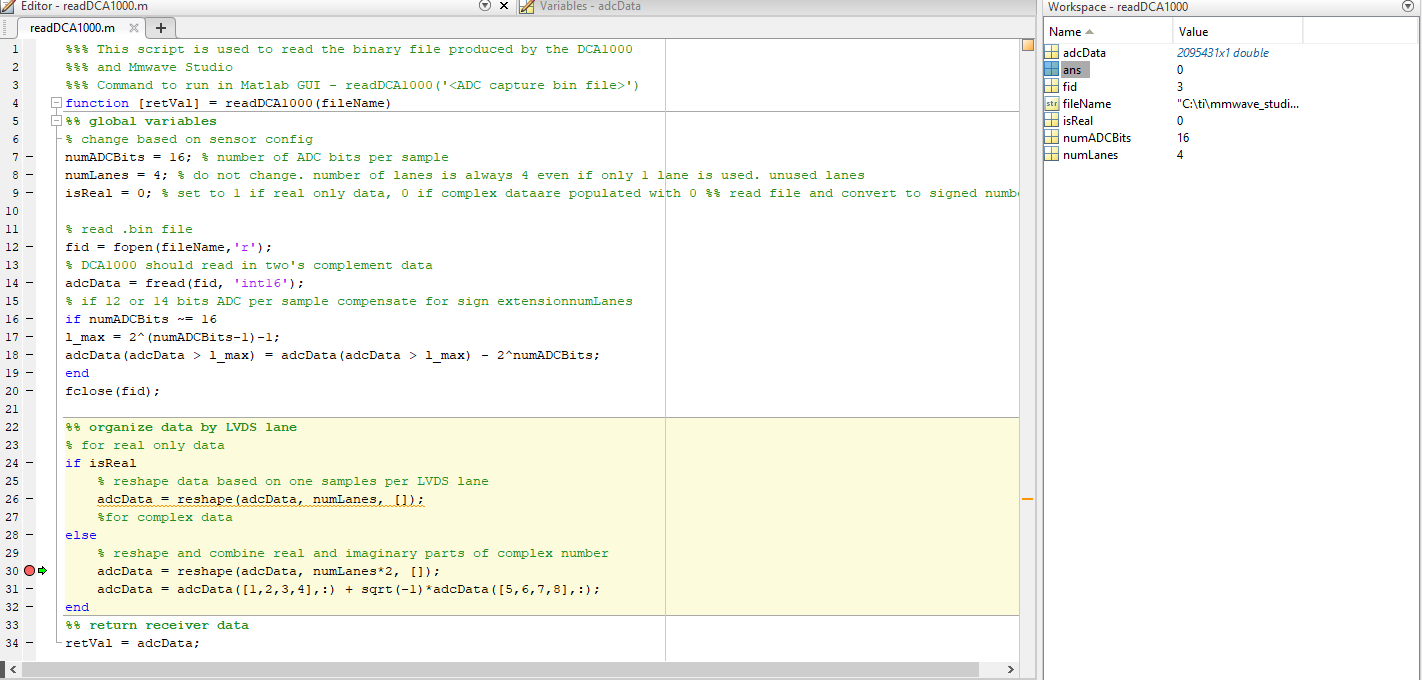

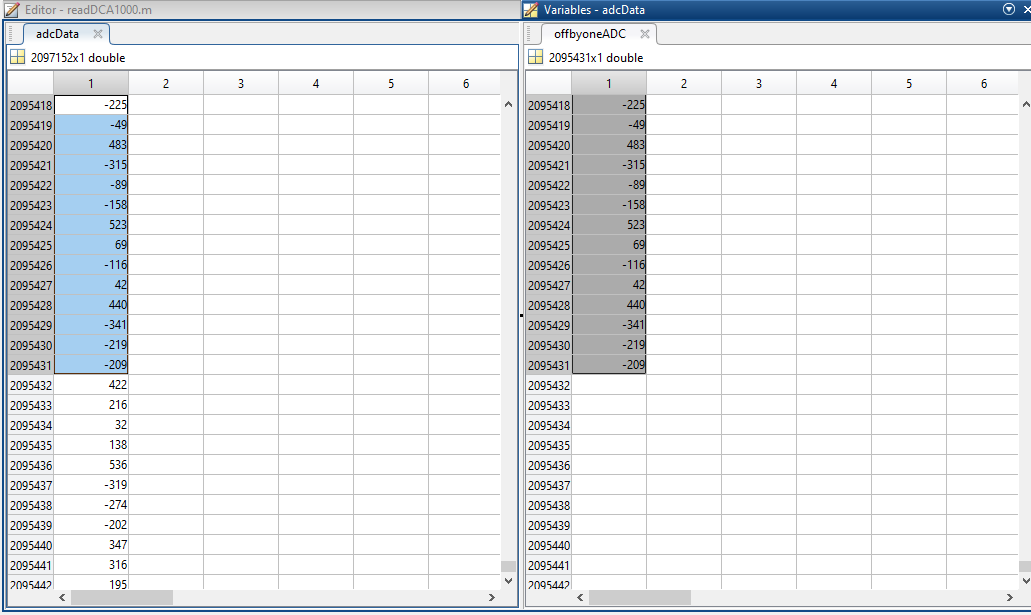

I'm having trouble reading the adc_data.bin with the MATLAB code provided in the user guide: mmwave Radar Device ADC Raw Data Capture. Here's the MATLAB code I run which is a direct copy from the user guide, section 9.1:
%%% This script is used to read the binary file produced by the DCA1000
%%% and Mmwave Studio
%%% Command to run in Matlab GUI - readDCA1000('<ADC capture bin file>')
function [retVal] = readDCA1000(fileName)
%% global variables
% change based on sensor config
numADCBits = 16; % number of ADC bits per sample
numLanes = 4; % do not change. number of lanes is always 4 even if only 1 lane is used. unused lanes
isReal = 0; % set to 1 if real only data, 0 if complex dataare populated with 0 %% read file and convert to signed number
% read .bin file
fid = fopen(fileName,'r');
% DCA1000 should read in two's complement data
adcData = fread(fid, 'int16');
% if 12 or 14 bits ADC per sample compensate for sign extensionnumLanes
if numADCBits ~= 16
l_max = 2^(numADCBits-1)-1;
adcData(adcData > l_max) = adcData(adcData > l_max) - 2^numADCBits;
end
fclose(fid);
%% organize data by LVDS lane
% for real only data
if isReal
    % reshape data based on one samples per LVDS lane
    adcData = reshape(adcData, numLanes, []);
    %for complex data
else
    % reshape and combine real and imaginary parts of complex number
    adcData = reshape(adcData, numLanes*2, []);
    adcData = adcData([1,2,3,4],:) + sqrt(-1)*adcData([5,6,7,8],:);
end
%% return receiver data
retVal = adcData;

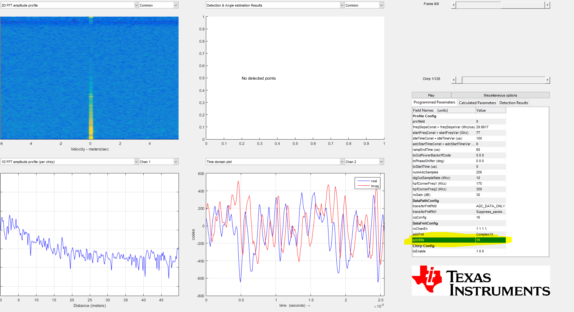

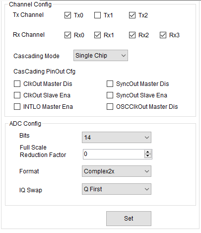

My IWR1443BOOST is ES3.0 and the mmWave Studio version is 2.0.0.2.
Here are the steps I followed:
1. Ran the procedure of the DataCapture Demo (I changed the chirp loop to be 128 and number of frames to 8). It ran from start to end no problem and gave the demo MATLAB Gui. Here's the Lua output after successfully completing the DataCapture Demo script:

2. Ran the MATLAB function provided by calling: readDCA1000("C:\ti\mmwave_studio_02_00_00_02\mmWaveStudio\PostProc\adc_data.bin") and got this error from MATLAB:
Error using reshape
Product of known dimensions, 8, not divisible into total number of elements, 2095431.
Error in readDCA1000 (line 30)
Error in cwins_process_adc (line 1)
readDCA1000("C:\ti\mmwave_studio_02_00_00_02\mmWaveStudio\PostProc\adc_data.bin");
I put a breakpoint before the ''reshape' and here's the screenshot:
I know that if the function successfully returns, the number of ADC samples should be = 256 (samples/chirp) * 8 frames * 128 (chirps/frame). But the reshape call breaks everything before that happens, because the number of adcData is 2095431 which is not divisible by 8.
Do I need to change the parameters in the provided MATLAB function? I'm pretty sure that I'm using 16-bit ADC and the data is complex1x as you can see from Lua shell output.

    Thank you for sending me the log files.  Looking at the configuration you are using, the ADC is configured to 14 bits.
    This line in the log file:
    "ar1.ChanNAdcConfig(1, 1, 0, 1, 1, 1, 1, 2, 1, 0)"
    corresponds to the configuration shown below in mmWave studio.
    Hope this helps.

  • Thank you Chloe,
    maybe I'm running a different software version, but in mmWave Studio, when I set the ADC Bits to be 16 and click set, the Lua output window gives: ar1.ChanNAdcConfig(1, 1, 0, 1, 1, 1, 1, 2, 1, 0).
    See screenshot above.
    And even when I set the ADC config as shown in the screenshot, MATLAB still reads 2095431 points from adc_data.bin. The number of points is not divisible by 8, therefore, the reshape call in readDCA1000.m will still run into the same error.

    also when I do the post_process in mmWave studio, the number of ADC bits given is also 16, see screenshot below:

    Also, I noticed an interesting thing.
    After setting up the parameters, if I just record the data by running the DataCaptureDemo, the resulting adc_data.bin as read in MATLAB has 2095431 points which is the same as before and the reshape call in MATLAB will return in error.
    After that, if I click post_proc in the mmWave interface, the MATLAB now reads 2097152 points and the data reading returns successfully.
    As a confirmation, the dataCapture visualization gives the correct graph in both cases.
    Is there any difference between the post process in the mmWave GUI and the one in DataCaptureDemo script?
  • Here are the two dataset read in Matlab, the one on the left is running post_proc from mmWave GUI, which gives the correct number of ADC samples; the one on the right results from just running the data_capture_demo0, and the ADC sample number is fewer than the former one.
    See the screenshot between for comparing the two datasets:
    Attached are the two Matlab data files shown in the screenshot:
    adc_datasets.zip
    Hope to hear back from you soon.
    Ziheng
