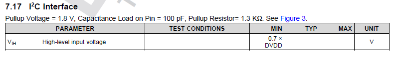

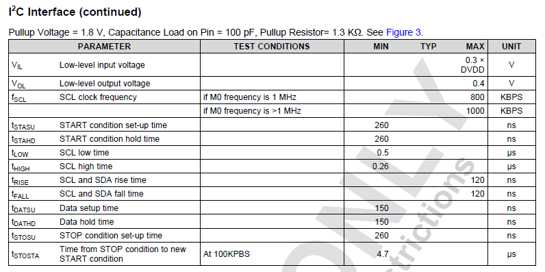

  • Hello Kazuki,
    I have joined your new post with the original thread since there is no new question being discussed.
    1. I did not say that the PGA305 and the PGA302 have the same I2C block. They have similar functionality, so I referred you to look at that. The overall functional block diagram is very different because these are entirely separate devices.
    2. We do not have a set timeline on when this will be updated. There are many document updates waiting in the queue.
    Below are unofficial specifications from a draft datasheet update.
  • Hello Scott,
    Thank you for providing I2C specification.
    Sorry for my miss understanding regarding I2C.
    Then, Why isn't there I2C signal line on the PGA302 Functional Block diagram?
    Our customer would like to know the reason of missing I2C line on functional block diagram of PGA302 in spite of there is I2C line on simplified block diagram of PGA302, 305 and functional block diagram of PGA305.
    Both simplified block diagram is similar regarding communication line. However there isn't I2C line on PGA302's functional block diagram.
    Kazuki Kuramochi
  • Hi Kazuki,
    Thank you for the explanation. I see the confusion now. I2C is a part of the device, but it is not currently not shown in the Functional Block Diagram in the datasheet. This is something that needs to be updated, and it will be addressed in the next revision of the datasheet.
