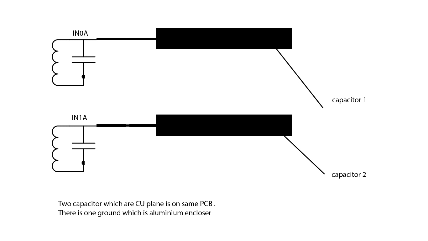

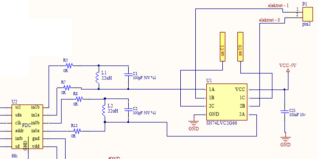

Hello;
An analog switch is connected to calibrate temperature stability.
When switch is off, tank capacitor is measured (100pF %1). The capacitor value is known, so this step is used for temperature stability.
When switch is on Electrot capacitance is measured.
But some thing is wrong and when temperature change, Reading value become faulty.
Any suggestion please.
