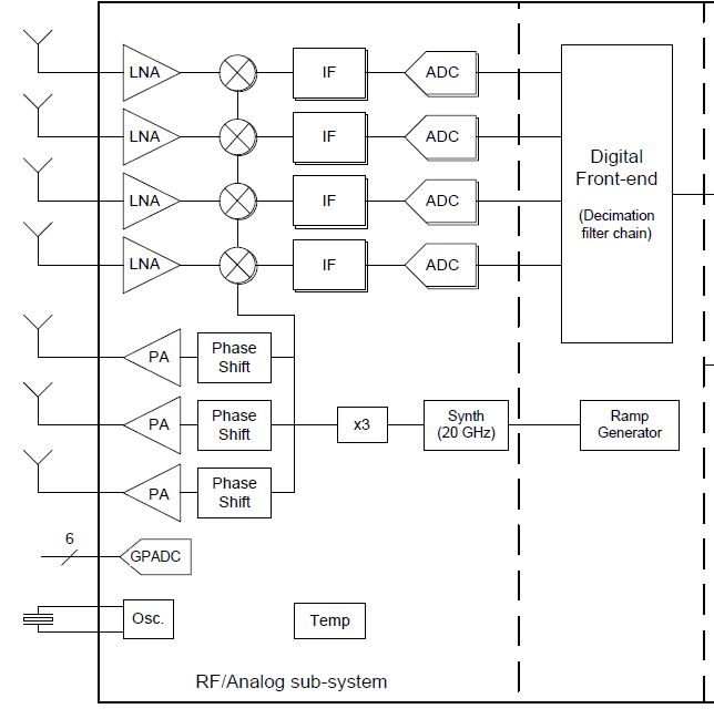

IWR6843: Range resolution of this device?
Part Number: IWR6843
I am confused. I read the manual and for transmitter it mentions  60- to 64-GHz Coverage With 4-GHz Continuous Bandwidth. However the IF BW is max 15 MHz. When I want to calculate range resolution for this radar (R=C/2B), by considering B=15 MHz, the resolution become 10 meters. Is this correct?
