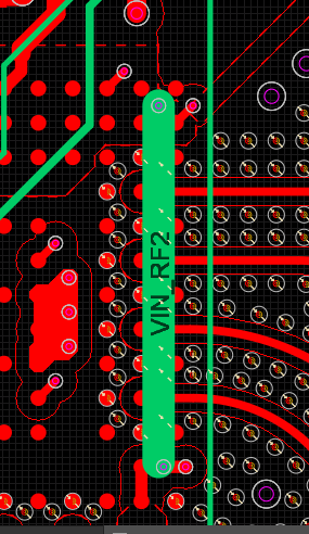

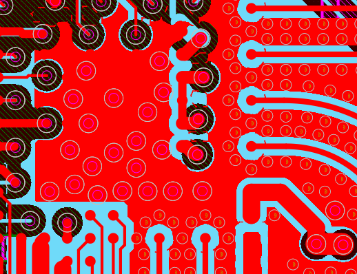

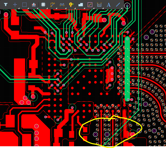

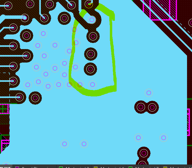

I refer to the TIDA020011 design  , the layer 3 area below these openings, is not a solid GND plane but seems to be power. The layer 3 area below the RF holes are as below
can you confirm whether the highlighted text is a typographical error or is Layer 3 should be a solid ground below that area.

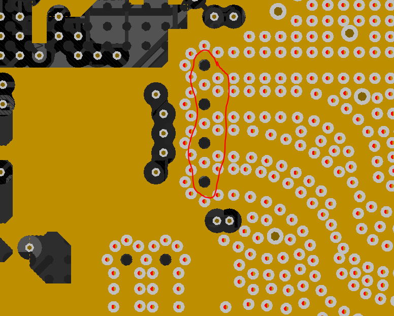

I looked at the AWR1642BOOST-ODS evm design files- it appears to have a ground plane in layer 3 as well.
Can some one confirm how important is this Layer 3 ground for the antenna range performance. I am looking for the same antenna performance as that of the ODS which has a 15m range.
