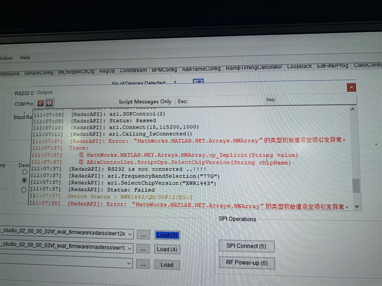

I am trying to use the IWR1443 to capture data with DCA1000 Board and mmwave studio, the Matlab version I use is R2017a.
today when I go ahead and get to the postproc step,
 it
it couldn't run and reported that: there is no MSVCR120.dll.
then I installed the Microsoft visual c++ 2013 redistributable package and Matlab runtime engine(version 8.5.1) in the guide:
When I restart the mmwave_studio and connect the RS232, it reported the below mistake:
I don't know whether the problem is caused by Matlab.
