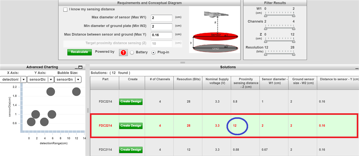

I used a webench designer tool to calculate the sensor diameter and its proximity sensing range. The results in the figure below.
I am using a FDC2214 EVM with our own SENSOR PLATE which has a diameter of 2 cm connected to INA and  GROUND PLATE with a diameter of 2 cm connected to INB of Channel 3.
Distance between sensor and ground plate is 0.16 cm (PCB thickness),  but the proximity sensing range didn't reach to 12 cm. Its only 3 cm.

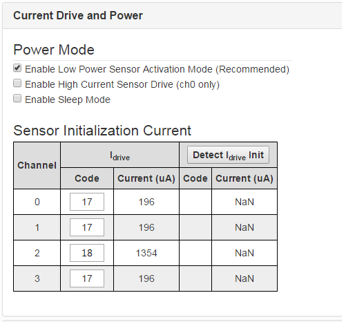

    3. After setting the Idrive code, do I need to press the "Detect Idrive Init"?

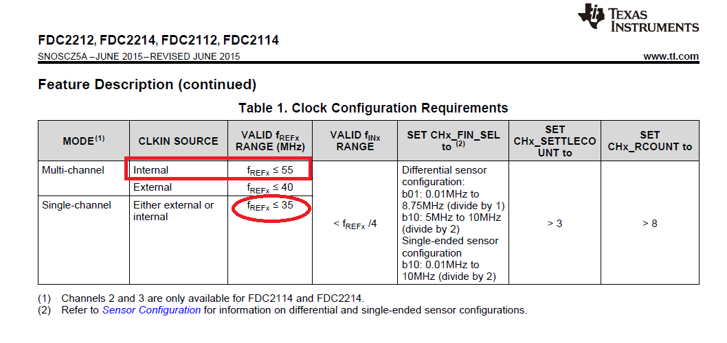

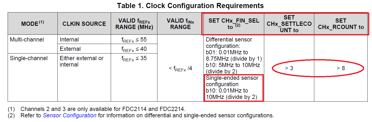

    4. In the datasheet it says, for single channel set CHx_FIN_SEL to "divide by 2", set CHx_settle count to > 3 and set CHx_Rcount to >8.  In configuration setting, which parameters have to set?

    3. No, do not press "Detect Idrive Init." This will override your current Idrive settings with the LDC's best guess for an appropriate Idrive setting. Once you update the Idrive registers the changes in the drive current will immediately take effect.
    4.These settings are not available in the configuration tab of the GUI. You will need to go to the register tab of the GUI to control these settings. Please see the register map in the datasheet for details on how to set these registers.

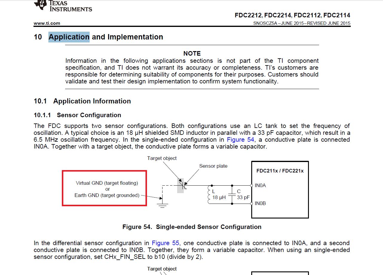

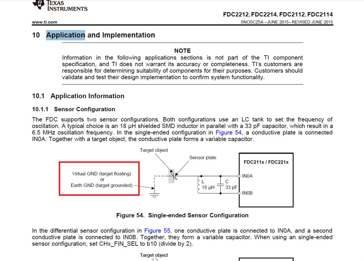

    1. What is the difference between virtual ground and earth ground?

    3. This is the result from the designer tool, where the sensor dimension is 2 cm and the detection target is human hand.
        What is the solution to reach this kind of sensing range ?

    1. I interpret virtual ground as AC ground, so either a power plane or a ground plane. Earth ground has a potential of 0V and is connected to earth. Why do you ask this question?
    2. The target does not have to be connected to ground, but a grounded target will have a stronger response. You do not need to ground a plastic target.
    3. The Webench Tool is available to give general guidelines about the type of sensing range that could be achieved for given sensor parameters. This sensing range may not be achievable in all environments. As I previously mentioned, the sensing range depends on many variables. You will need to experiment with different sensor sizes and sample rates to achieve a reliable 12cm sensing range.
    4. The internal oscillator is not configurable. Its frequency varies between FDC devices, with a minimum of 35MHz and a maximum of 55MHz. You can only decide between using either the internal oscillator or an external reference clock.

    1. I have seen the virtual GND and earth GND in the application information of the data sheet.

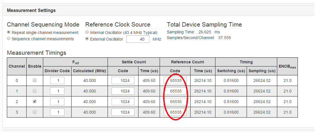

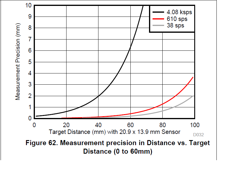

    2. What is sample rate and how to do it in GUI?

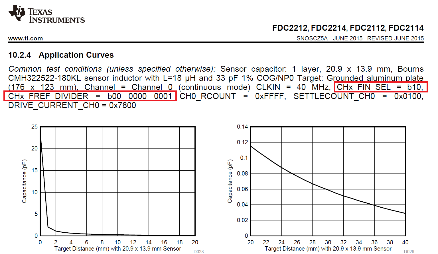

    3. This graph is from datasheet , page 45. How to reduce the sample rate in GUI ?
    4. Does the capacitor value in the graph is the "C" of "LC tank"?
    5. Please guide me how to set this in Register. Please refer to the red box. Thank you.
  • Hi Janine,
    1. Thank you for your explanation. My previous explanation of virtual and earth ground is consistent with this use.
    2. The sample rate is how quickly the FDC device can make frequency measurements and store them in the DATAx registers. You can change the sample rate by changing the RCOUNT_CHx and SETTLECOUNT_CHx registers. Page 16 and 17 of the datasheet contain more information about how to calculate your sample rate using your RCOUNT, SETTLECOUNT, and FREF values. In the GUI, use the Register Page to change the RCOUNT and SETTLECOUNT registers. Section 2.6 of the FDC2214EVM describes how to do this. The GUI will also calculate the sampling time on the Configuration page.
    3. I answered this question above.
    4. The capacitance value measured by the FDC2x1y devices will always include both the capacitor in the LC tank and any other capacitances affecting the LC tank. This includes capacitance between the sensor and the target, capacitances between the sensor and the environment, and parasitic capacitances on the INxA/INxB traces.
    5. You can set this register using the same method I described in answer 2 above. More details about individual registers can be found in the Register Maps section of the datasheet (9.6).
