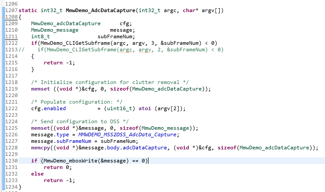

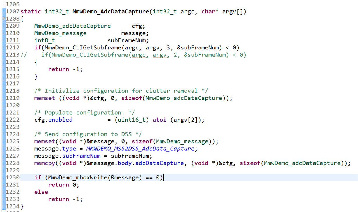

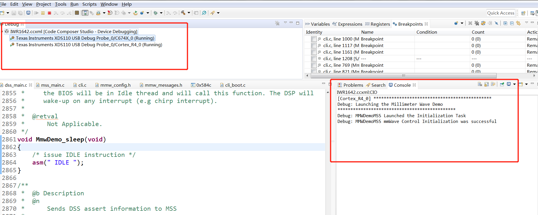

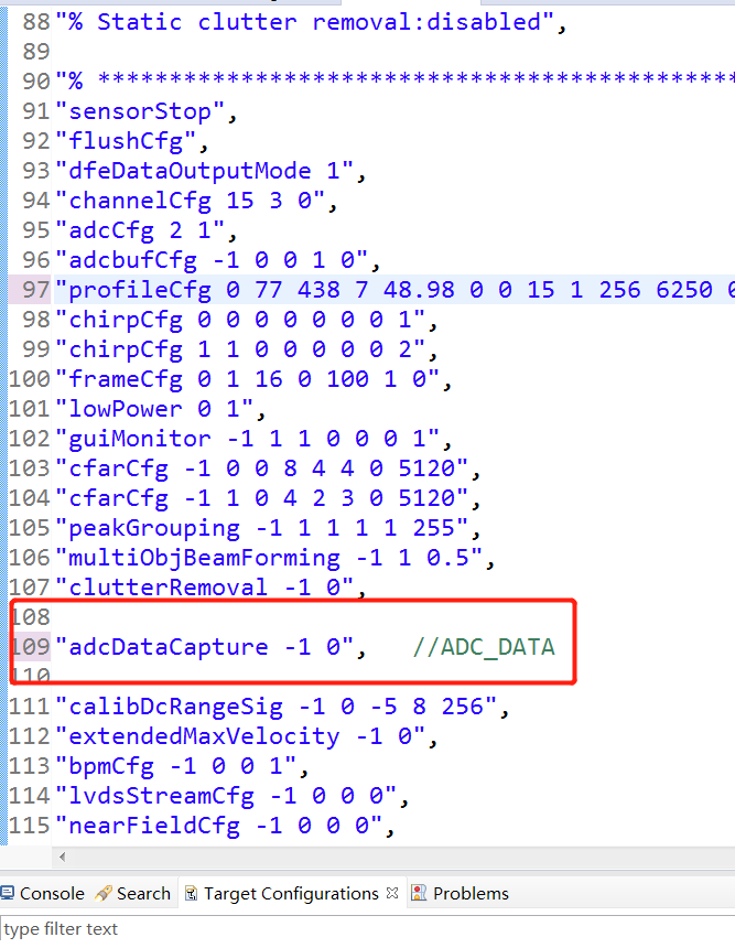

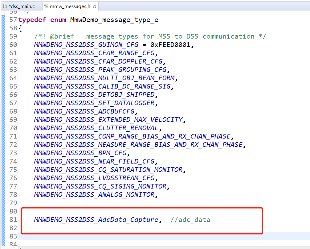

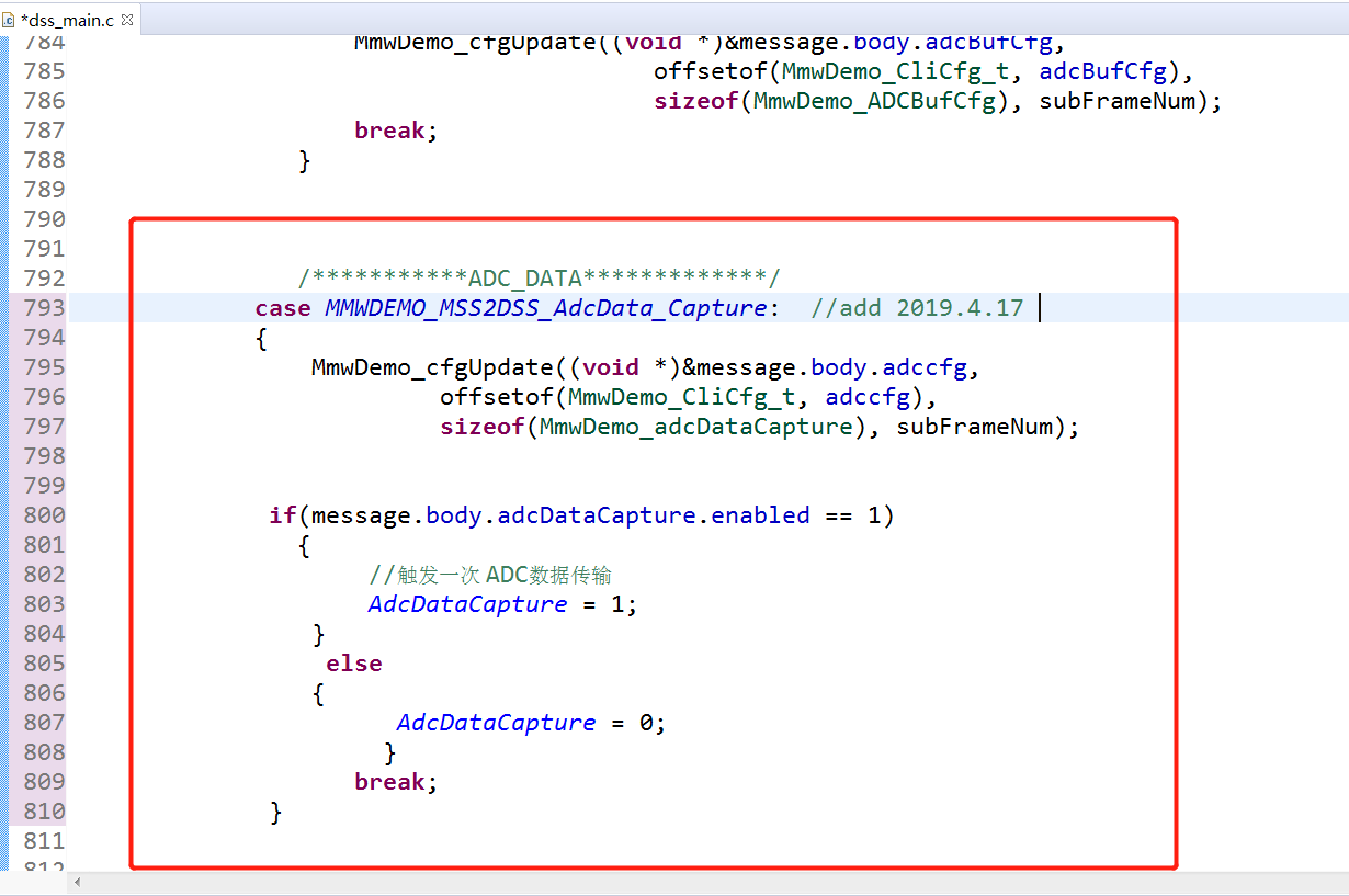

Hello, I have followed the steps you said, but there is still a problem, the mss.main project can run normally, but the dss.main project can not run normally, the result is as shown below. Maybe I missed a certain link, please correct me, thank you
