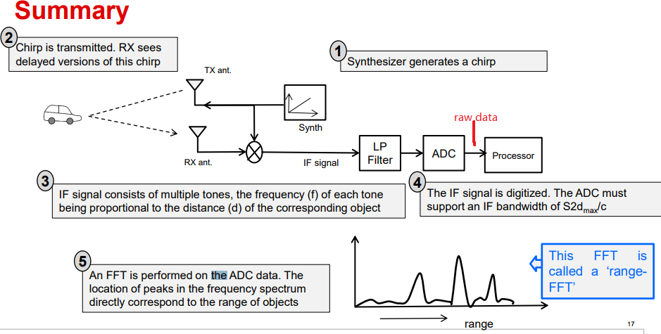

  • Hello, Chloe
    thanks for your reply,
    I am a beginner,  I have seen the video. and I think I got the raw data the red line position
    and I use the readDCA1000 function read the adc_data.bin
    I get the first chrip data (1x256 complex double )as follow:
    and follow the video, maybe I should perform an fft on data, and I can get the range-fft. but get the range proflie is what I mentioned at the beginning.
    Thanks alot for your help
    Does your plot in mmWave studio post proc look different? Can you please send me the 1D FFt amplitude profile from the post proc window. This plot should give range detection. This is the plot you're trying to recreate, correct?
