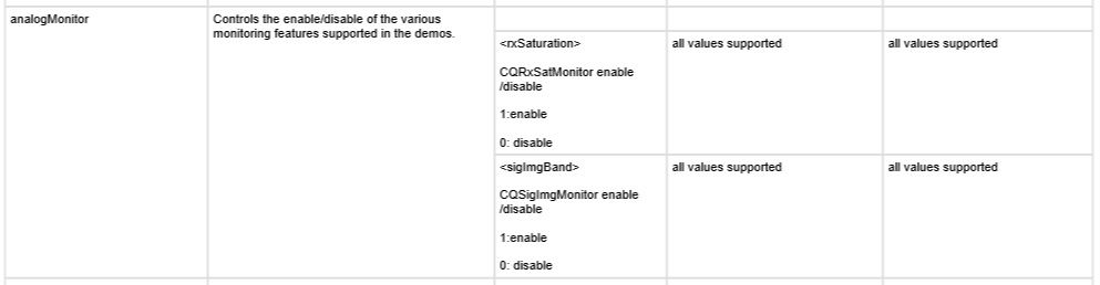

The default value of the analogMonitor in mmwwaveSDK v2.1.0.4 is "analogMonitor 1 1".
What is the actual effect of the analogMonitor command?
Is the setting of "analogMonitor 1 1" better than the setting of "analogMonitor 0 0"?
Also, I can not find the analogMonitor command in mmwaveSDK v3.1.1.2.
What is the reason for canceling this command?
Thanks.

    As described analogMonitor enables some of the monitoring features supported by the device.
    Some of the monitoring functions have changed in the firmware version supported by SDK 3.x
    This could be the reason they are no longer supported.
