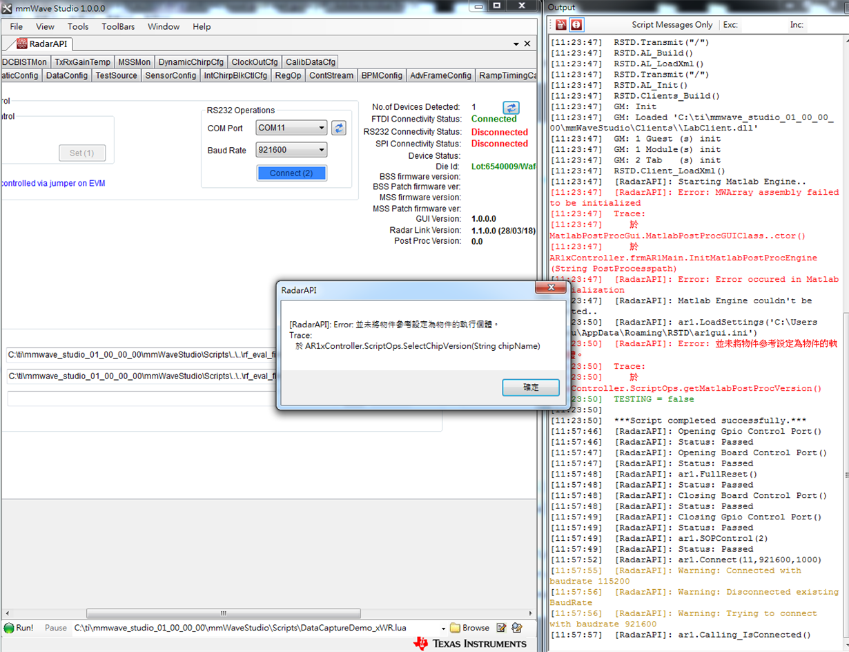

I cannot open the mmwave studio successfully.
I have installed matlab runtime v8.5.1 x32 , but it is still error.
How can I resolve it?

Hello Ian,
Please follow the instructions listed in the mmWave Studio User Guide and make sure you have the 2015a version of Matlab runtime installed. I also recommend downloading the latest version of mmWave studio (2.0). The user guide and latest version of mmWave studio can both be found in the mmWave_Studio folder.
Hope this helps.
