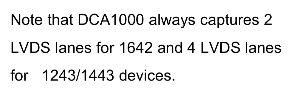

I am now trying to capture raw data using DCA1000+IWR1443 Board.
When I look up to the 'mmWave Sensor Raw Data Capture Using the DCA1000 Board and mmWave Studio" pdf, it shows that:
while when I look at the "mmWave Studio GUI" pdf, it says:
I wanna ask if I want to set 1 Tx Channel and 2 Rx Channel, How many LVDS lanes should I set? it is 4 or it is 2?
  • Hi Jianben,
    You can use up to 4 LVDS lanes with the 1443IWRBoost board, but the only LVDS lanes that should be enabled are the ones corresponding to the enabled Rx channels. So, if you have two Rx channels you should have two LVDS lanes.
    -Chloe
