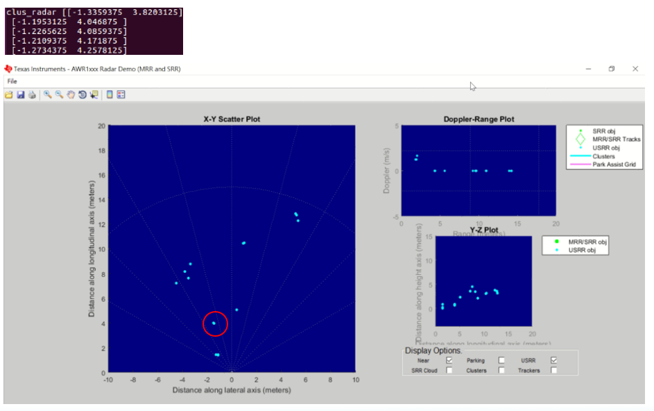

I try to use your mmwave_automotive_toolbox lab07 MRR demo to see the performance of awr1843.
However, when I set a strong reactant at position ( x, y) = (0 m, 4.3 m), the MRR result shows about -1.2 m error on x. (like the image below)

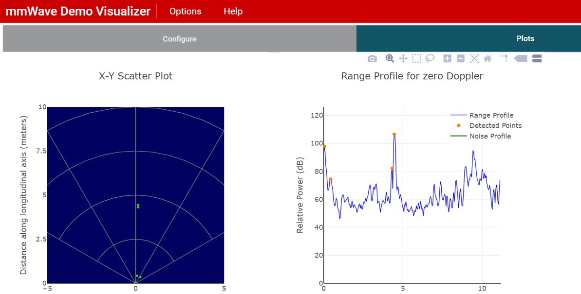

I also use your mmWave visualizer to test either awr1843 board broken or not.
The result of mmWave visualizer is correct, so I think my awr1843 board is working normally.

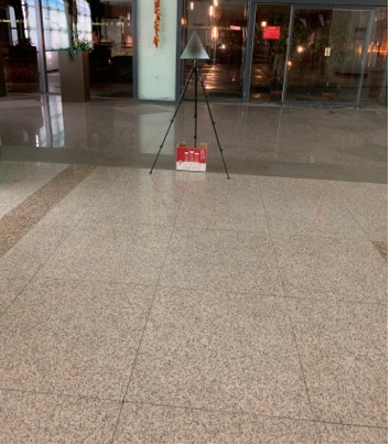

    What do you mean by reactant? Corner reflector?
    -Raghu
    Yes,the corner reflection.
    Thank you/
    It looks to me like either your environment isn't clean . Have you done the same test in any anechoic chamber ? That would give you a cleaner test environment with just the corner reflector as your target.
    Also can you confirm if you are doing any calibration?
    -Raghu
    I also do the other test. I walk around the corner reflection, and the MRR demo result show about -1.2 m  error on the x-axis. ( like the video below)

    On MRR demo, I use the pre-build binary from the mmwave_automotive_toolbox_2_4_7 / lab0007.
    Thank you.
    Sorry for the delay
    Please perform calibration of the antenna
    thank you
