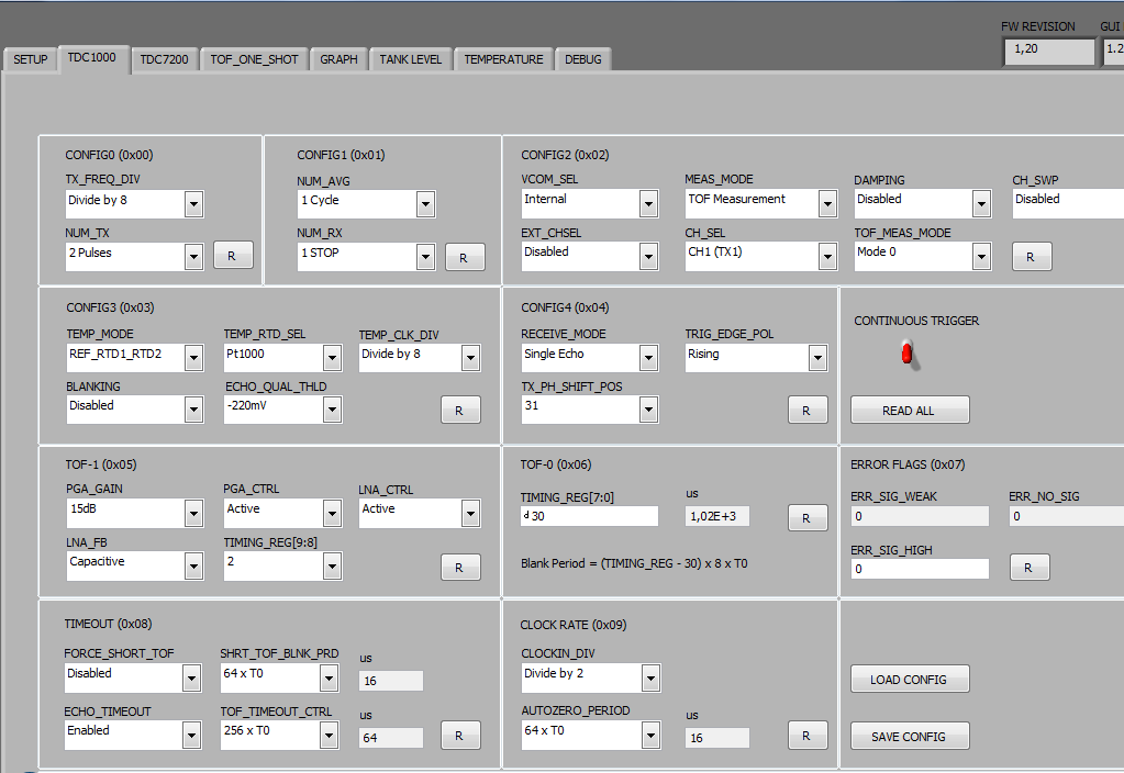

  • I have modified these Settings as follows:
    PGA_GAIN : 15dB
    ECHO_QUAL_THLD : -220mV
    NUM_RX : 1 STOP
    I attach a capture of other configurations from the TDC1000 tab.
    With this configuration, the measuring range is from 3.5cm to 8.5cm
    Take a look at it, please.
    Is there any setting on the TDC7200 tab or on another tab?

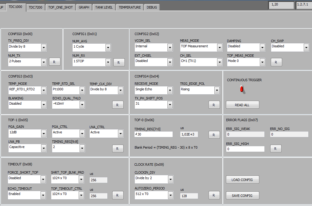

  • With this other configuration, the measuring range is from 12.01cm to more than 28cm
  • Christian,
    The TDC1000-TDC7200EVM measures the ToF of the ultrasonic waves between the time the transducer transmits it and receives it back.
    The TDC1000 receives the return signal and amplifies it to generate the necessary stop pulses. The strength of the return pulse will vary as the medium as well as the distance changes and hence it will be difficult to set a particular gain & VCOM setting and measure a wide range of distance.
    Please let me know if you would just like to know if the a standard gain and VCOM setting can be used to measure the complete distance of 2cm to 60cm ?
    Also in the TDC7200 tab please make sure you match the average cycle & NUM STOP with that of the TDC1000 tab.
