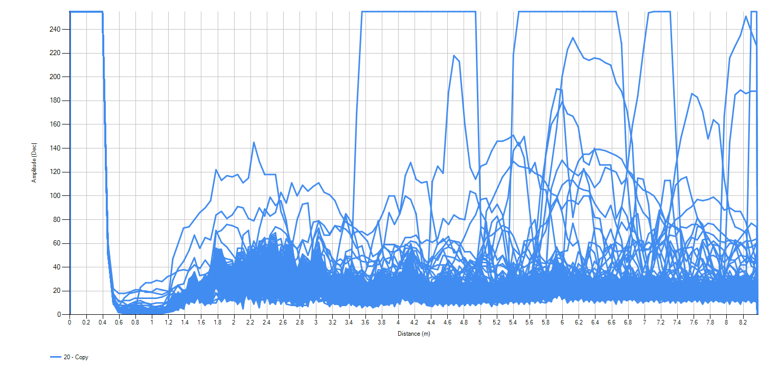

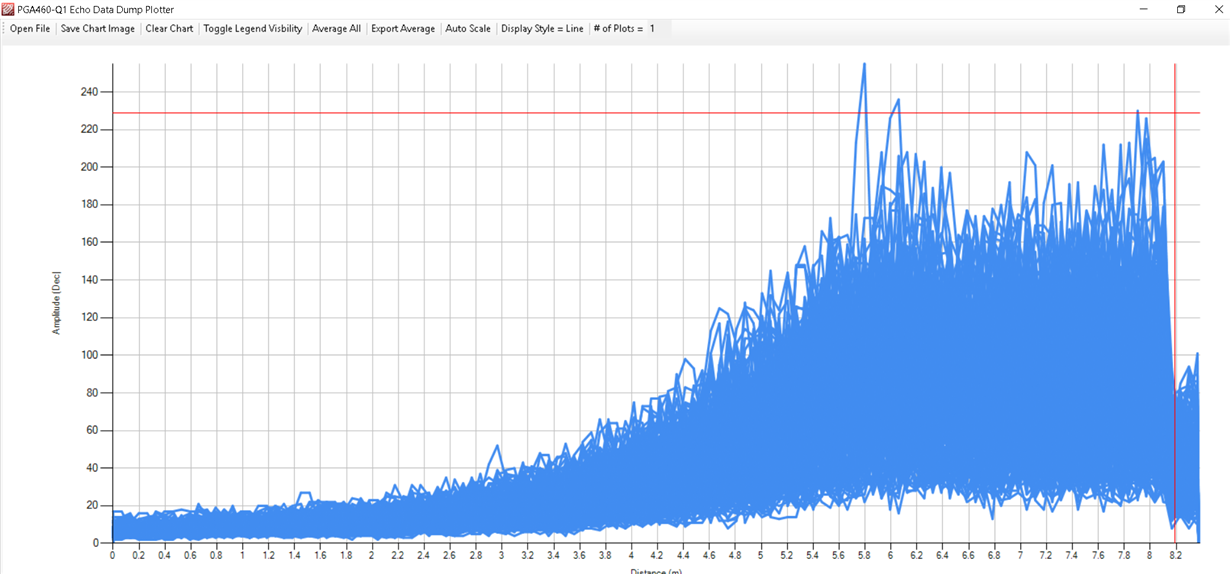

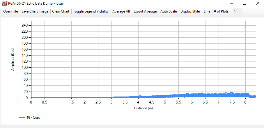

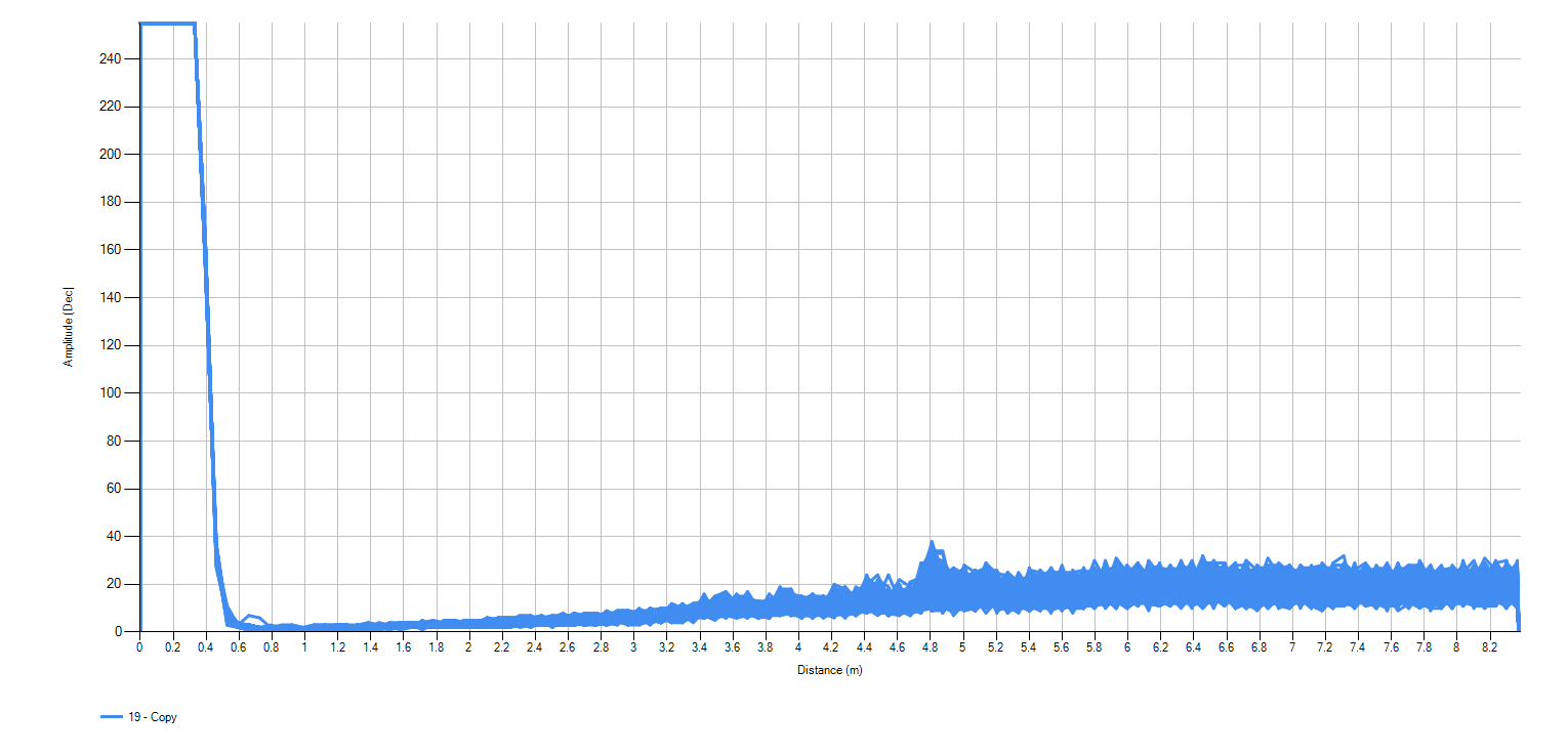

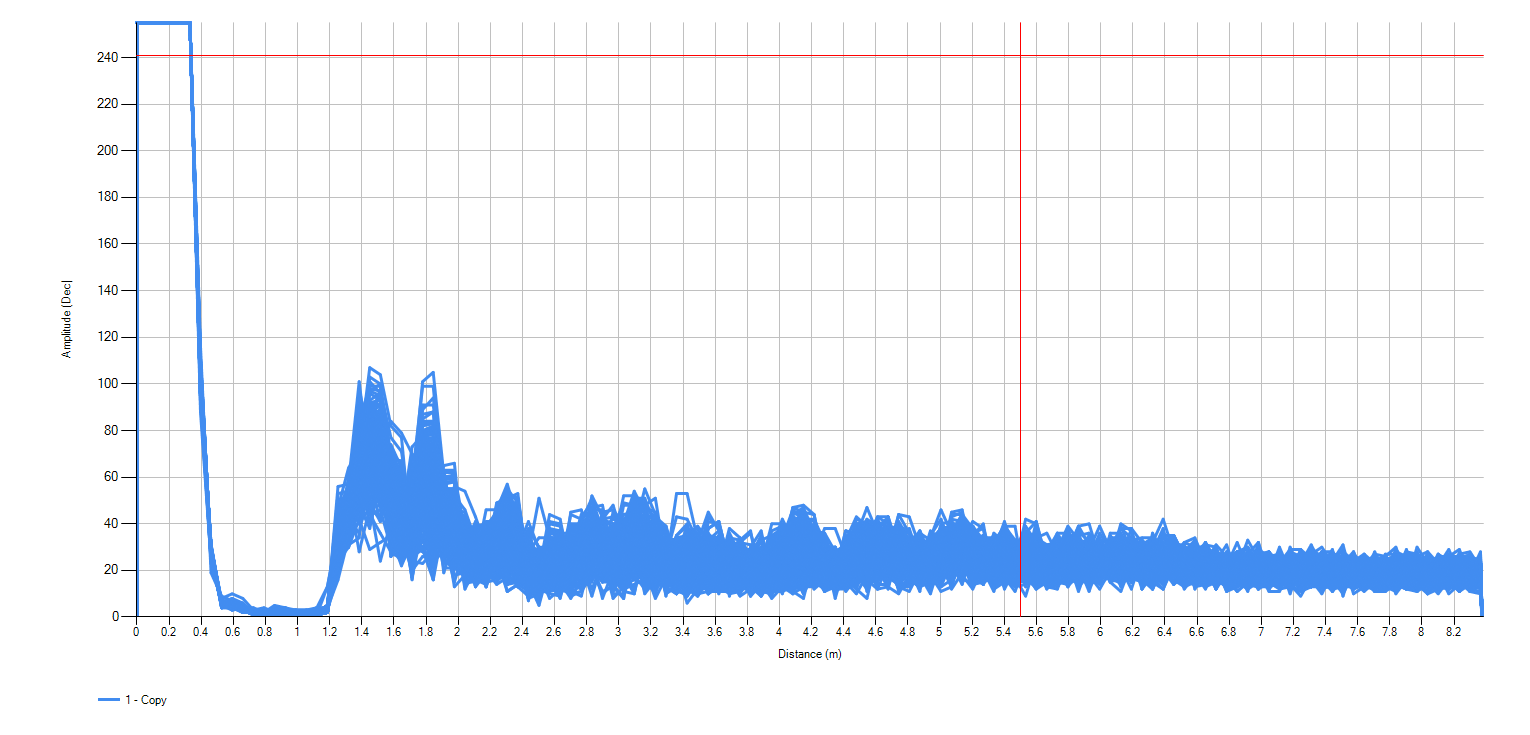

1.) We receive approximately 1 CRC error (in received data) in 100 scans. Could this be connected to the noisy waveform that we receive?
2.) Received waveforms are as follows:

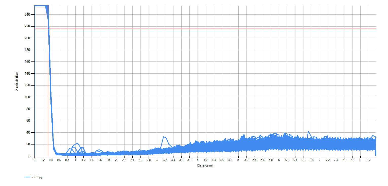

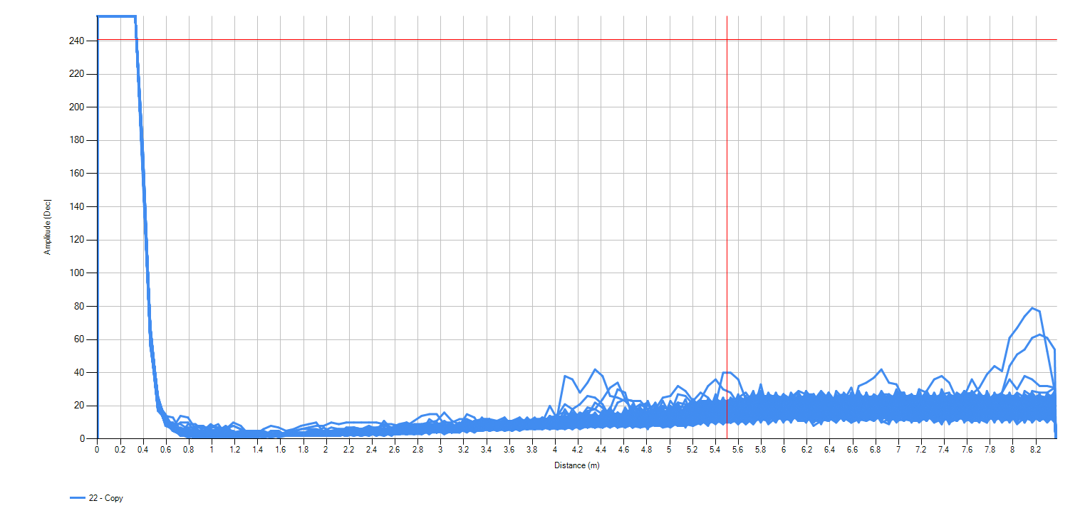

Scan 1: This is an EDD of an empty Burst & Listen scan on P2. The detection at approx 1.5 Meters is the ground below. The system was positioned in an open area with no object around it for at least 15 meters on facing side. There are no sources of noise like motors, machines or other ultrasonic sensors (to the best of our knowledge)
Scan 2: Is an EDD LISTEN Only scan with the XDCR+ connected to GND in the same exact position.
The noise seen in scan 1 makes it difficult for us to set thresholds that will give us reliable detection and eliminate False Triggers.
Any help in eliminating the noise source would be much appreciated.

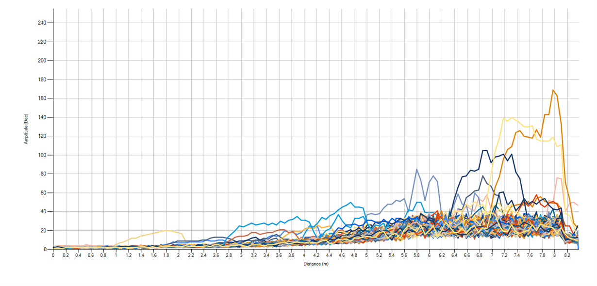

  • Hi Akeem,

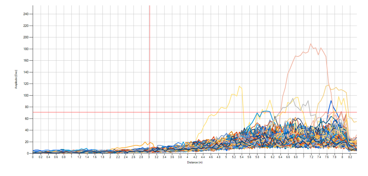

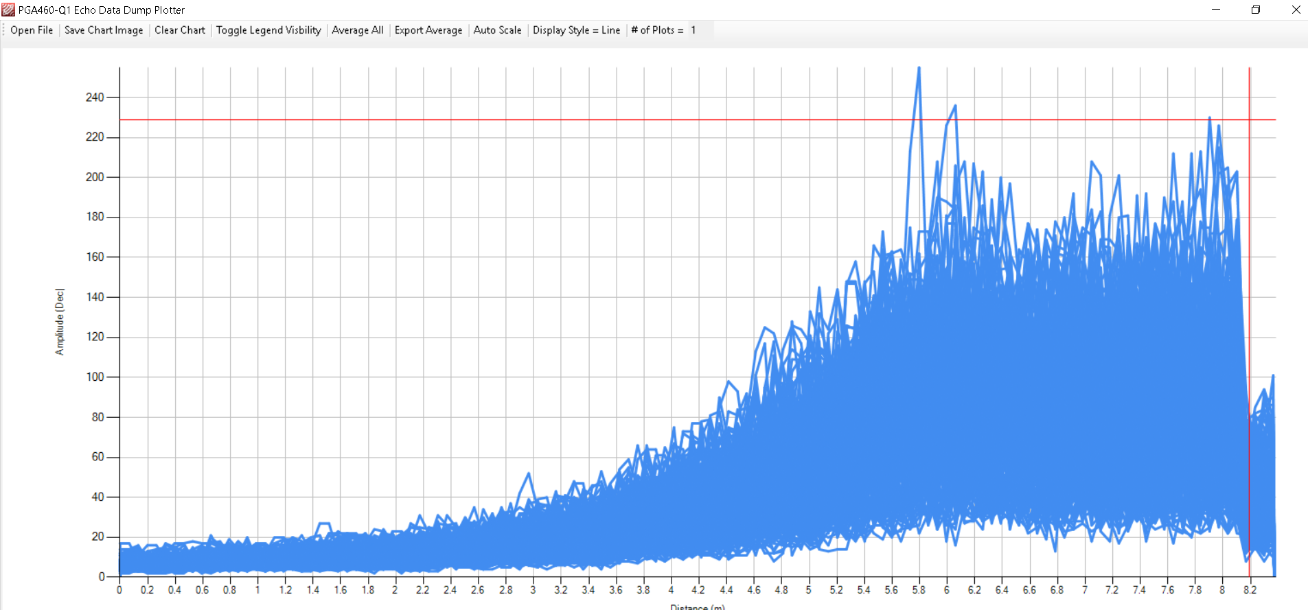

    Following your suggestion, we connected a ground to the Postive terminal of the Transducer (Pin 1 on J12/J14) and run the scan in Listen Only mode with the previous settings.
     The attached plot is for 1536 consecutive Listen Only scans. To add to this, during the period of the scan, the EVK was being powered by the laptop and the laptop was not being charged.

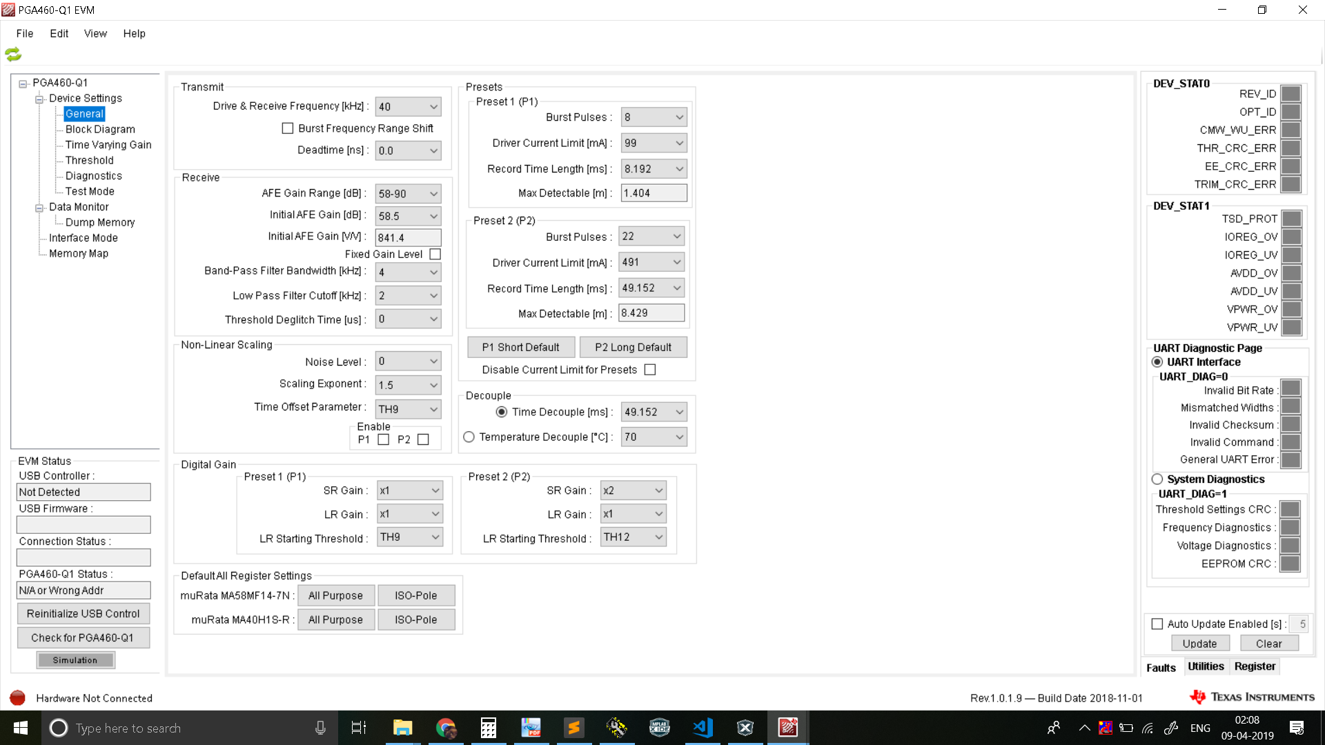

    Attached below is a screenshot of our settings.
    How can we proceed to eliminate the noise that we are seeing on these scans.

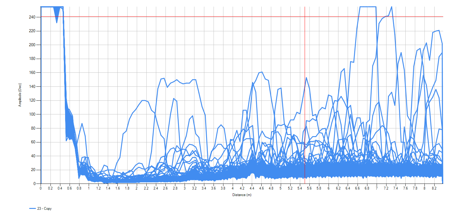

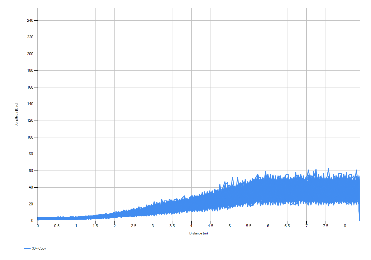

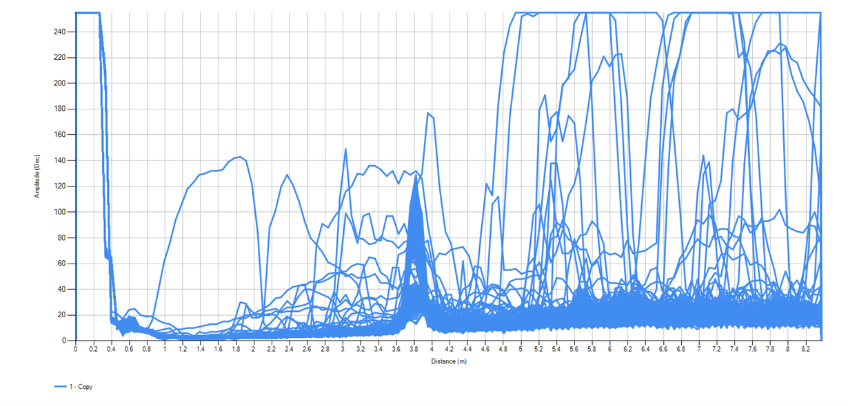

  • HI Akeem,
    The following scans were taken in the spot where we usually test our system.
    The first scan (seen below) is a burst & listen scan with foam taped over the transducer.
    The second scan (seen below) is a burst & listen scan without the foam.
    During both the scans, there was no object (other than the foam in the 1st scan) blocking the field of view of the transducer. Both scans were run with same pulse, current & DSP settings.
    Furthermore, we have observed that the scans that we run during the evening (after sunset)  register more noise. As an example,
    the below scan was taken at 18:22, before sunset. Same location as the previous scans, same settings (burst + listen with an empty field)
    The next scan was taken 30 minutes after sunset. Same location, same settings.
    Not sure what to make of these observations, hoping you can shed some light on the same.

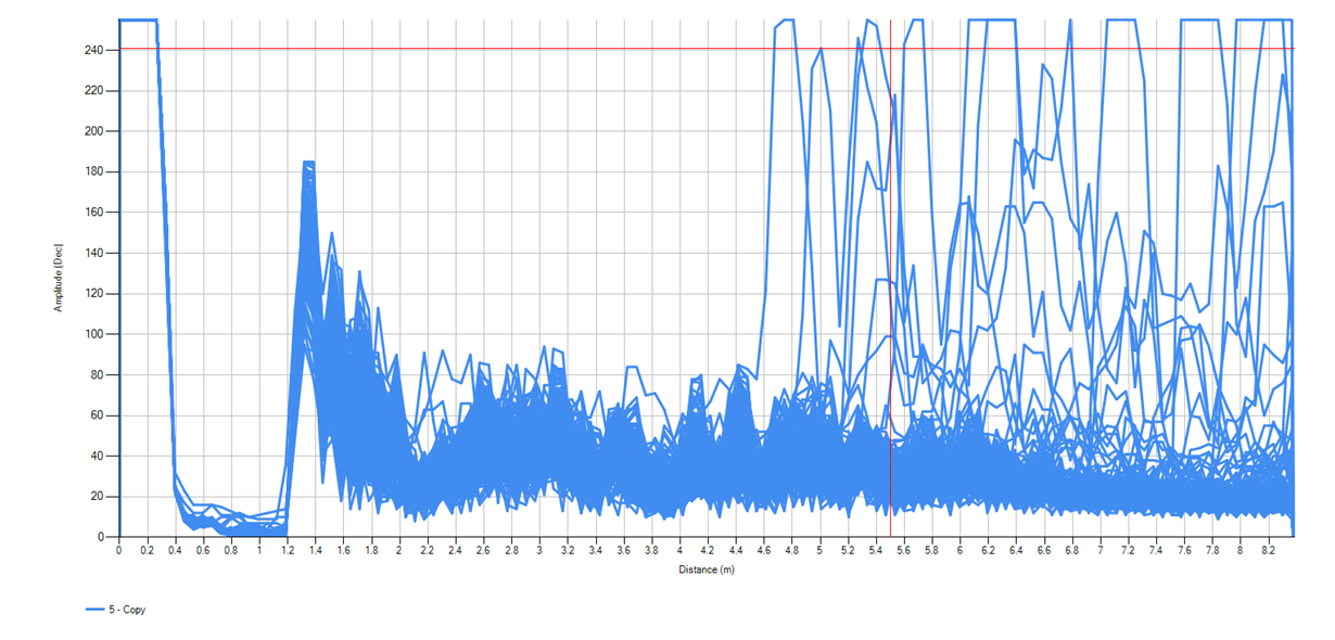

  • Hi Akeem,
    All the previous scans that we shared were done in our office parking lot, which is an open empty area, except for a few trees in the distance.
    Yesterday we decided to get scans at a different location. We maintained same settings and hardware configuration as the previous scans.
    The following scans were done after sunset.
    SCAN 1
    SCAN 2
    Scan 1 and Scan 2 were done at a different location whereas the scan attached below (Scan 3) was done in our empty parking lot.
    SCAN 3
    To the best of our knowledge, there aren't any ultrasonic aggressors in the area. Most of the offices are closed at the time we are running these tests.
    We also ran scans with shielding in place for the entire system and wires, but got similar noisy results.
    Please Advice.

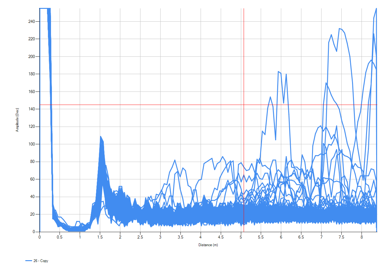

  • Hi Akeem,
    While testing our system in the evening, we saw Bats flying near by. We believe them to be the cause of the noisy EDD plots.
    Can you confirm that this is a plausible explanation? And if so then what can we do to filter out that kind of noise?
    Yash Darad
  • Hi Yash,
    Assuming the bats are the cause of the ambient noise, there is no means of filtering out their signals if in-band to the transducer frequency.
    Based on a quick web search, I found that bat cries range between 20-80 kHz over a 50 kHz window for 1 ms. You may need to consider using a higher frequency transducer to prove the bats are at fault or not.
