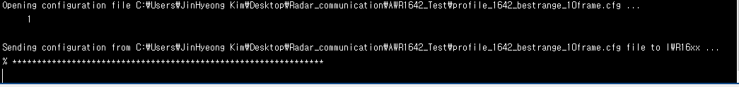

  • Currently I do not use CCS. I am just using AWR1642 and DCA1000EVM and send configuration command thorugh UART using MATLAB function. So I could not find any error message from radar.
    But the reason why i said 'stop' is that when i try to send lvds data by pushing 'Capture start' button on DCA1000EVM, it tries to send message few seconds and stop blinking and the LED 'lvds_path_err' turns on.
    Also when I resend configuration message through UART, It does not receive that message.
    Below is the MATLAB command window when i re-send configuration file and radar does not receive it.
    And below is the configuration file that i used. but when i use other configuration file (best range and 64 range bins and 8 channels and 16 doppler bins) this problem does not occur.

  • In order to understand what is going on, you need to see the error message if any reported by the code. So either modify your Matlab to printout any received UART message or (preferable option) load and run the code using CCS so you can see the message on the console. I assume you had to modify the code anyway for all these changes, so if you are not using CCS you must have flashed the code, during development work it is preferable to use CCS so you can easily debug the application.
