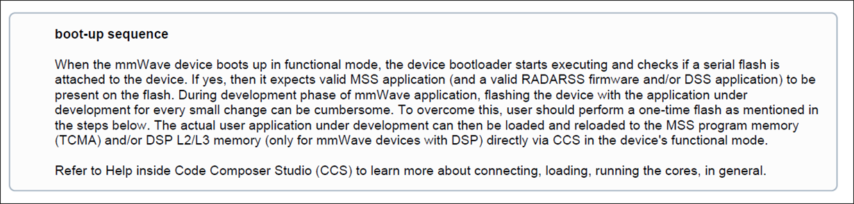

  • Hi Ray,
    Thanks for your patience. Please find my responses as noted below:
    [Ray]: "Please look at the boot sequence in SWRA563 Bootloader Flow.  Look at Figure 4. If there is no valid flash image (a virgin Flash device) and the part is in "Functional Mode", the Bootloader will take the "No" path and sit and wait for commands. The bootloader will never get to the ROM Eclipse step because it is waiting for a command. See the rectangle in the sequence: "Set up SPI. Generate a HostIRQ to indicate bootup completion and await commands."
    [NS]: The part highlighted in red is not correct. In functional mode, If a JEDEC compliant flash is connected, the bootloader will get a valid SFDP response (as noted in section 2.1.1), and will move on with the Yes branch (Flash present). In this case the bootloader expects a valid image to be available in flash otherwise it falls into an error condition which is what happened on your board with a Virgin flash device. In other words, not having a Flash connected is different than having one connected but leaving it empty which is an invalid condition and causes the bootloader to fail.
    This is noted in the MMWAVE-SDK user guide as shown below and the SDK provides a valid image called ccsdebug.bin under C:\ti\mmwave_sdk_02_01_00_04\packages\ti\utils\ccsdebug. This image includes the RadarSS firmware and a very small MSS code (essentially some initialization and then a never ending while loop). The main purpose of this image is to keep the bootloader happy so that it eclipses the ROM at the end of successful execution. You can then connect the debugger and load your application without having to re-build it with different load address.
    However, your feedback is very valuable and I'm checking with our team if this information is already included in an existing app note (other than the MMWAVE-SDK user guide), otherwise we'll identify the correct document to include this information so that it is highlighted in a better way.
    Please get back if you have more questions on this topic.
    -Nitin
