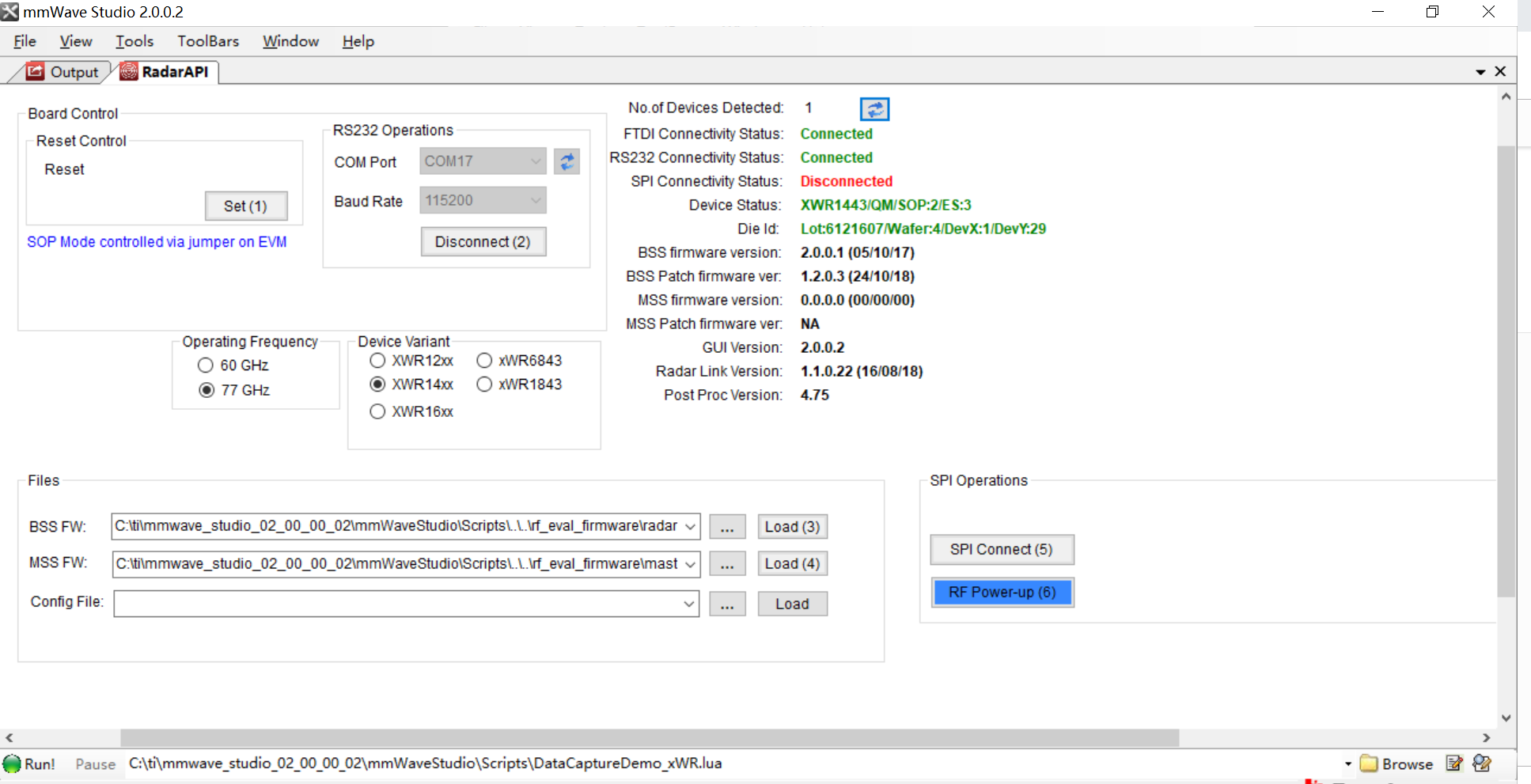

Hi, I try to set up DCA1000EVM with IWR1443boot, and I follow the pdf 'mmwave_sensor_raw_data_capture_using_dca1000' in
training.ti.com/.../mmwave_sensor_raw_data_capture_using_dca1000_v02.pdf
but when i hit button ' SPI Connect(5)' in the software 'mmWave Studio',the 'SPI Connectivity Status' shows 'Disconected'.
the SOP0 and SOP1 are closed and SOP2 is opened.
the setting and detail output is shown as below:
So, what could be the reasons , Thank you.
Hi Banitan,
Please erase the flash using uniflash and try again. You will need to change the SOP settings for flash mode in order to erase. Power cycle every time you change the SOP settings. Be sure to change back to DCA mode before running mmWave studio.
