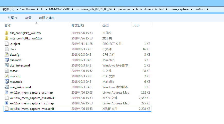

    Thanks for your reply. You said that there is no capture demo in SDK 2.1, but I found the similar one in the folder "mmwave_sdk_02_01_00_04\packages\ti\drivers\test\mem_capture\xwr16xx". Then I followed the steps that provided in chapter 4.5 of SDK_user guide, and I got the new compiled xwr16xx_mem_capture_dss.xe674 and xwr16xx_mem_capture_mss.xer4f which would be used in CCS to capture raw data.Just like this.
    And my EVM version is 2.0, is it useful that port the Capture demo from SDK 1.0 to SDK 2.1?
    Thank you
    Jay
  • Yes,
    You are right. In SDK 2.0 the full capture demo is no longer supported. However a unit test was provided in the drivers folder.
    You can definitely use that with SDK 2.0
    Thank you
    Cesar
