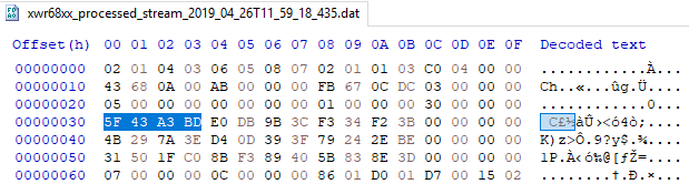

I'm trying to parse the OOB Demo .dat file and I'm having this problem where all my coordinates (x, y and z) values are zeros and that's because of the huge value of xyzQFormat, I tried recording the .dat multiple times and used different PCs but it's always the same value 48547. Same thing with the # Detected Objects value (in the descriptor section) which always gives a value of 17247. As you can see in the photo below, I'm highlighting the # Detected Object and xyzQFormat.
My understand is that the equation to calculate a coordinate in meter would be; x in meter = x / (2 ^xyzQFormat), please correct me if I'm wrong. If this equation is correct then it impossible to get a reasonable x value when xyzQFormat is this huge, right?
Please let me know if these two values make sense.

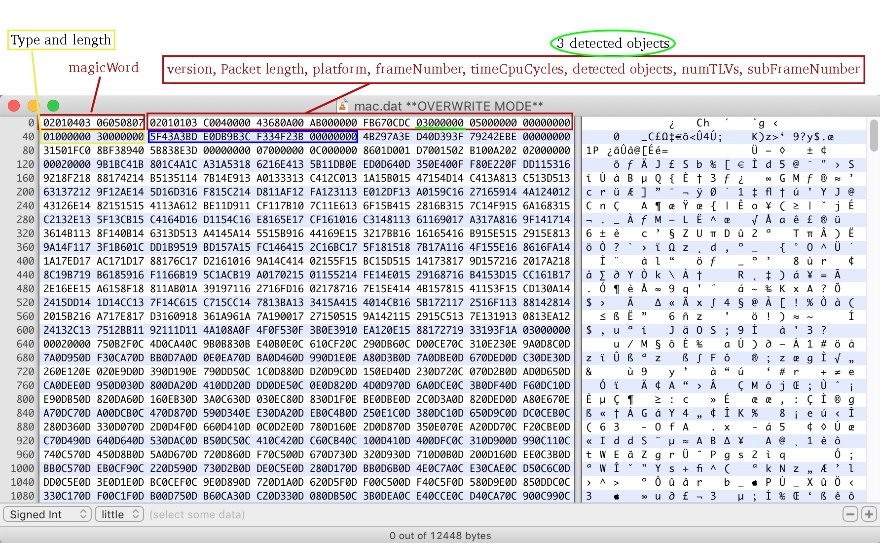

    I got that Qformat point when Nitin replied to me earlier, but thanks for mentioning that. Anyway, the packet header structure is very clear and I know that it is 40 bytes in size, then we have the TLV header (which contains Type and Length) with a size of 8 bytes. To me, it gets confusing from this point. If you look at the screenshot below, the yellow rectangle shows the Type and Length (Type =1, Length= 30), Type 1 refers to MSG_DETECTED_POINTS therefore it contains (x, y, z and velocity values). Now if you look at the blue rectangle down there, those values don't make sense, and they keep repeating every time I recorded data. Or am I not following the structure correctly?

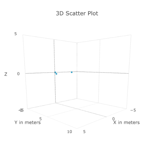

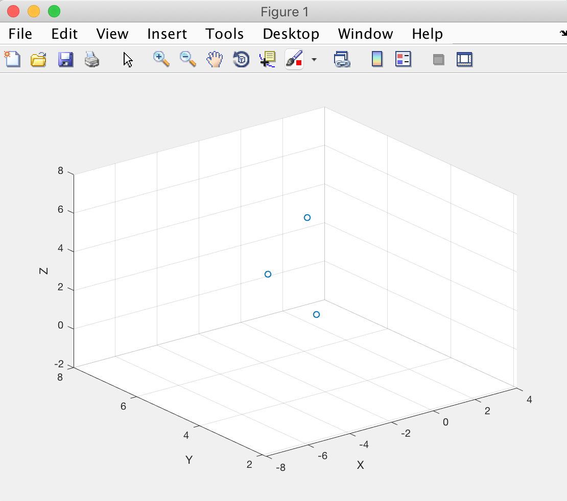

    So every time I use MATLAB to create a 3D Scatter plot and compare my results with the OBB Demo 3D Scatter plot they never match, as shown below. One last thing is that I always get the same x value for the first detected point (5F43A3BD).

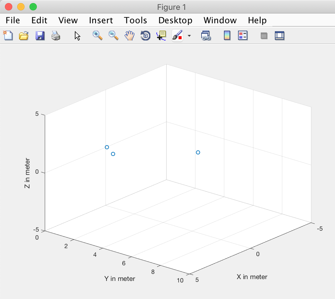

  • Your data and plots are not consistent. You show for example x = -7.97 for the first point but I don't see it in either plot. Also, how did you parse the hex number of x = -7.97? The hex to float for the hex value corresponding to x is -0.079 meters so it seems you quoted in terms of cm, not m? The 3D scatter plot shows axes in meters but Figure 1 does not show any units. Please clarify your response.
  • You are right! I didn't convert it correctly, it makes more sense now. The first 2 points look identical to the OBB Demo scatter.
    Point 1= (x=-0.0797, y=0.019, z=0.007);
    Point 2= (x=0.244, y=0.722, z=-0.17);
    Point 3= (x=-2.48, y=4.31, z=0.069);
