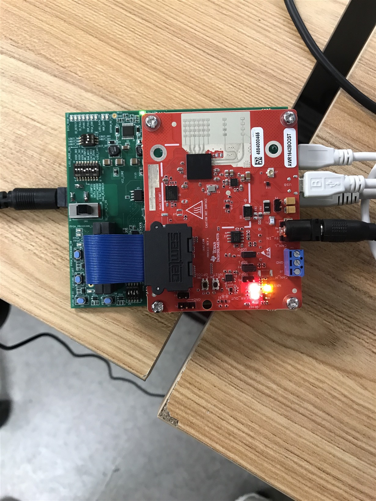

IWR6843ISK-ODS: MSS FW loading failed in MMWaveStudio while using DCA1000 + IWR6843
Part Number: IWR6843ISK-ODS
Other Parts Discussed in Thread: IWR6843
i try to setup DCA1000 with IWR6843 thru MMWave studio 2.0, the connection to board is OK and able to load BSS FW on to the board successfully. But, when i try to load  xwr68xx_masterss.bin onto the board, it's stuck as below screenshot. Please advise, thanks!
