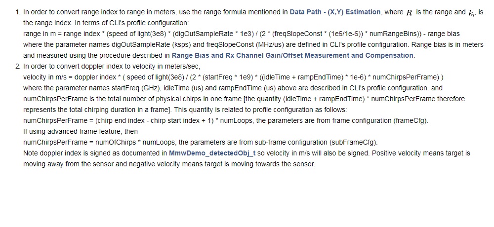

I want to calculate angle from the hex data i am getting on AR_MSS_LOGGER pin.
Like in the screen shot below i can calculate distance and velocity.I need this type of equation for an angle and the certain place like i am getting data for distance and velocity in incoming data which i am getting on AR_MSS_LOGGER pin.

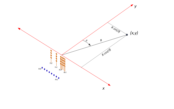

You can find the related documentation at doxygen files below. Search for "(X,Y) Estimation". The plot is attached below. Theta is the azimuth angle.
file:///C:/ti/mmwave_sdk_02_01_00_04/packages/ti/demo/xwr16xx/mmw/docs/doxygen/html/index.html
