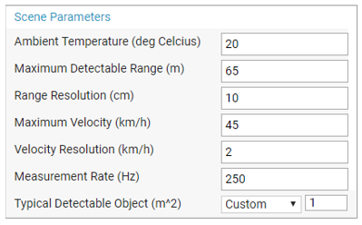

For the AWR1843.  In this application, I have 4 of these devices in the system.  The application does not have a specific more aggressive requirement for angular resolution, but I have the 1243 device as a placeholder.
1. Can you bypass the ADC and put the I and Q data directly into the LVDS bus to send to an external device?
2. From the mmWaveEstimator – can someone elaborate on the term “ Measurement Rate (Hz)” ?  I have been assuming frame-rate to position this for a display refresh rate.
Thanks!
Errol
    1. Yes, this is possible. System details would have to be discussed. The LVDS cable has a limited length (few centimeters). The LVDS would have to be converted to another format (CSI2, Ethernet...) for longer length.
    We usually recommend using the DCA1000 capture card to capture raw data.
    2. Measurement Rate refers to the frame rate. This defines the periodicity of the frame. For example if the application requires to have a measurement 10 times/second (Hz), then the frame time should be programmed to be 100ms
    Thank you
    Cesar
