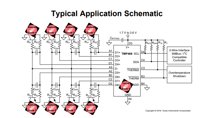

1) If using a NPN diode connection as shown in Fig 1, does the  TMP468 provides/outputs constant current source on these pins (D1+ through D8+)?
2) is that more accurate to use two NPN transistors connected in series with their respective base and collectors short-circuited?  see below drawing, for example
