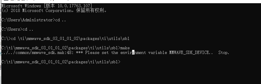

  • 嗨,
     感谢您的帮助,但是当我使用“make”时,会出现下图中显示的一些错误。还需要更改其他配置吗?
    Please follow mmwave SDK user guide (under docs directory) where it is explained, how to build any application of SDK.
    Jitendra
