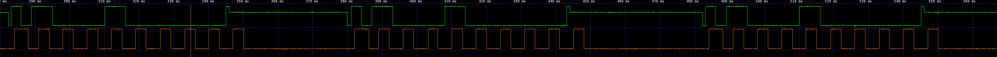

I'm experiencing a strange behavior I can't explain. I have a product that has an LM73 in it. I communicate with it using an FTDI USB device on which I bit-bang the I2C/SMBus interface. When polling the device I always read the status/control register to insure it has the resolution setting I want to use.
On my test bench this works great. I can write the register address, do my repeated start and read the register.

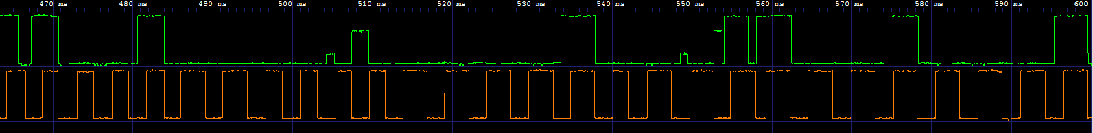

When I move my unit into the temperature chamber I experience a strange behavior. If I address the LM73 for a read, it ACK's and provides the temperature data as the pointer register is 0 at startup. If I address the LM73 for a write however, it NACK's the address.
I used a scope to capture the communication waveforms to see if I could see the issue. It made me realize I was mistakenly using a 5V controller on my bench instead of the 3.3V I'm powering the LM73 with. Because of this I went ahead and tried the 5V cable in the chamber, hence why all these use 5V(Also helps clarify that the LM73 is pulling the line high, not the controller by mistake).
Here is the successful read of the control/status from the bench (Top - SDA, Bottom - SCL):

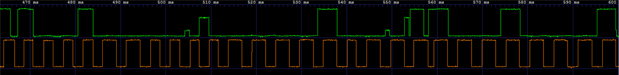

And the failed one from the chamber (it tries a couple more times after that):

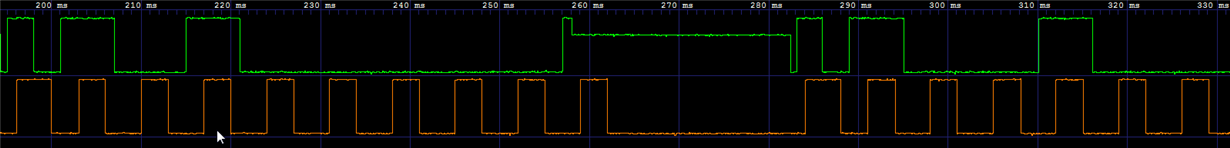

And just a quick peek at it working for a read in the chamber (from later in the above capture after it gave up on the control/status byte)
This strange behavior of ACKing a read but not a write has me stumped. If it didn't work at all then I would know it's a connection, voltage drop (the communication wires are much longer in the chamber) or timing issue (the chamber computer does the bit-bang slower as you can see above) but if it were any of those a read wouldn't work either. Does anyone have any insight on what might be happening?
  • Dear Joseph -
    From what i can see on your captures -
    the first one looks like the address of the device (from a software perspective) is a 0x48h, as I can clearly see the start condition, followed by 10010000b, which equates to a 0x90, which is correct if the 7 bit device address is 1001000 (0x48h), using an LM73-0 would be floating the address pin) and you are doing a write.
    Next I see in the 'good' sequence what appears to be some attempt of using the SDA line, but the clock appears low, so I not thinking this does anything. then a 0000 0100 (0x04h) then a 0110 0100 (0x64h) - is that what you see/intend to send, too?
    in the second sequence, I see the start, then a 101000000, which is an 0xC0, so not a correct address, then you miss several clock cycles - then another start followed by what looks to be 100100, then the image cuts off - perhaps the FTDI device is temperature sensitive - not sure - it does not look very stable - can you check that our or consider actually using I2C module inside an MCU? (not sure what your exact considerations or application requirements might be - so just some thoughts for you here)
    in the third sequence, I can see start condition again, followed by 10010001 (0x91), which is a read, followed by a 00010100 (this would be a 0x14), then 10....?
    I think the problem may lie with your I2C engine? is it possible you exposed it to the wrong voltage? did you see the notes 1 and 2 on page 2 here:

  • Josh Wyatt said:
    Dear Joseph -
    Yes that is correct, is an LM73-0 with the a floating address pin.
    The first two parts are correct, but after the 0x04h (the control/status byte pointer address) it is not 0x64, but a repeated start, followed by the device address again (with with the R/W bit high this time). After that the LM73 transmits the control/status byte as expected.
    As for the what youre talking about in the SDA line I'm not sure which of a few things you're referring to. In order to detect an ACK, I set the SDA line high (at least from a software perspective) and change the direction of the pin. This results in the minor uptick to 1V you see before each ACK clock pulse. After the device address ACK the pin does go high. I don't know why this happens, but I do know it is not the controller doing this. You can tell because it goes up only to the 3.3V level, if it were the controller it would be 5V.  I assume it's the LM73 since I don't know why other devices would be manipulating the line but I can't be sure. After the device ACK's the the 0x04 something on the bus (again I assume the LM73) drives the line to 3.3V, then I change the direction of SDA to output which drives it low very briefly before I set it high to prepare for the repeated start.
    Ops I made a mistake and scrolled back one sequency too far when taking my screen grab. This is from my utility that polls all the hardware continuously. It is trying to talk to another device (something from another model which isn't present in this system). For the LM73 it tries write three times and then gives up, does a bus reset and then reads the device to get the temperature (and assuming the lowest resolution). What you see at the end of the screen grab I did attach is the first attempt to talk to the device. Here is the sequence I meant to capture (I went ahead and grabbed all three attempts this time):
    Between each attempt I wait a bit before starting the next attempt. When the bus is inactive the clock does not pulse.
    You've forgotten the ACK pulse, it's a 10010001 (0x91), ACK (from LM73), 00101001 (0x29 - driven by the LM73 because it's at 3.3V), ACK. As the LM73 has not accepted any write the pointer register is 0 so this is the first byte of the the temperature data. The second byte transmits the same as the first so I didn't feel the need to include it in my capture. The first byte here translates to 42C which is right for this application.
    www.ftdichip.com/.../DS_C232HM_MPSSE_CABLE.PDF
    It seems unlikely. We have used this system for years to communicate with dozens of devices (digital potentiometers, EEPROMs, DACs, ADCs and other temperature sensors). It's been in place longer than FTDI has offered their MPSSE style cables that have I2C/SMB functionality built in (hence why I'm bit-banging it using a TTL-232RG-VSW3V3-WE/TTL-232RG-VSW5V-WE). We have several different test systems that use this hardware and software so changing the communication hardware would be a major hassle. We've investigated switching to the MPSSE style cables several times but found the cost of adapting our systems to be too high to warrant it unless absolutely necessary.
    While I can't rule out that this device simply can't do the job I can confirm it is not a faulty FTDI cable as we have them stocked and I have tried multiple.

    Looking back at the waveform I sent before I notice that the failed attempt to talk to the device not present never finished the attempt with a stop. I don't think it's likely but that is something to investigate that I'll tinker with this afternoon.

  • Hello Joseph,
    Looking at the screen capture, there is one thing that is a bit concerning. In the read transaction as seen in the chamber, the High from the LM73 does not go up all the way to the supply. It seems that there is a active low driver on the bus, which the LM73 is trying to work against.
    1, Can you isolate the read to LM73 only and not to any other device on the bus?
    2. Can you use a scope with voltage units, so that we can better understand the issue?
    3. To clarify, the LM73 is working on a 5V supply with a pull up of10 K on the SMBCLK and SMBDAT to 5V as well?

    The LM73 will not go all the way to 5V as it is powered on 3.3V. My FTDI device for those captures was a 5V FTDI device. I was using a 3.3V device in the chamber to match the supply, but realized I had been using the 5V device on the bench by mistake and switched the device on the chamber to see if that would resolve the issue.

    The scope recorded voltage units, the software I used to view the waveforms (GTKWave) does not show them on the plot. I just tried to attach the VCD file showing the waveform but apparently the file type is not accepted. So I've just changed the extension to txt (VCD is plaintext anyway) so if you want to open it with GTKWave you'll need to change it back. I can attach more of these for various things I've tried if it would be helpful.
